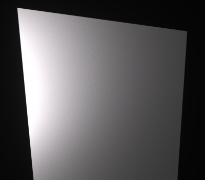

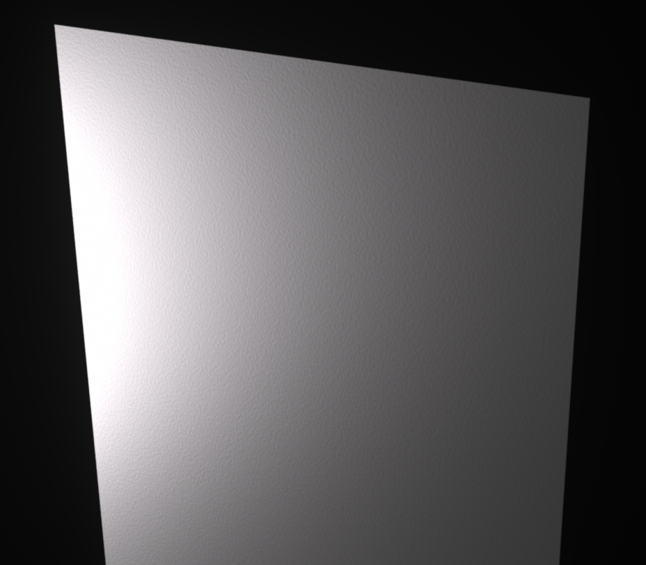

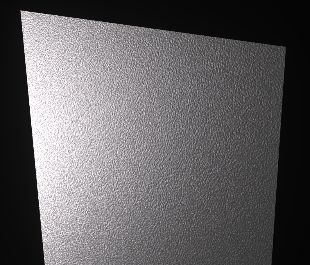

When I render a plane with a noise shader as a bump, I have the live view looking significantly different from my final renders.
Live view whilst working:
Final renders:

Hey Mash, I found the issue: In the Octane Render Settings the parameter "Geometry Control" is set to "Auto Detect".
If you revert this to the default "All Objects Movable" it looks correct again. Obviously should not happen.
I marked this to be fixed for the next release, sorry about the inconveniences.
