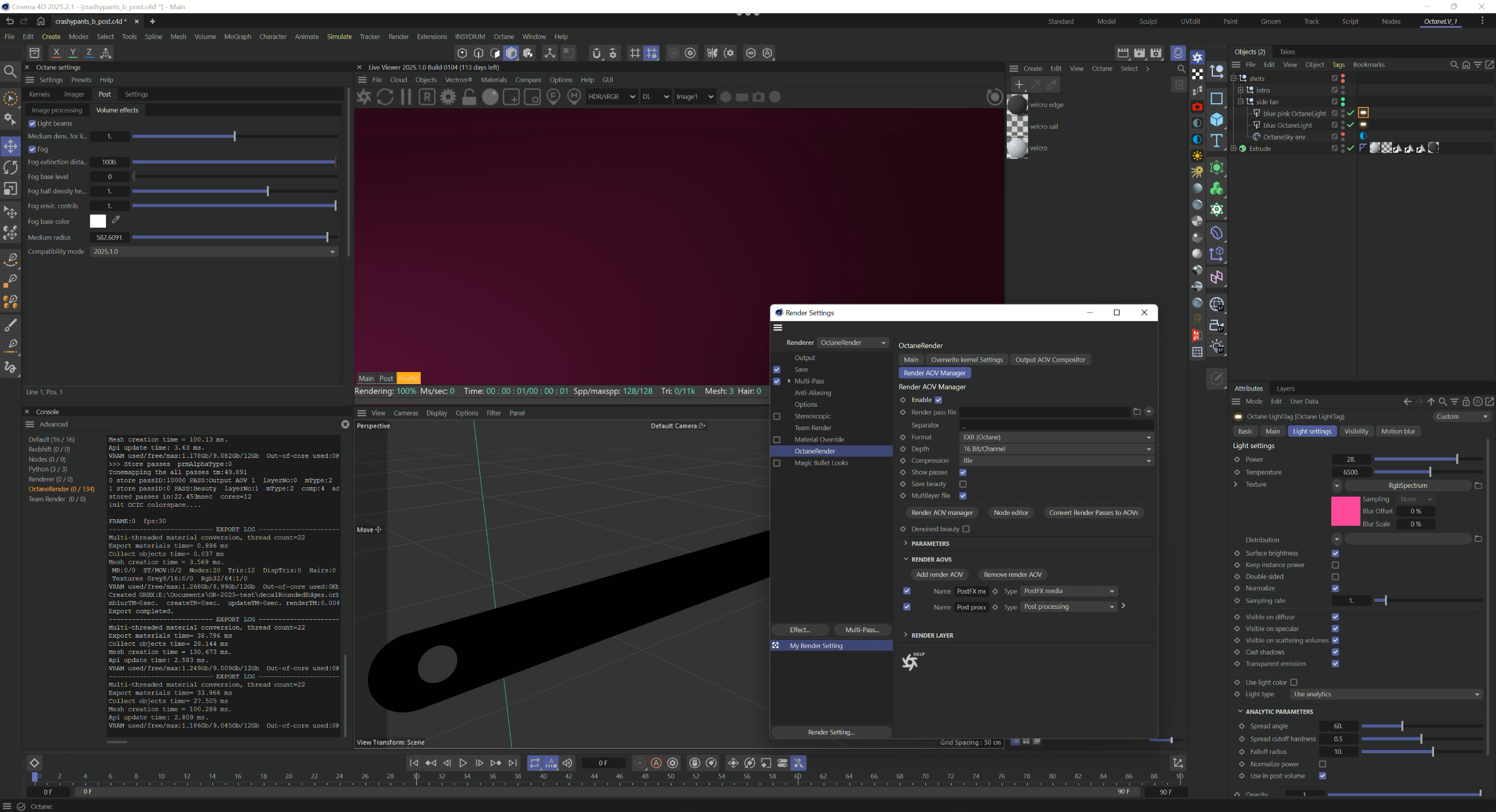

Im 99% certain this crash is due to the use of analytic lights creating post volume effects. I suspect your fresh c4d file has reset the Post tab in the octane render settings.
If I copy paste this scene to a new c4d file it works, but once I enable the post glows and specifically 'Light Beams' in the Volume effects tab, it crashes again.
Weird, I have no issues with Post Effect/Volume, even if I enable the PostFX AOV in Render Settings:
