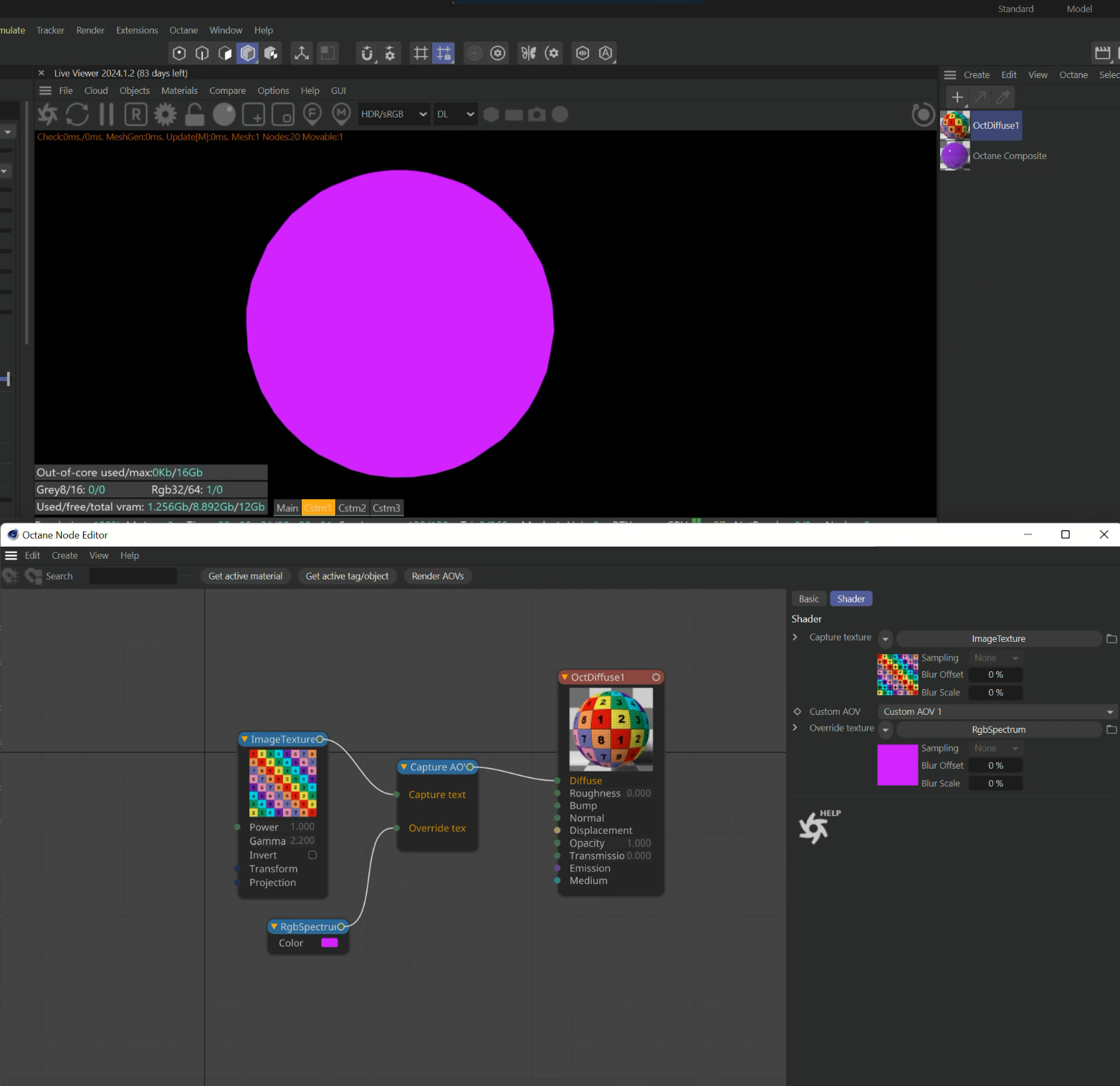

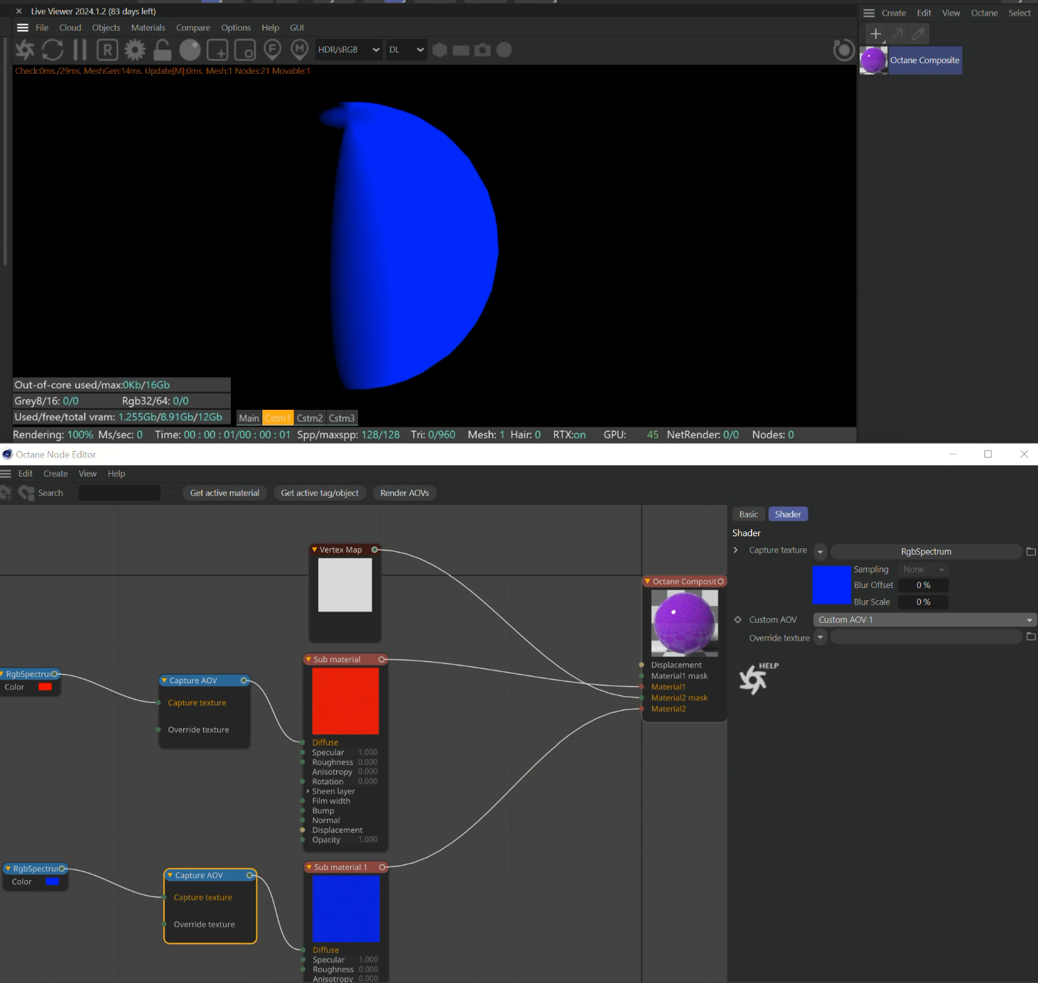

1) Hello, I am attaching the test scene, please go straight into material editor to see the Sub material1 and its Capture AOV node which I do have problem with... There is Custom AOV specified as number 1 and I feel something like it is very similar as I have been having this issue from time to time with some renderers as Redshift and Octane as well, that number 1 is optional to choose from but never actually do nothing so what is the magis causing this please?

2) And also I have a question how to render just black and white like matte for the mix material custom AOV? Do I need RGB Spectrum node for that override texture input? Because it does produces just the color I specified so it can be that, but not sure...

1. Ok, the confusion comes from the fact that plugin assigns Custom AOV1 to all materials:
So you need to set both Composite and Sub Materials to None, to be able to use Custom AOV1 with Capture node:
Here is the modified scene file:
2. You should need to connect the ImageTexture node to Capture texture pin, and the RGB Spectrum node to the Overwrite texture pin, then you can use the color you want:
