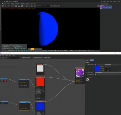

About Custom AOV1, it seems to work as expected here:
Could you share more info or a simple example scene that shows the issue?

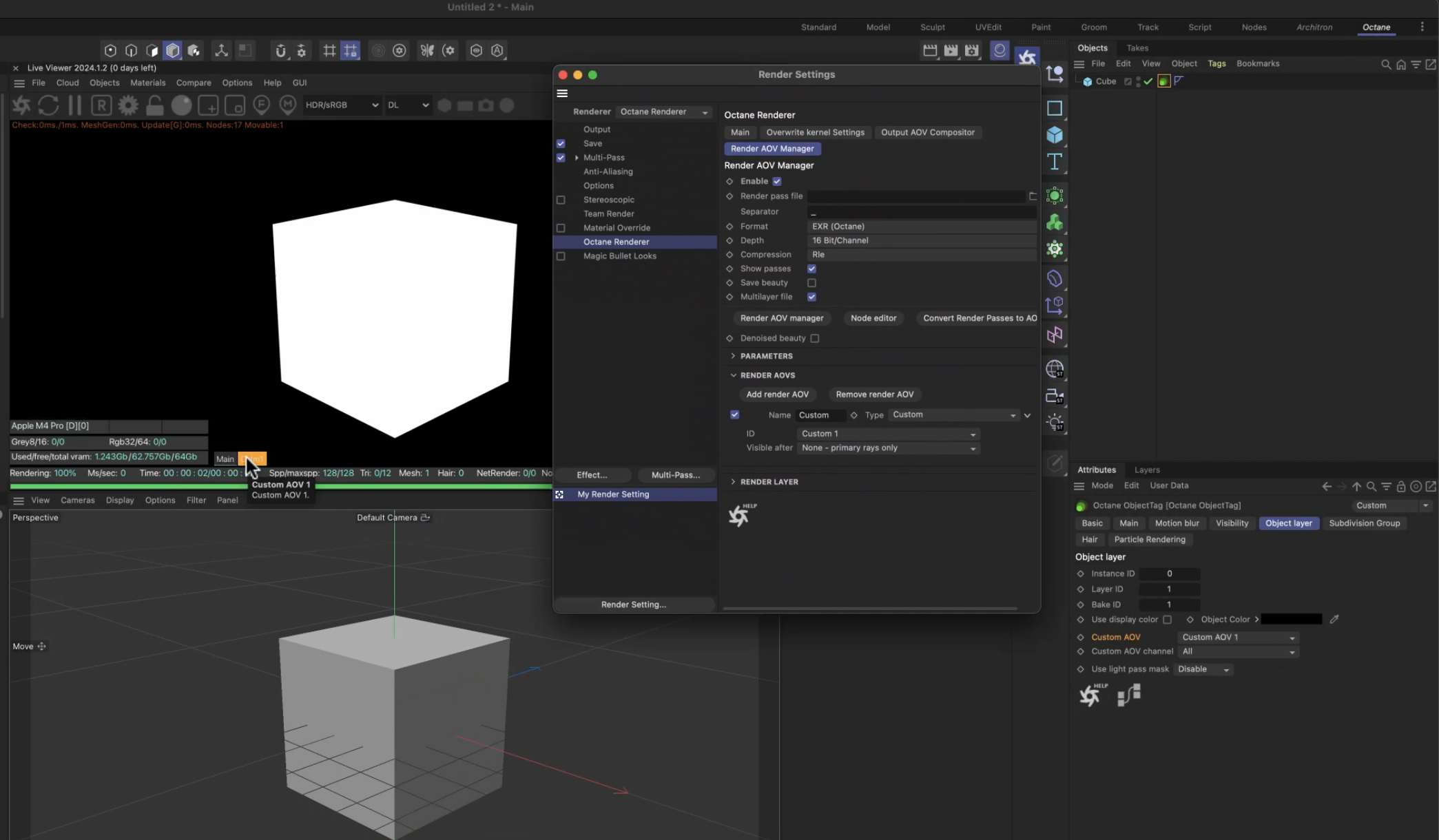

1) Hello, I am attaching the test scene, please go straight into material editor to see the Sub material1 and its Capture AOV node which I do have problem with... There is Custom AOV specified as number 1 and I feel something like it is very similar as I have been having this issue from time to time with some renderers as Redshift and Octane as well, that number 1 is optional to choose from but never actually do nothing so what is the magis causing this please?

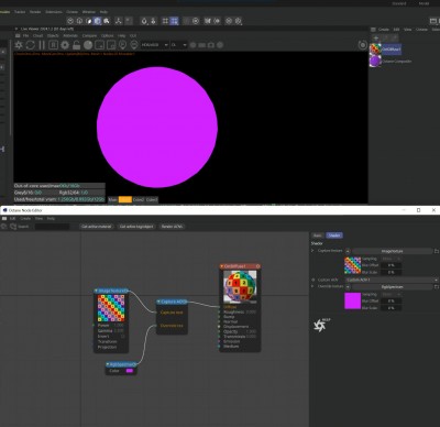

2) And also I have a question how to render just black and white like matte for the mix material custom AOV? Do I need RGB Spectrum node for that override texture input? Because it does produces just the color I specified so it can be that, but not sure...
https://drive.google.com/file/d/154qJt_ ... sp=sharing
I have already tried based on documentation the input of "override texture" and on its description "Override Texture — This input will output the texture to the specified AOV, but it will IGNORE the texture for the material." i use RGB Spectrum with white color and it seems it does that trick I am talking about I need.

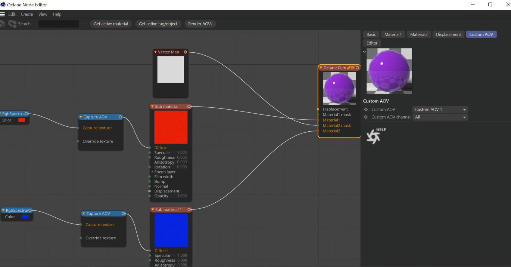

3) Why I need to use "Sub Material" within Composite Material? Because in Mix Material you can just drag and drop existing material I already have built. So What the difference?

1. Ok, the confusion comes from the fact that plugin assigns Custom AOV1 to all materials:
So you need to set both Composite and Sub Materials to None, to be able to use Custom AOV1 with Capture node:

2. You should need to connect the ImageTexture node to Capture texture pin, and the RGB Spectrum node to the Overwrite texture pin, then you can use the color you want:
3. Try to copy paste a Mix material between different c4d scenes, or save it in Asset Browser, or use the Solo mode with Mix Material. This why we have Composite material with Sub Materials.
