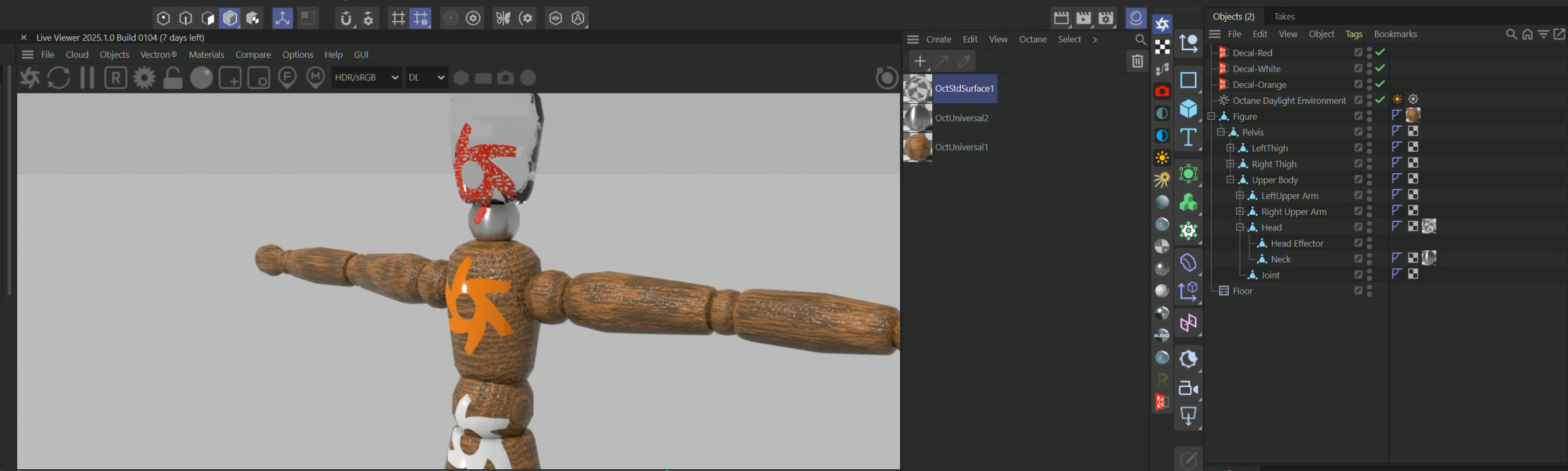

Would be great to have a demo scene for using the decal tool.
Currently struggling to use it.

Saw this tutorial posted today: https://youtu.be/rDRIj8TMxe4Kalua wrote: Sat Apr 12, 2025 11:00 pm Would be great to have a demo scene for using the decal tool.

@Kalua:
please have a look at the following example scene about Decal usage on Universal Glossy, Universal Metal, and Standard Surface Glass materials: ciao,
