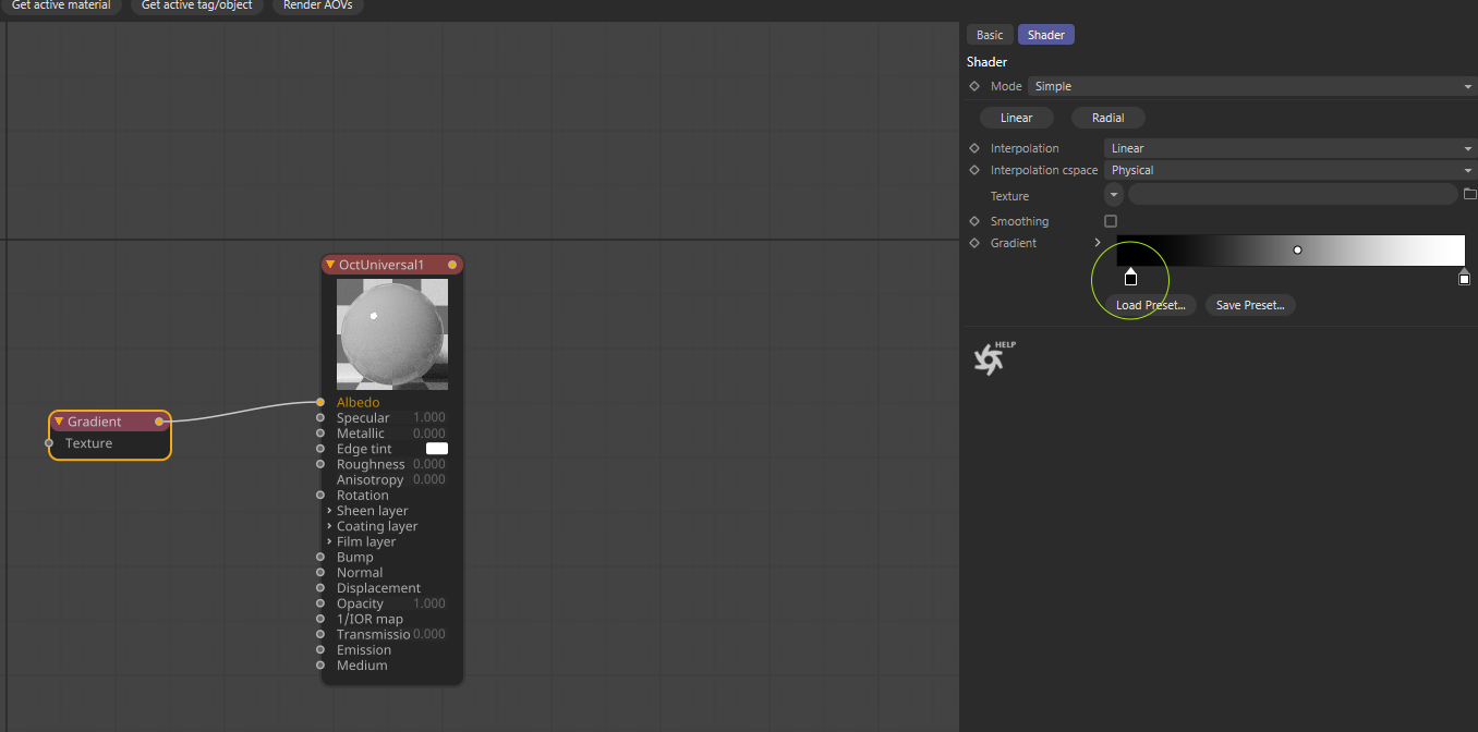

I have been playing around with Octane for a few months and love it but there is a bug that is driving me crazy.
When using the viewport rendering c4d hangs every time I change gradients or color sliders, it has been doing this since the first day I started using it and I have tried it on two different machines.
this works fine in the Live viewer. Just move the slider of the gradient for reproduction while the render is on in the viewport.
Win11, RTX 4090 v566.14, 128gb ram.
Viewport rendering hangs when changing parameters.

Thanks for the report, it is reproducible in Windows, while it works without issue in macOS.

This issue has been fixed and will be part of the next release
