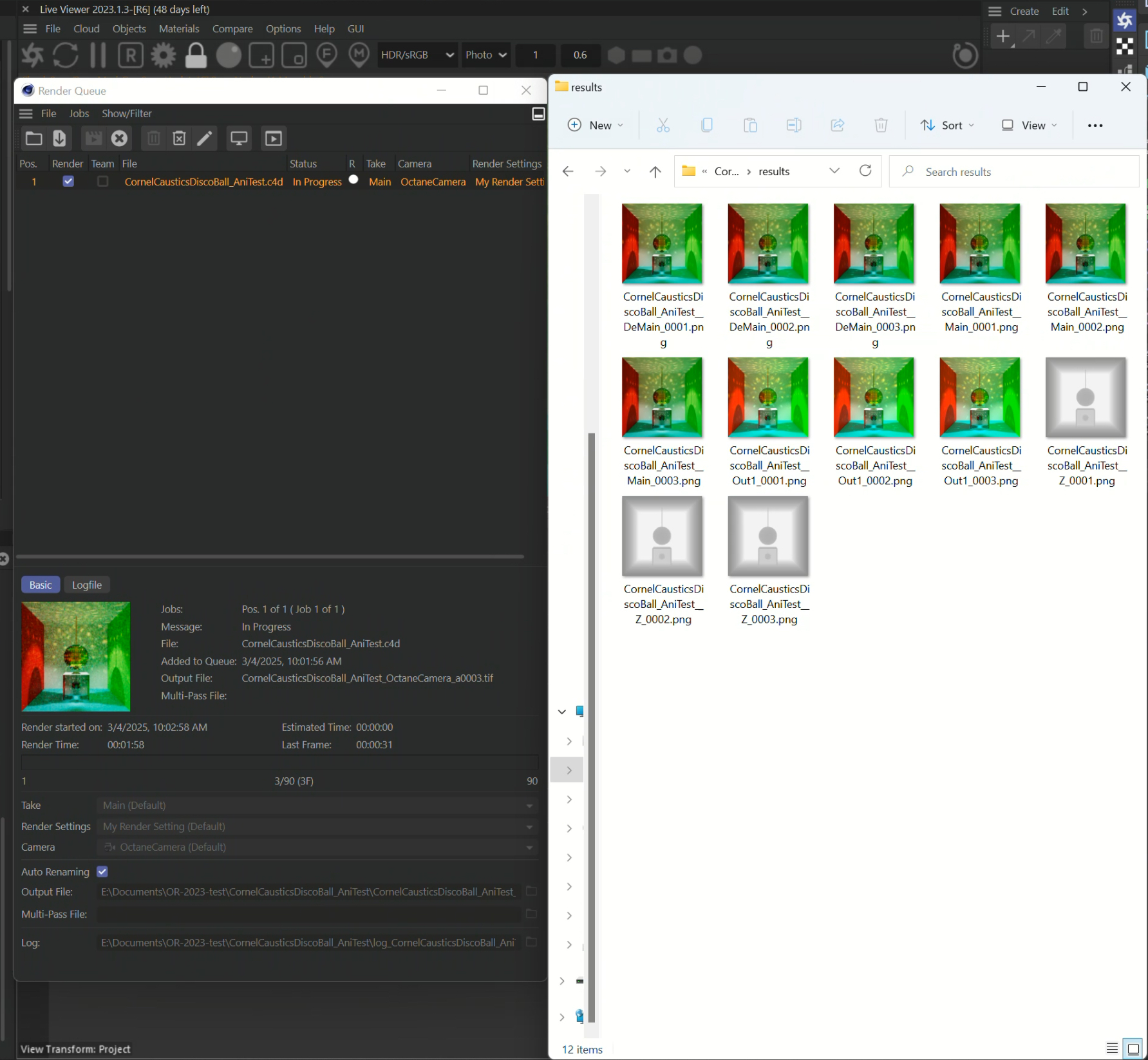

just tried with c4doctane 2023.1.3-R6:
https://render.otoy.com/customerdownloa ... R6_win.rar
And everything has worked as expected in Render Queue:
About, C4D Save tab, even if disabled, C4D always saves the results in Render Queue, it is a known c4d issue, common to any render engine.
