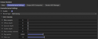

Hmm, currently fighting a bug that prevents me from using the current plugin build: Sample Count and Depth reset to 0 whenever opening the Render Settings (in the Overwrite Kernel Settings, Live Viewer works fine).
I can adjust the sliders, but they will reset the next time I'm returning to the Settings.
C4D is the the newest version, 2025.1.3.

Thank you for pointing this out. This will be fixed in the next buildTim0042 wrote:Hmm, currently fighting a bug that prevents me from using the current plugin build: Sample Count and Depth reset to 0 whenever opening the Render Settings (in the Overwrite Kernel Settings, Live Viewer works fine).
@Chris: Ah, perfect - thank you for looking into this!

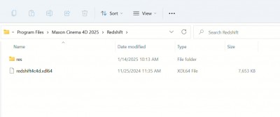

One more question that came up: It's great to have a proper installer for the plugin though it currently defaults to a location in the C4D installation directory and creates a plugin folder there. This still works but seems to be the old way of doing things, while newer C4D has a plugins folder in its preferences (so under AppData/Roaming/etc.) while also giving users the option to define a custom one in some external location.
With that in mind, would it be possible to allow for updating/correcting the installation path in the installer? Right now, I can manually input the path to the correct preferences/plugin folder but the installer shows it as invalid.
As a workaround, I can always manually move the folders of course, but this would mean losing the benefit of having an installer.
Yep it should default to prefs/plugins
Hi guys,
Also RedShift is installed in the same location: In this way it is installed in Admin mode, while AppData/Roaming/Maxon/.. directory is an User folder.
