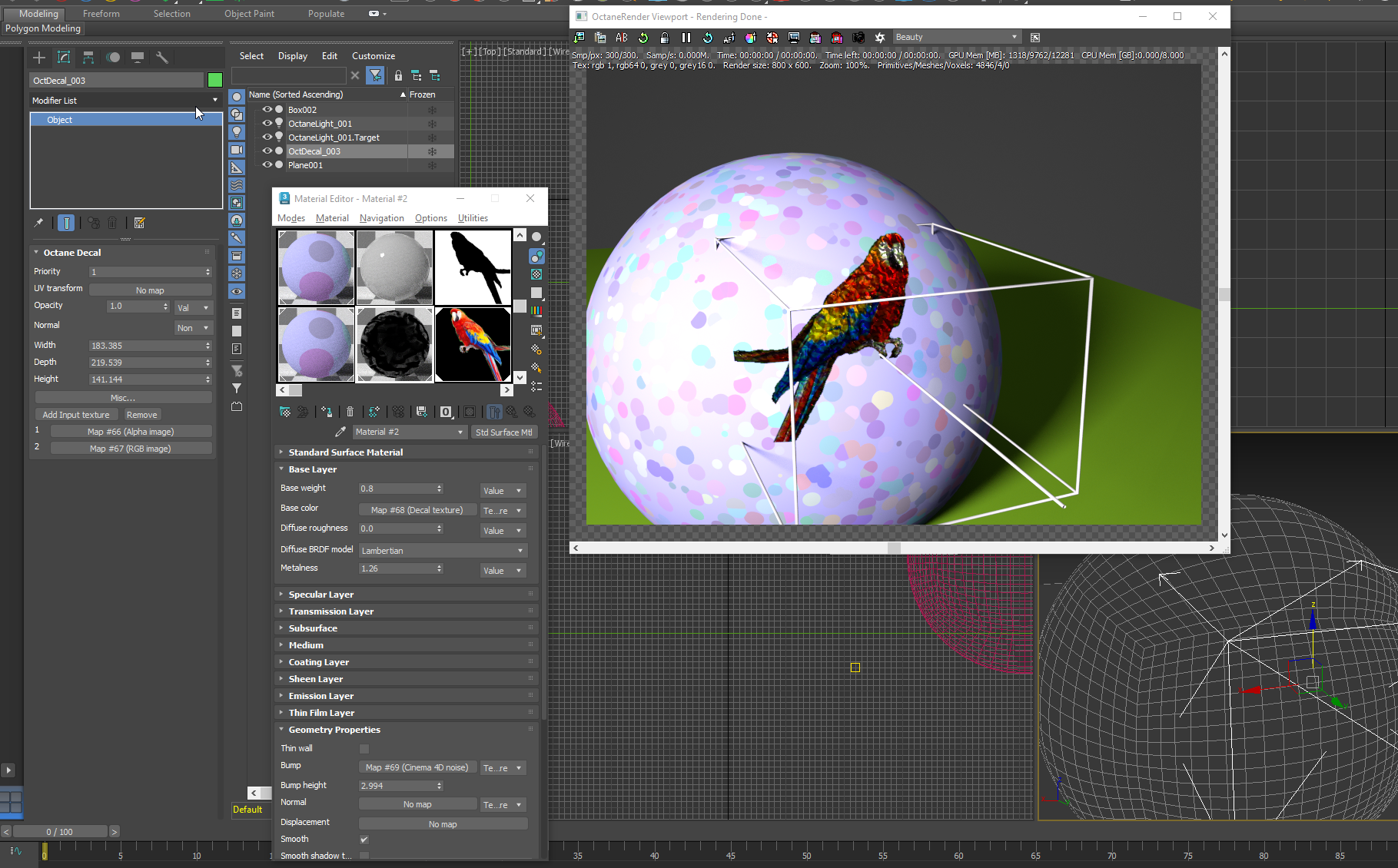

One way to have a decal with a different material is to use a mix material:
Here the Box002 (spherified) has a mix of Diffuse material with a Flakes textures, and a Std Surface Mtl with a noise texture in the Bump pin .
A Decal texture 1 is used for the Amount of the mix, and a Decal texture 2 is used as the Base color of the Std Surface Mtl.
Both decal texture 1 and 2 use the same image, parrot_in.png, that has an alpha channel used as a mask for the Amount.
Decal_Sample04_04.zip
(159.7 KiB) Downloaded 310 times
