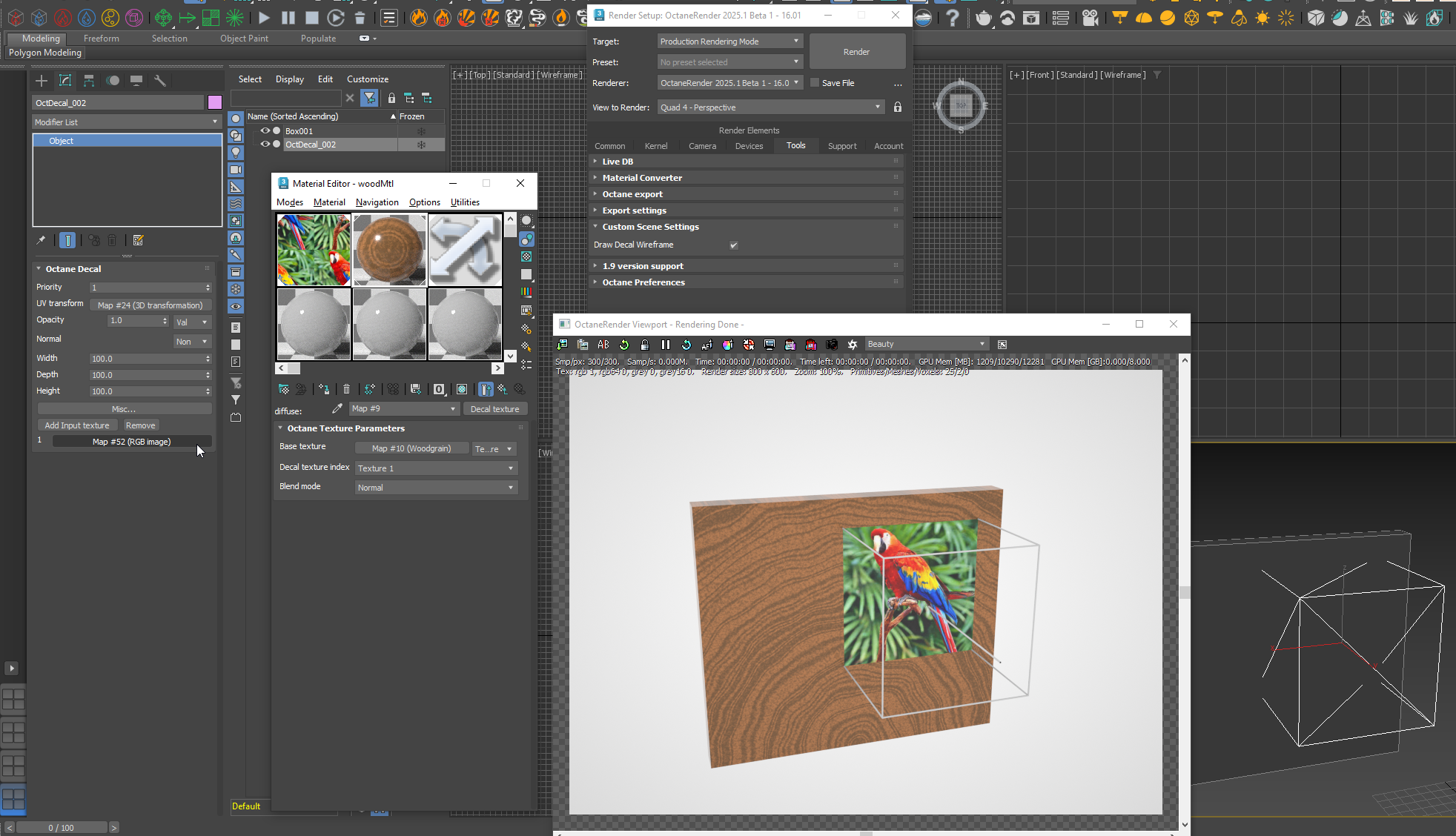

The Box001 uses a Decal texture that is set to use decal texture index 1, and defines a Base texture (woodgrain) applied where no decal is projected.
The OctDecal_002 object defines the volume where textures will be projected, and a list of textures (only 1 in this sample)
2 objects use different Decal textures, but using both decal texture index 1.
A single Decal object defines this texture index 1.

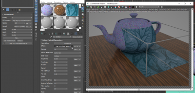

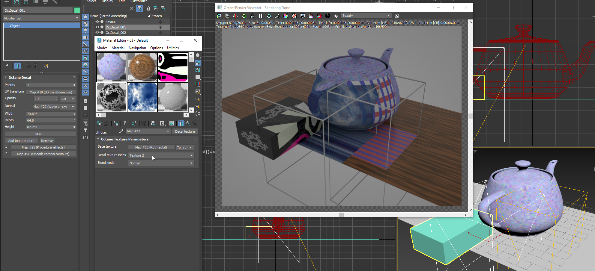

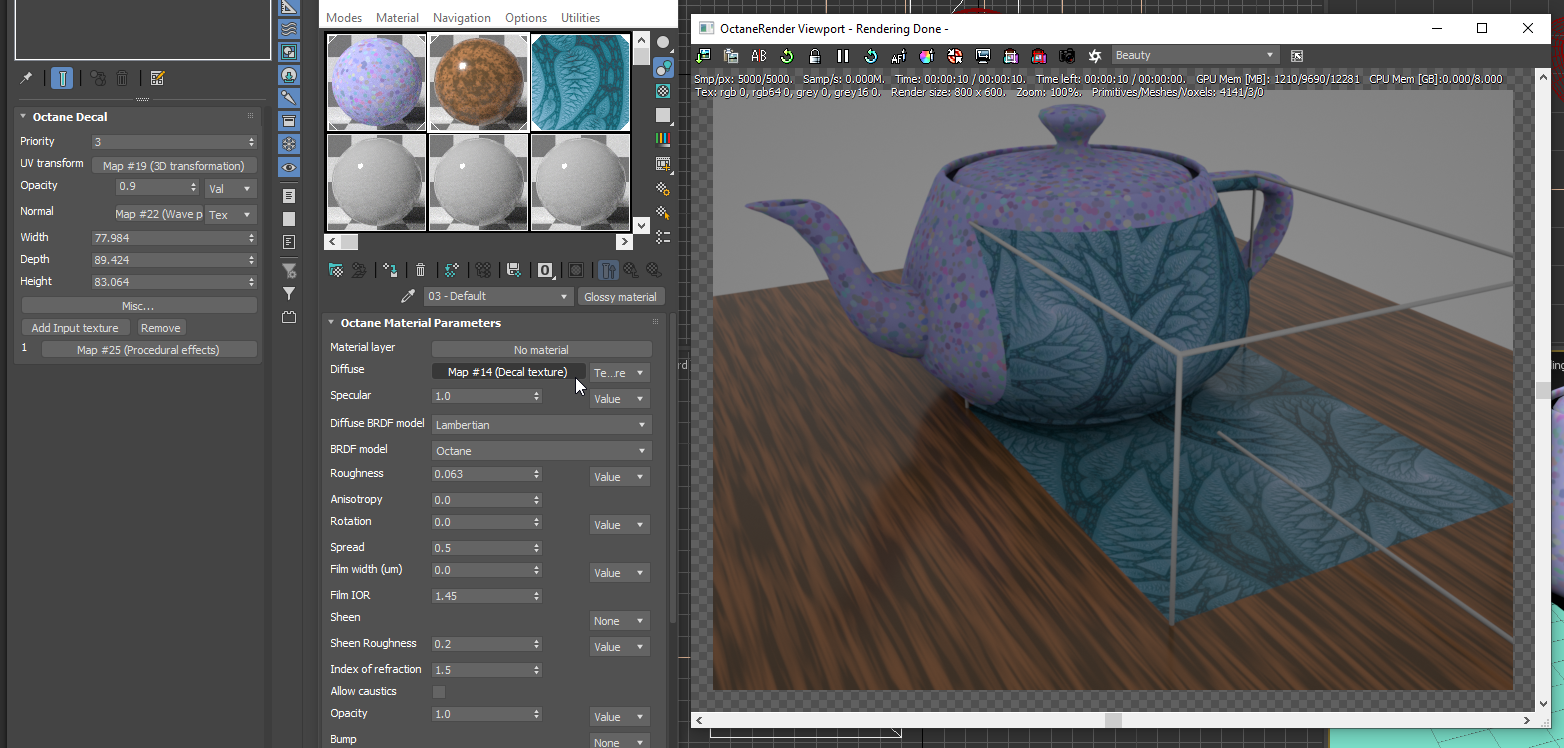

3 objects use different Decal textures, and 2 Decal objects define different lists of textures.
The teapot and ground plane use decal texture index 1.
The box uses decal texture index 2.
OctDecal_001 define texture index 1 and 2. (Procedural effects and Smooth Voronoi)
OctDecal_002 define texture index 1 (Stripes).

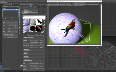

One way to have a decal with a different material is to use a mix material:
Here the Box002 (spherified) has a mix of Diffuse material with a Flakes textures, and a Std Surface Mtl with a noise texture in the Bump pin .
A Decal texture 1 is used for the Amount of the mix, and a Decal texture 2 is used as the Base color of the Std Surface Mtl.
Both decal texture 1 and 2 use the same image, parrot_in.png, that has an alpha channel used as a mask for the Amount.
