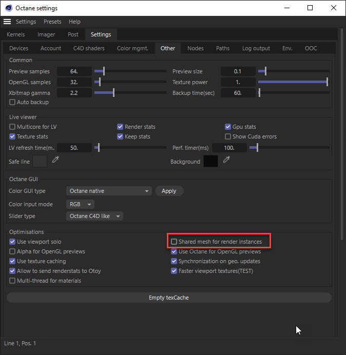

It's about this option. It's an optimisation flag to avoid having same mesh double times.

aoktar wrote:It's about this option. It's an optimisation flag to avoid having same mesh double times.
You are the best! thanks! :mrgreen:
