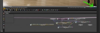

Do you think we could have the blue P2P Nvlink Memory pool usage bar like the one we see in Standalone version?
Would love to have clarity of Ressources being used in the 2x3090 + Nvlink setup.
And consdering how 4090 and 5090 12v connector fiasco won't have a solution in the near fuure, I will probably be sticking to this setup for at least another year or 2.
