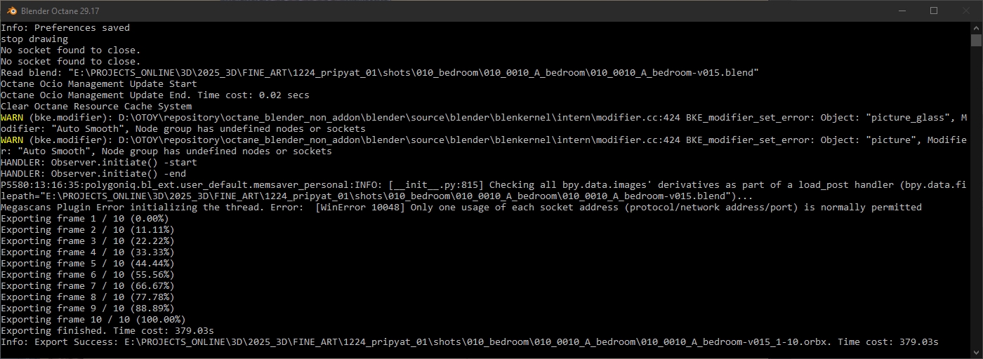

Hey Lino,
I've installed the 29.17 update and attempted to export a scene of similar complexity and am running into the same issue as before.
-Scene frame range is 1-240
-I attempt to export an ORBX of 1-10 to test the scene
-Blender begins exporting, first creates a folder bearing the filename entered in the ORBX exporter dialog -folder contains textures and a geometry.abc file -after the geometry.abc is created, it claims success in creating the .ORBX file but never ends up creating one. Let me know if you want me to send over this file as well. Cheers!
Update:
Changing the frame range for the entire scene from 1-240 to 1-10 and then exporting an ORBX works.
It only seems to want to create the ORBX file if the frame range in the export dialog matches the frame range defined in the Scene tab's Start and End Frames (or animation timeline).

Yes, that was the issue. We're on it.
