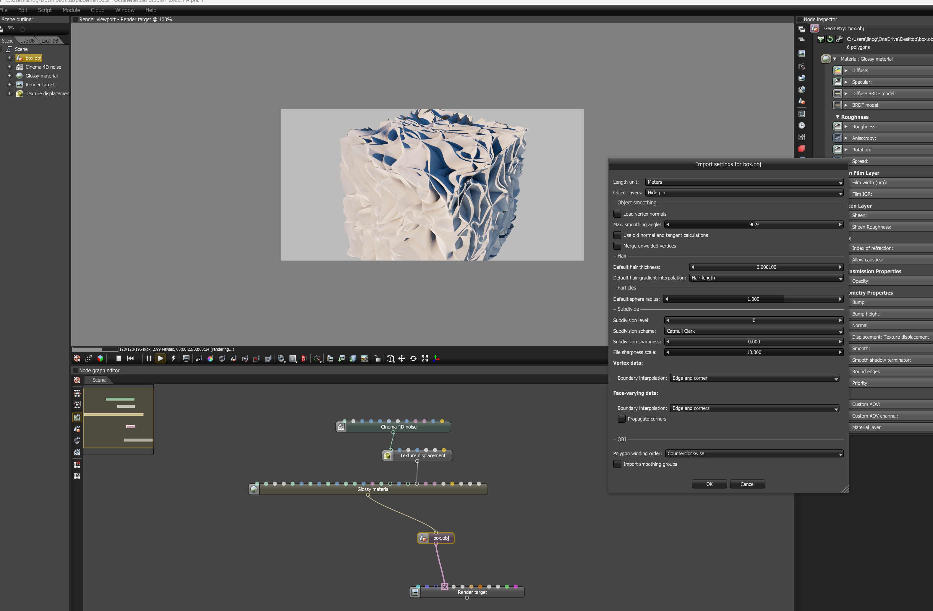

linograndiotoy
Posts: 1496
You forgot to include the fbx and the image.
linograndiotoy
Posts: 1496
That's what you need to do:
displacement_Lino.ocs
(58.84 KiB) Downloaded 226 times
J.C
Posts: 1874
Joined: Thu May 13, 2010 6:35 pm
Location: Wrocław
With obj file it works properly.
Try with Octane Geometry primitive box or the fbx file exported straight from Blender (attached).
box.zip
(3.31 KiB) Downloaded 207 times
