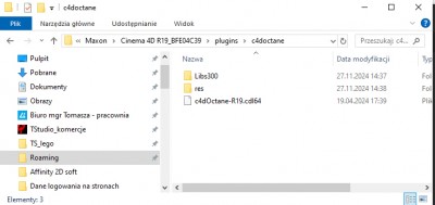

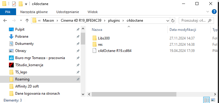

Of course I have left only "c4dOctane-R19.cdl64" in folder as usual.

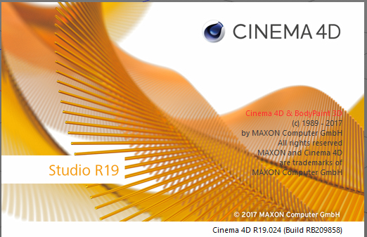

Your R19 is older than requirements. Plugin cannot run if you don't use the minimum version numbers of C4D as described in release topics. R19.053 is minimum.

you need C4D R19.053 or greater.
But please note that 2023.1.3-R3 is the latest version you can install in C4D R19 or 20.

I have reach out to Maxon support and they give me finlal R19.068 updater :-) Case solved! Octane is working - great as usual !
