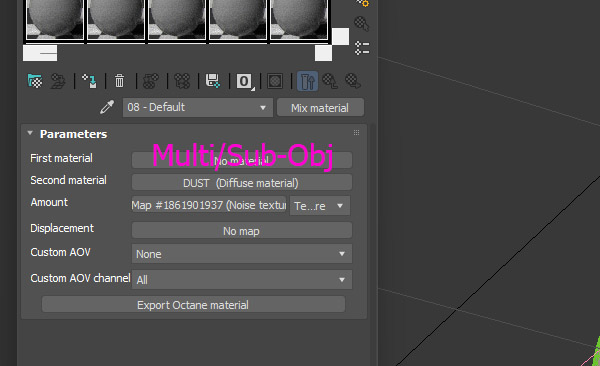

Can you please add an option where we can add Multi/Sub-Obj to your mix material. It's useful to quickly coat them with dust, etc. Right now we have to add a layer of dust per material Thanks

In Vray I could plug a standard 3dsmax multi/sub-object material (with many materials attached to it) straight into a VrayBlend material, which is the equivalent of a Compostie material in Octane and I could apply on the second slot another material and then mask the entire object via VrayDirt map, think dirt or snow etc.
However in Octane when I plug the multi/sub-object material into a Composite material or Mix material it shows the material as either grey or it pulls in the first material id in the multi/sub-object material
Adding a mix node plus a dirt map to every material in the multi/sub-object material is not a realistic workaround on a proper project also this would not apply the dirt mapping uniformly over the entire object it would apply it per element...
