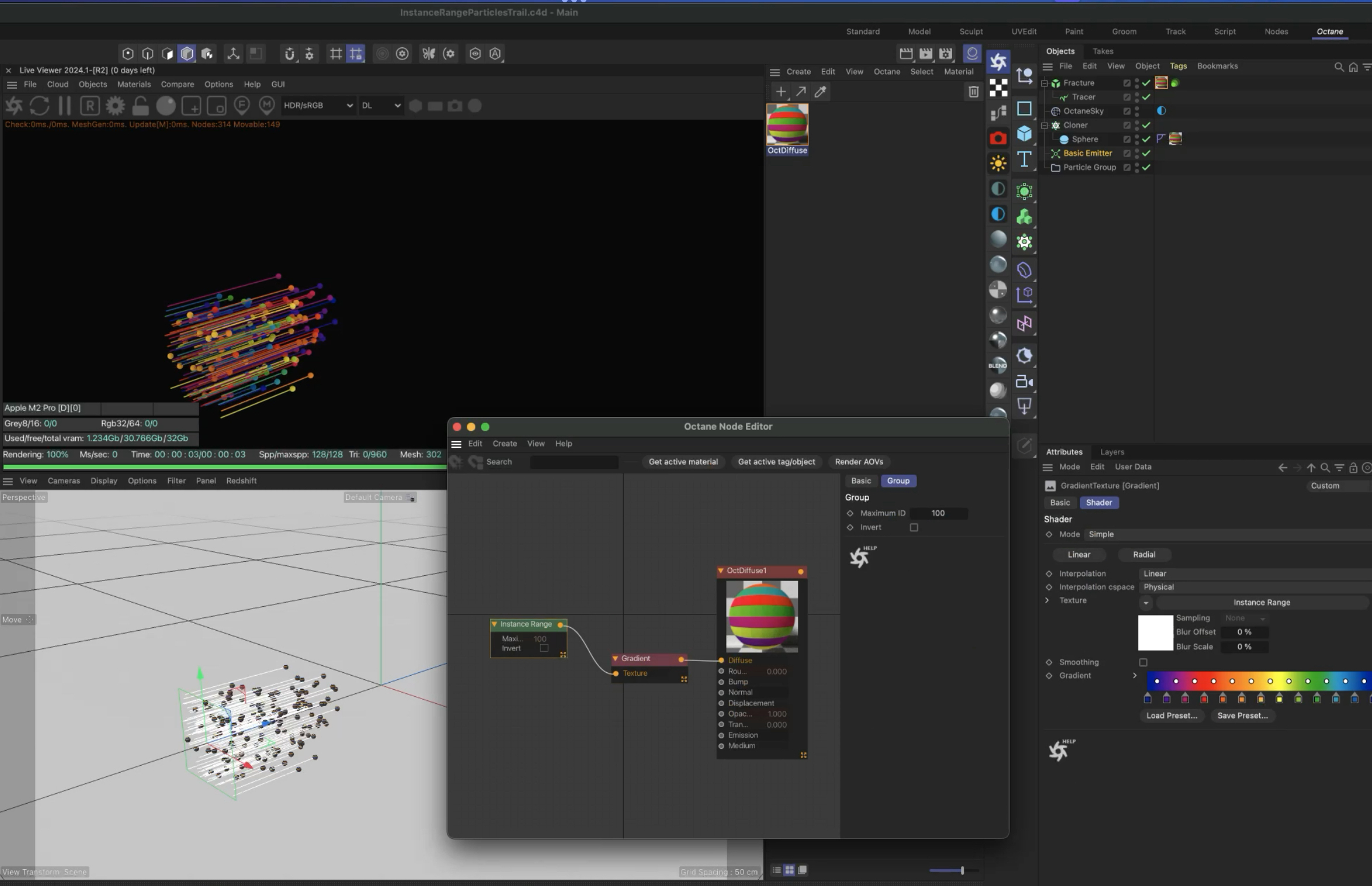

Posts: 10611
Ok, different approach, you can use an Instance Range node for both particles and trails, where the Maximum ID number is equal to the number of particles rate:
InstanceRangeParticlesTrail.c4d.zip
(183.58 KiB) Downloaded 142 times
ciao,
Beppe

Hello, Beppe! Great result!
But I still have the issue it takes only the first color from the gradient no matter what. Is there a specific option I need to change to make it work?
https://youtu.be/jDTX3VeyT7c?si=7Zl-nF7OrUhPWlyA :?:
The second question :?: is if there is a way to transfer data from particles to trails? For example, particles can change color during the life, depending on speed\velocity\radius\distance etc. Can it be transferred on trails?
Much appreciate.

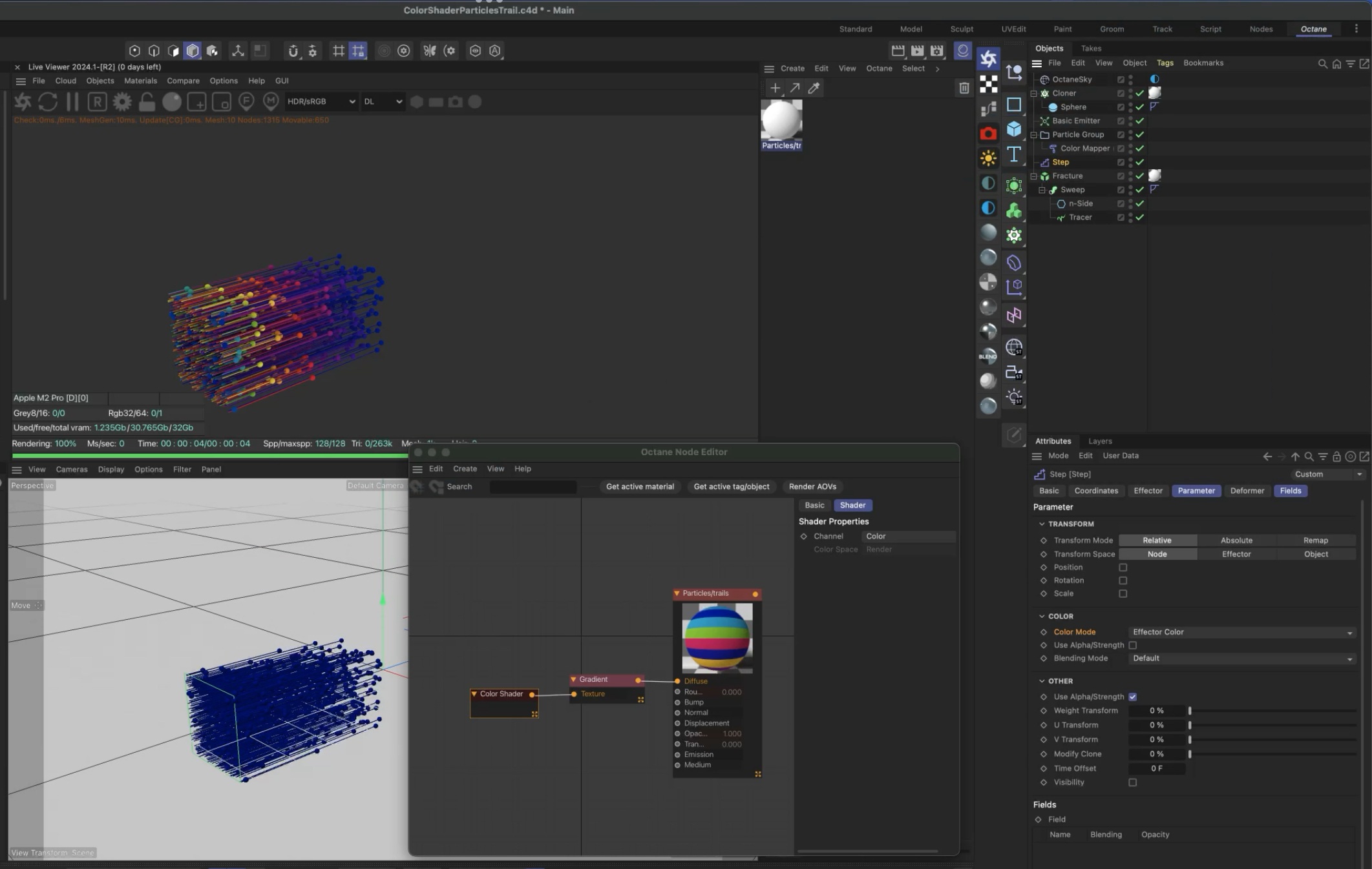

Posts: 10611
Ok, here is another approach insired by latest Raphael Rau's tutorial:
https://youtu.be/ypE_C9Q-r5I?si=Q5zTvz0l-K7Rn_DJ
Basically it is using a Fracture object to separate all the single trail from the Spline+ Tracer object, then a Step Effector applied to both Fracture object and MoGraph cloner for particles, to obtain the same ID/colorization, then finally a C4D Color Shader and an Octane Gradient node in the material, for mapping the colors you want:
ColorShaderParticlesTrail.c4d.zip
(260.8 KiB) Downloaded 120 times
ciao,
Beppe

Thanks, Beppe. This one works fine.
Strange that previous method works for you, but when I opened your previous project it didn't work the same for me. I preferred it better because with the sweep nurbs you have much more geometry in the scene.
