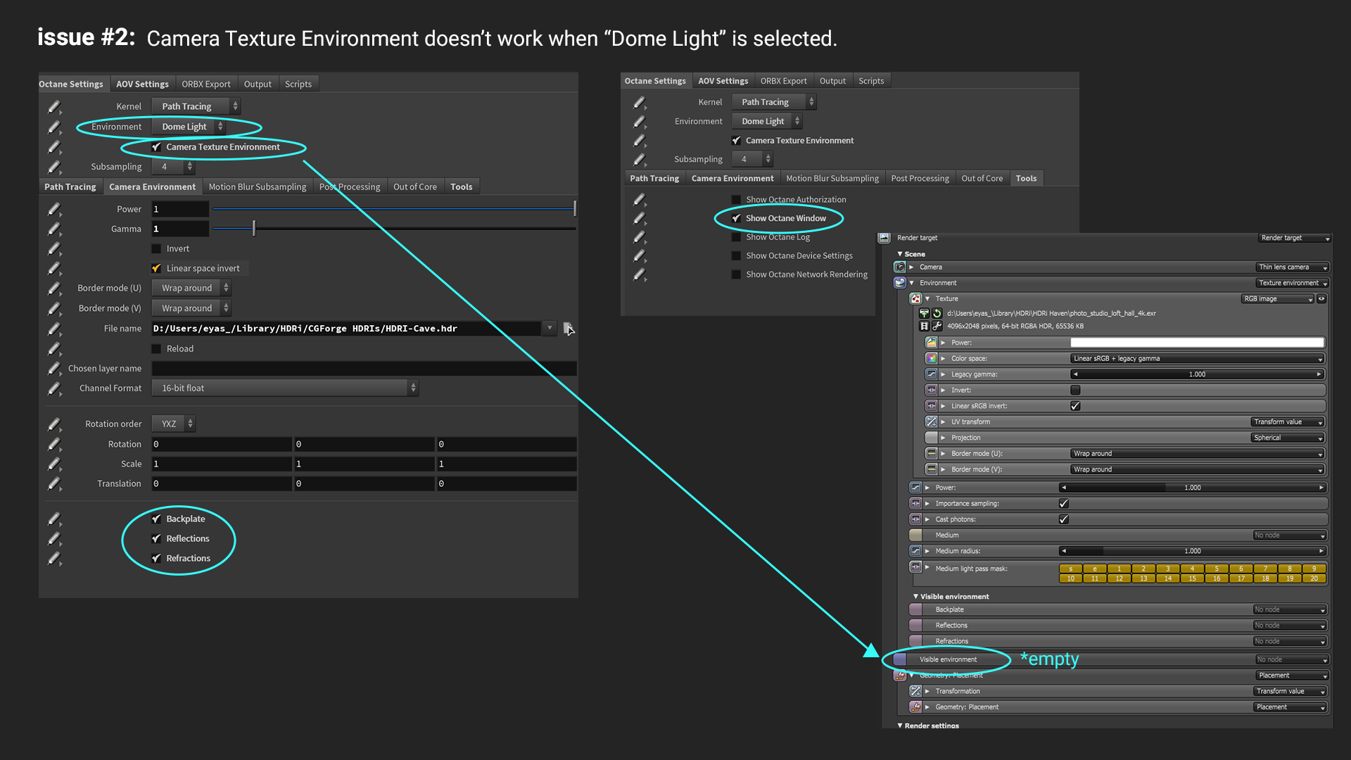

Issue #2:
As for number #2, I checked the issue and it seems like a missing functionality.
When choosing the "Dome Light" for "Environment" in "Octane" LOP, for some reason Octane fails to render the "Camera Texture Environment" as a background and ignores it completely continuing to render the "Dome Light" as a background.
To double check the issue and be certain, I used the "Show Octane Window" under the "Tools" tab to view the render settings from inside Octane itself.
I attached here an image showing this.

Hey EyasArraf,
Thank you .. Regarding the 1, we have added the color and Color space..
for 2, check if you have the Viewport light disable button on. This button sortof overrides the Dome light.. The Visible environment in Show Octane windows is constantly replaced when we change any parameter.
