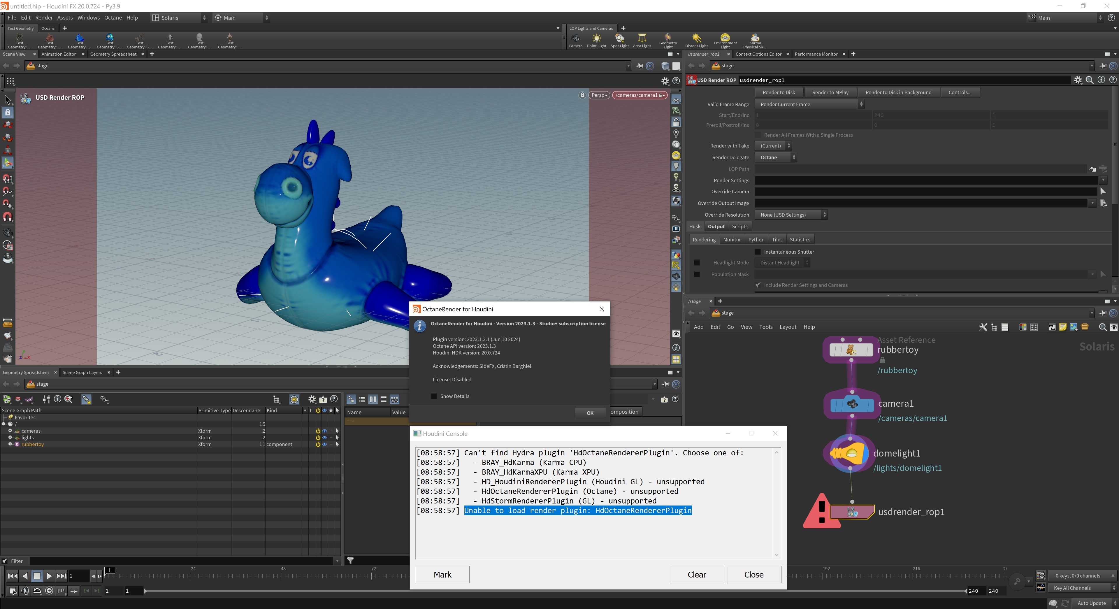

When start Houdini Solaris, everything seems normal, but I can't switch viewport persp to octane. If I do that, nothing happens! Meanwhile persp - "octane" button disappears!
If I using "USD render ROP" node, "Render Delegate" switch to "Octane", then render to Disk, a error jumped out, it showed Unable to load render plugin: HdOctaneRendererPlugin.
Code: Select all
[08:58:57] Can't find Hydra plugin 'HdOctaneRendererPlugin'. Choose one of:
[08:58:57]   - BRAY_HdKarma (Karma CPU)
[08:58:57]   - BRAY_HdKarmaXPU (Karma XPU)
[08:58:57]   - HD_HoudiniRendererPlugin (Houdini GL) - unsupported
[08:58:57]   - HdOctaneRendererPlugin (Octane) - unsupported
[08:58:57]   - HdStormRendererPlugin (GL) - unsupported
[08:58:57] Unable to load render plugin: HdOctaneRendererPlugin
It can't render, and I can't fix it. Anyone can help me? Thank you very much!

[10:44:49] Can't find Hydra plugin 'HdOctaneRendererPlugin'. Choose one of:
[10:44:49]   - BRAY_HdKarma (Karma CPU)
[10:44:49]   - BRAY_HdKarmaXPU (Karma XPU)
[10:44:49]   - HD_HoudiniRendererPlugin (Houdini GL) - unsupported
[10:44:49]   - HdOctaneRendererPlugin (Octane) - unsupported
[10:44:49]   - HdStormRendererPlugin (GL) - unsupported
[10:44:49] Unable to load render plugin: HdOctaneRendererPlugin
