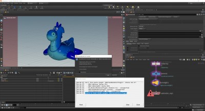

When start Houdini Solaris, everything seems normal, but I can't switch viewport persp to octane. If I do that, nothing happens! Meanwhile persp - "octane" button disappears!
If I using "USD render ROP" node, "Render Delegate" switch to "Octane", then render to Disk, a error jumped out, it showed Unable to load render plugin: HdOctaneRendererPlugin.
Code: Select all
[08:58:57] Can't find Hydra plugin 'HdOctaneRendererPlugin'. Choose one of:
[08:58:57]   - BRAY_HdKarma (Karma CPU)
[08:58:57]   - BRAY_HdKarmaXPU (Karma XPU)
[08:58:57]   - HD_HoudiniRendererPlugin (Houdini GL) - unsupported
[08:58:57]   - HdOctaneRendererPlugin (Octane) - unsupported
[08:58:57]   - HdStormRendererPlugin (GL) - unsupported
[08:58:57] Unable to load render plugin: HdOctaneRendererPlugin
It can't render, and I can't fix it. Anyone can help me? Thank you very much!

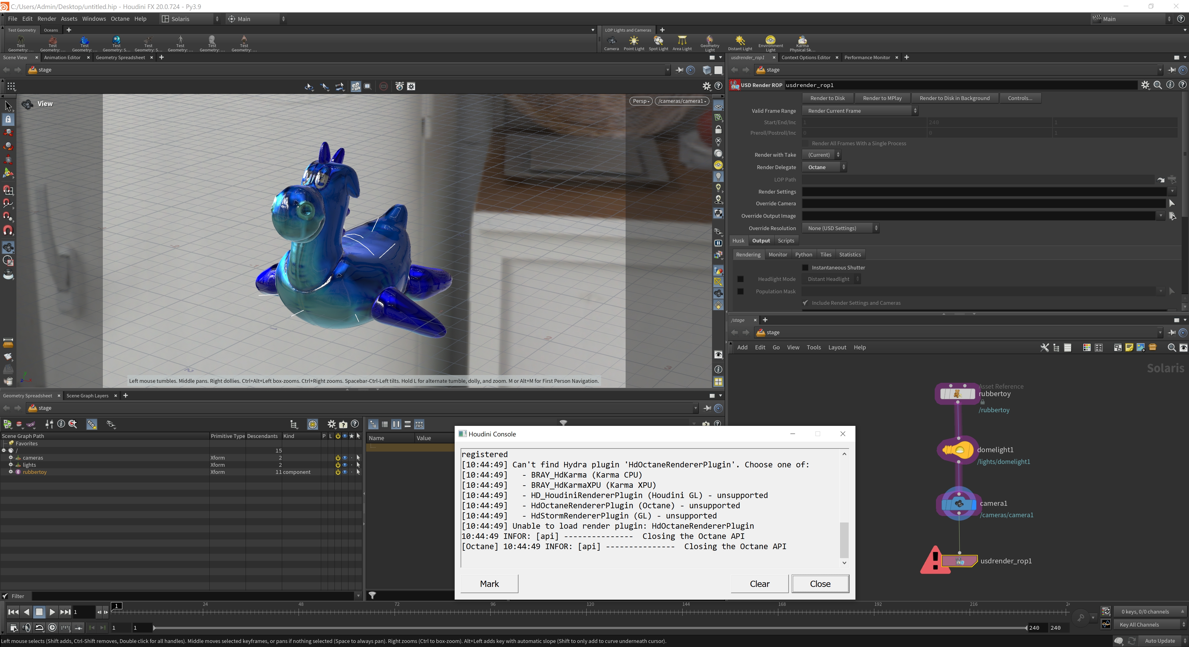

But the error still exists, there is Houdini Console shows:
Code: Select all
[Octane]      Octane Render for Houdini. Build 2023.1.3.1 (Build date: Jun 10 2024 14:51:56)
[Octane] Octane API: 2023.1.3
[Octane] HDK API: 20.0.724
[Octane] Houdini host version: 20.0.724
[Octane] Initializing Octane API
[Octane] Octane API ready. Initialization time: 1.202 seconds
[Octane] OCIO configuration ready. Initialization time: 0.004 seconds
[Octane] Octane network rendering enabled. Initialization time: 0.001 seconds
[Octane] Loading preferences from: C:/Users/Admin/Documents/houdini20.0/octane.pref
10:44:48 INFOR: [nodes] -------------  Registering Octane VOP nodes
[Octane] 10:44:48 INFOR: [nodes] -------------  Registering Octane VOP nodes
10:44:48 INFOR: [nodes] -------------  Octane VOP nodes registered
[Octane] 10:44:48 INFOR: [nodes] -------------  Octane VOP nodes registered
10:44:48 INFOR: [nodes] -------------  Registering the plugin custom VOP nodes
[Octane] 10:44:48 INFOR: [nodes] -------------  Registering the plugin custom VOP nodes
10:44:48 INFOR: [nodes] -------------  Plugin custom VOP nodes registered
[Octane] 10:44:48 INFOR: [nodes] -------------  Plugin custom VOP nodes registered
[10:44:49] Can't find Hydra plugin 'HdOctaneRendererPlugin'. Choose one of:
[10:44:49]   - BRAY_HdKarma (Karma CPU)
[10:44:49]   - BRAY_HdKarmaXPU (Karma XPU)
[10:44:49]   - HD_HoudiniRendererPlugin (Houdini GL) - unsupported
[10:44:49]   - HdOctaneRendererPlugin (Octane) - unsupported
[10:44:49]   - HdStormRendererPlugin (GL) - unsupported
[10:44:49] Unable to load render plugin: HdOctaneRendererPlugin
10:44:49 INFOR: [api] ---------------  Closing the Octane API
[Octane] 10:44:49 INFOR: [api] ---------------  Closing the Octane API

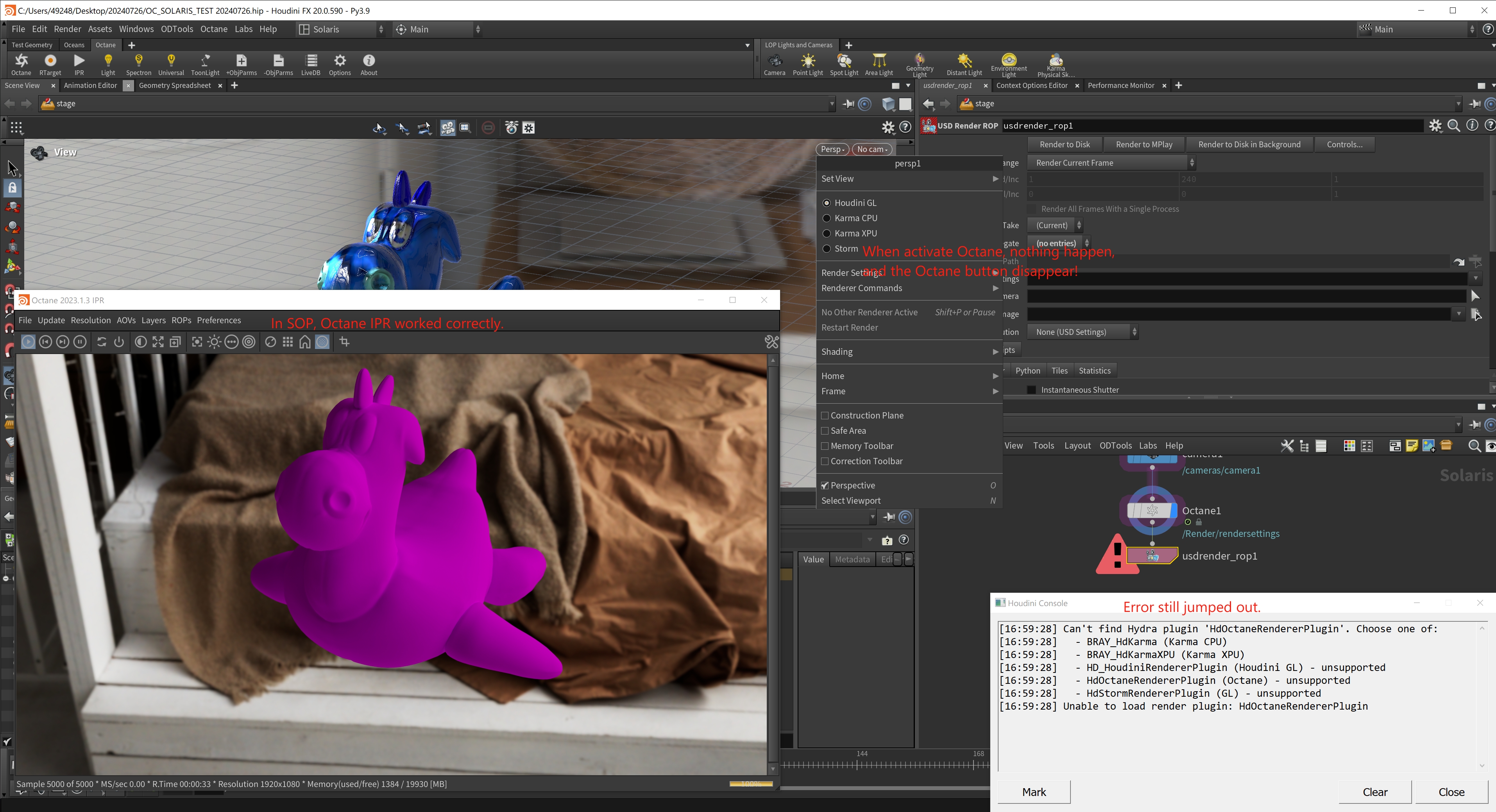

Thank you, ricky_otoy. I have changed another computer to test this, now Houdini version: 20.0.590, Octane version: 1.3.1. I have changed the .json file by using double slashes.
And make sure disk "D" don't have other octane packages:
Code: Select all
    "enable": true,
    "env": [
            "OCTANE_AUTOSPAREPARAMS": {
                "value": 1
            "OCTVERSION": "D:\\Octane_2023.1.3.1_Solaris_20.0.590_Studio+_Win64"
            "HOUDINI_PATH": {
                "value": "$OCTVERSION"
            "PATH": {
                "value": "$OCTVERSION\\bin"
            "PXR_PLUGINPATH_NAME": {
                "value": "$OCTVERSION\\dso\\usd_plugins"
But the error still jumped out! In SOP, octane IPR worked correctly, it means that I installed octane plugin in a right way, octane just can't work in solaris.

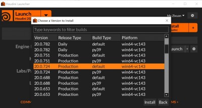

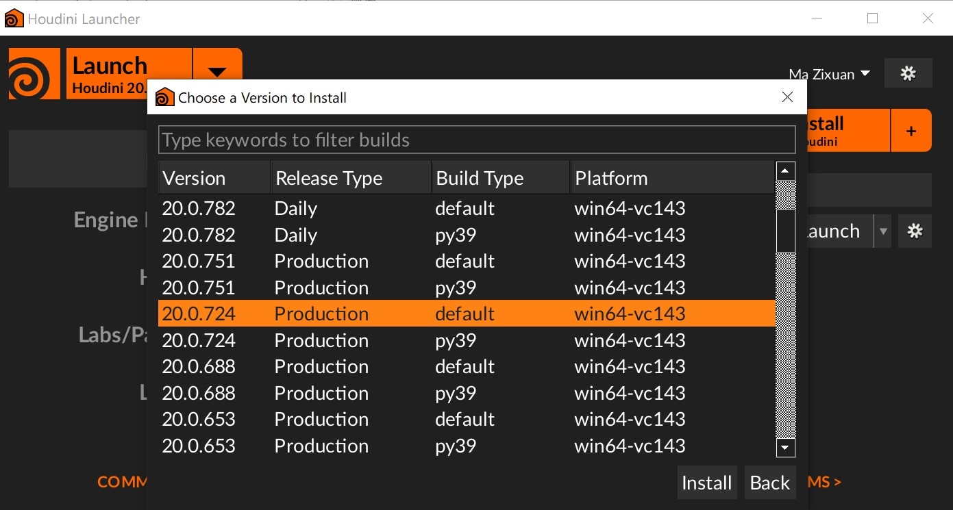

Finally,solved the problem!
This problem is caused neither by the version of houdini nor by the version of octane, but by the version of python! When install 2023.1.3.1 of octane in 20.0.724 of Houdini solaris, make sure the houdini is py 3.10! You can use Houdini Launcher install "default" Houdini, this is py 3.10 Houdini.Then configure OctaneSolaris.json file, octane can worked nicely in solaris preview window.
I suggest that otoy could remind people when releases a new octane version of solaris: have people pay attention to the python version when they install houdini as well.
