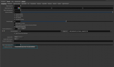

When using the 'rgb4k_map.pmm' method, in the octane parameters tab, you need to change Instance IDs from parameter to Packed RGBA values from Cd attribute

When using the Copy SOP method, you need to turn on Packed geo instancing parameter in the octane parameters tab.
