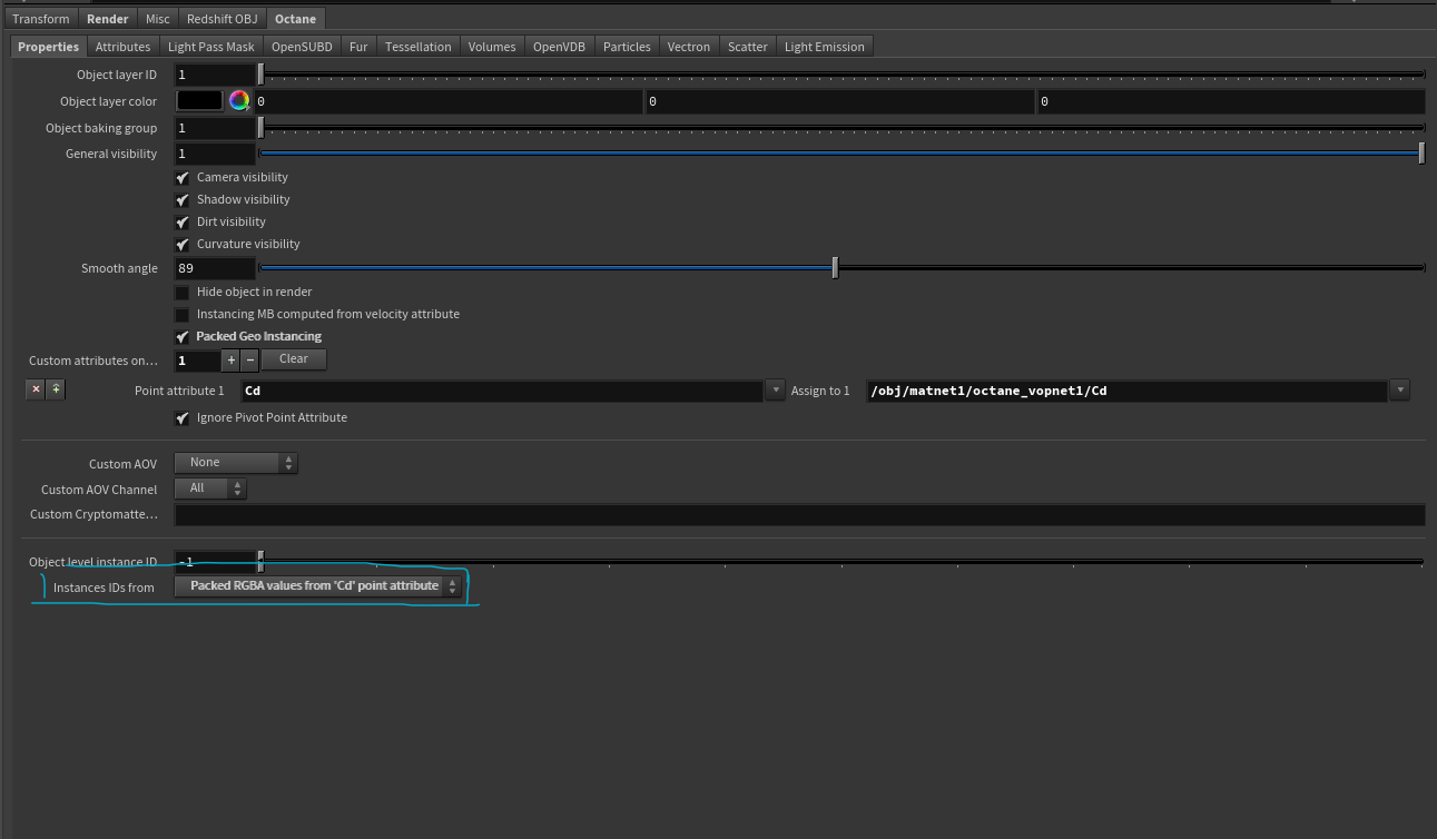

There is some info about attributes on instances here. Randomizing color when scattering multiple objects is currently bugged. It works if its only one object.
When using the 'rgb4k_map.pmm' method, in the octane parameters tab, you need to change Instance IDs from parameter to Packed RGBA values from Cd attribute

						Thanks for the reply.  I've not had success using the Copy SOP as it's very slow (seems like Octane is trying to mesh every instance individually at rendertime). However, the "Instance" SOP is working nicely with performance similar to Octane's scatter object. Adding random colors to my points is also working when using 'rgb4k_map.ppm' on the 'Texture_Instance_Color' node.
						When using the Copy SOP method, you need to turn on Packed geo instancing parameter in the octane parameters tab.
