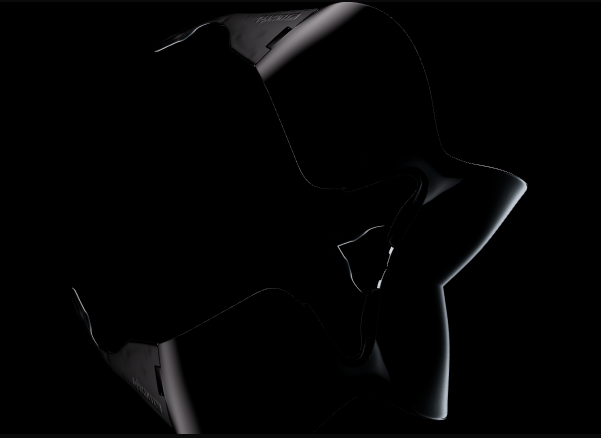

I have only managed this so far with a specular material for the floor and a HDRI with some other area lights.
What I have managed to create so far

x9nder wrote: I have only managed this so far with a specular material for the floor and a HDRI with some other area lights.
An HDRI for studio lighting is to avoid. Nothing hardly beats area lights for their controls and sampling efficiency. Just like in reality, only area lights are needed. HDRI shine in environment, barely anywhere else besides the Lightmap HDRLS software edge-case.
Here's is a quick-and-dirty demonstration:

x9nder
Posts: 4
Joined: Sun Mar 13, 2022 10:18 am
Oh I found the solution thanks! Adding a light or a white background behind and adding a gradient to the opacity of the floor to remove the visible line of the floor creates that infinite look
