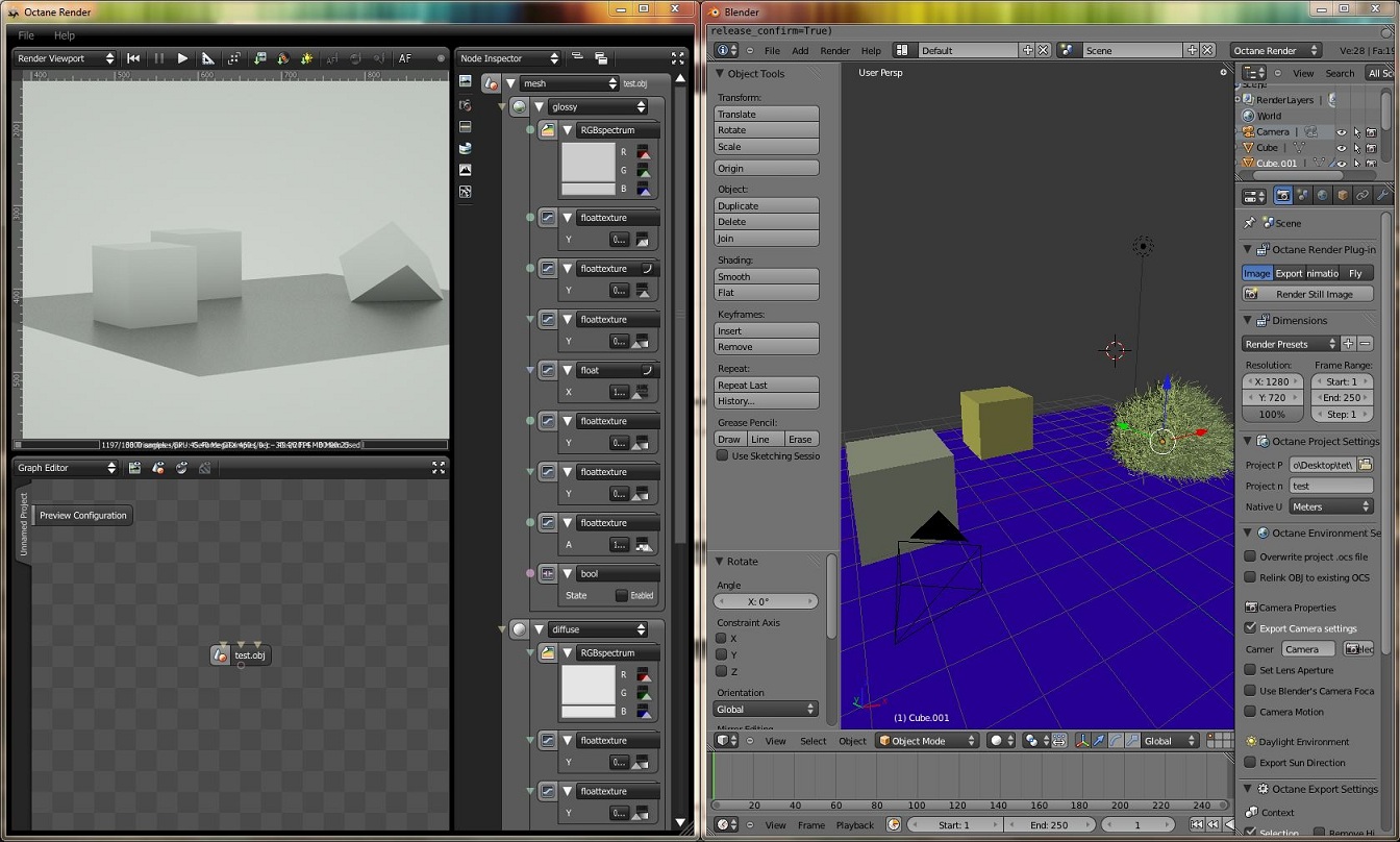

Yo yoyoz,
Just wanted to thank you and enricocerica
for all of the work you are doing to enricocerica
script ...
I'm hoping to get it working soon, .52 loaded for me with a different message window from Octane... Gonna go give .6 a test drive
Launched your anim_v060.blend and worked perfect, tried a default cube scene and failed with a Octane window posted below...
I gotta compare settings with yours, I have something wrong on my end...
Thanks again for all of your time and knowledge.
Peace,
Andy

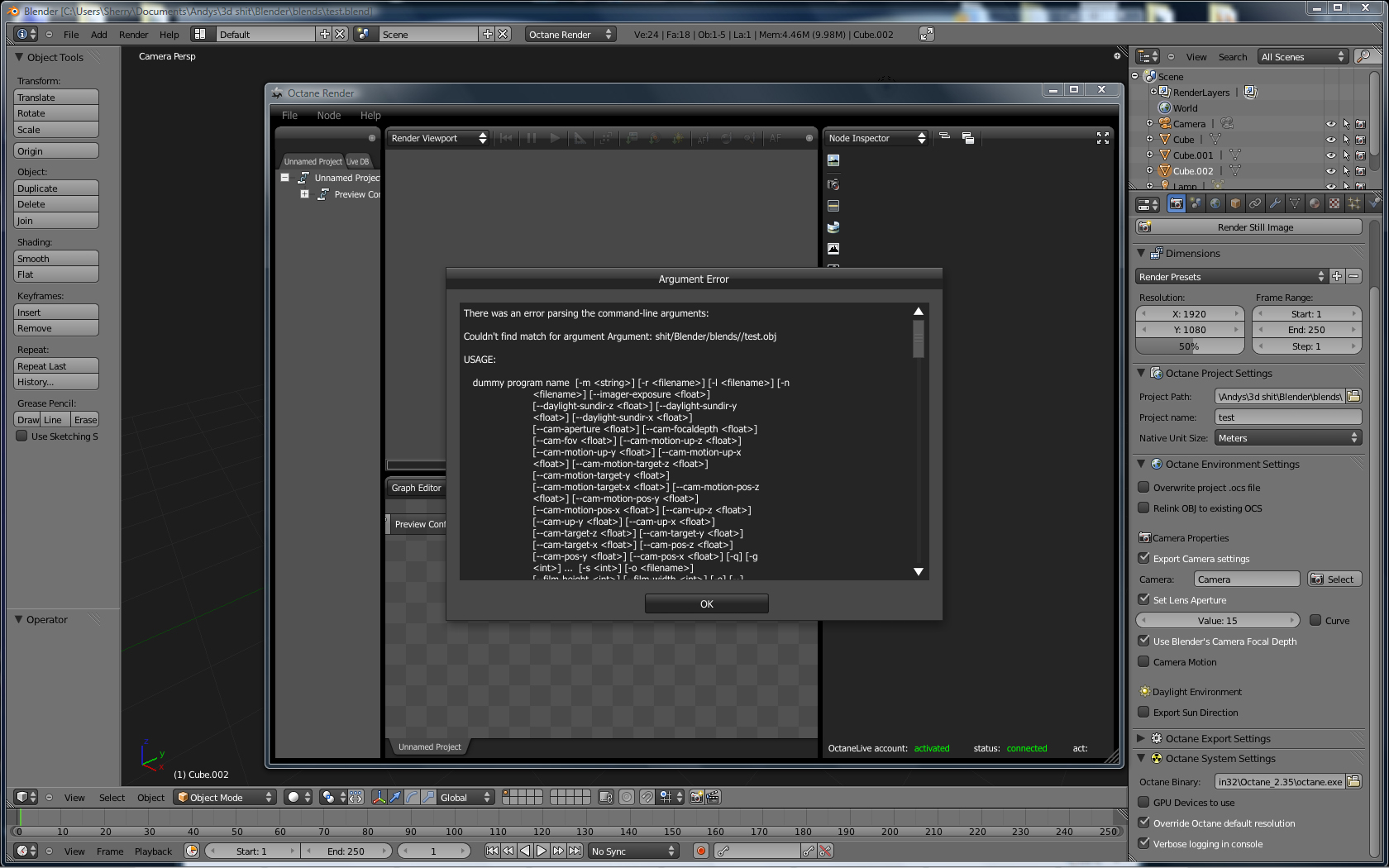

Can anyone help me,
i did everything like how supose to do, and when i click on render still image nothing happens, octane dosnt start ? If i press on export obj it exports it, but i want to see modifiers in action . . .
Is there aything i can do ?

Guys, both of you shouldn't have any space in the paths to the project or to the octane binary. Please move your intall directory and your project one and give another try. I'm working on that but there're also some limitations due to Octane itself.
I'd be happy you let me know if you can make it.
