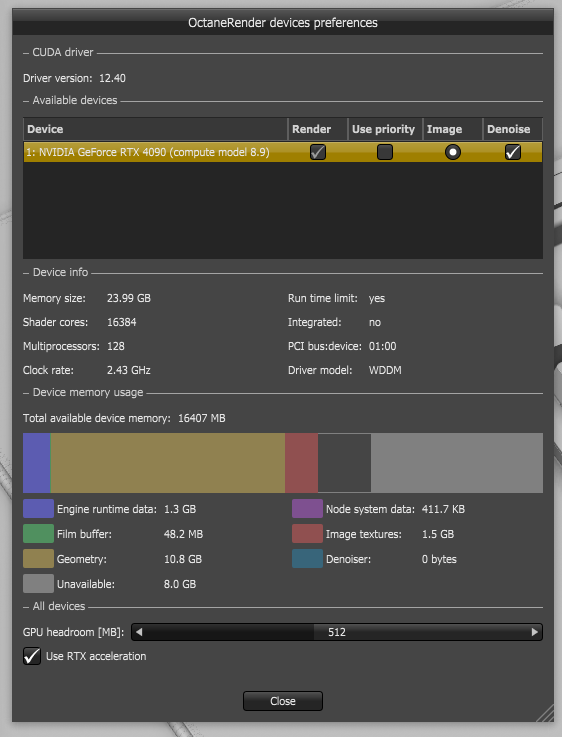

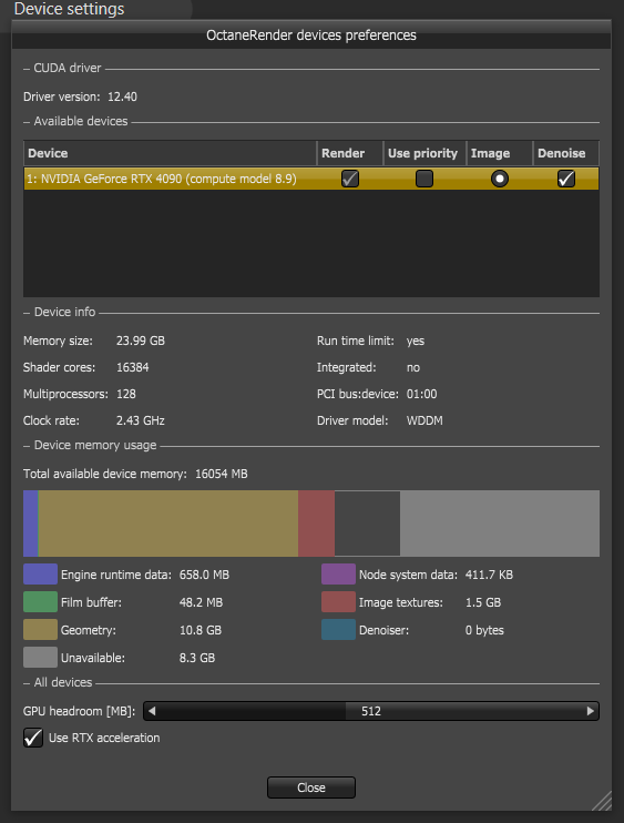

I can get similar results as OP with my 4090. When I first launch c4d after a fresh boot, Im told 4gb is unavailable, thats fine, I assume its for the OS in general. After launching any render though, this immediately changes to 8gb unavailable.
Changing the parallel and max tile samples only affects the engine runtime data size, not really the "unavailable" amount. With default values of 16 parallel and 32 max tiles I get this:
If I drop parallel in half then it doesnt have a significant impact
In fact I can crank them both and its only a couple of gigs different, but none of that falls under "unavailable"
Certainly If I have photoshop running with some images open and after effects in the background with a project open, then my unavailable ram goes up to 12gb. But im struggling to see how my unavailable gpu memory can be 8gb when many gpus only have that much in total.

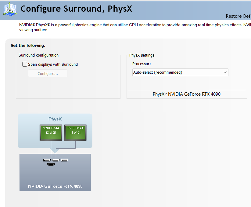

Try temporary disable one of your monitor and check result. What about Octane Standalone ? I have near 1GB lower result here.
