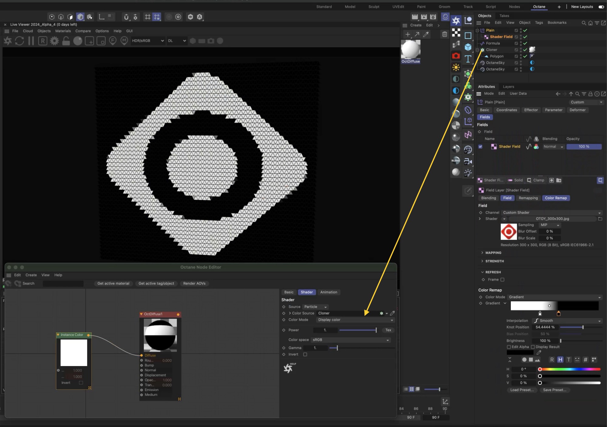

you can use an Octane Instance Color node, to get the colors from the MoGraph cloner in Render Instance, or Multi Instance mode.
Then use a Shader Field for coloring the clones as you like:
cio,
Beppe

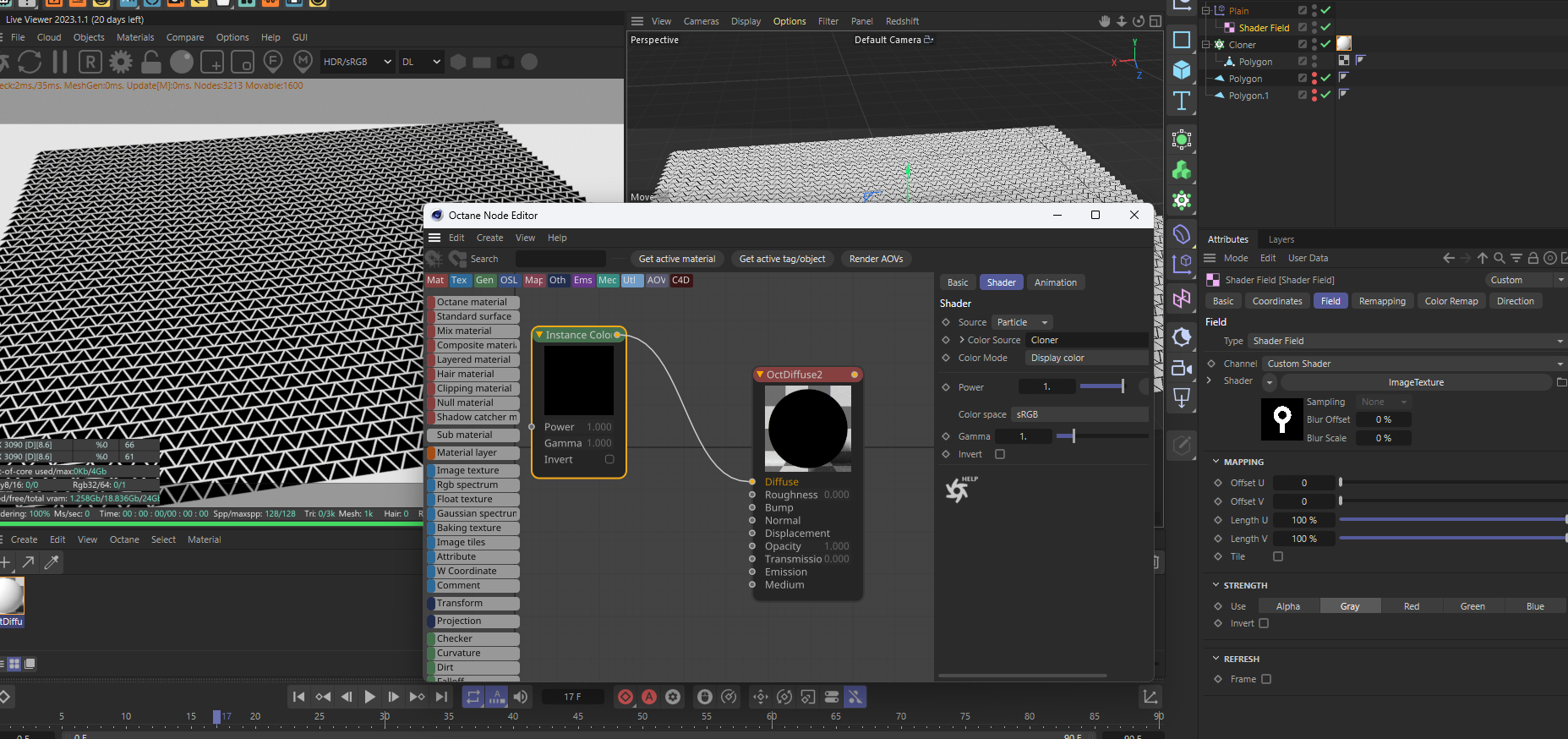

Thanks a lot, I don't understand why It doesn't work in my case...I show you below
Posts: 10643
in C4D Shader Field, avoid to use the Octane ImageTexture node, and load the bitmap directly in the shader slot.
ciao,
Beppe
