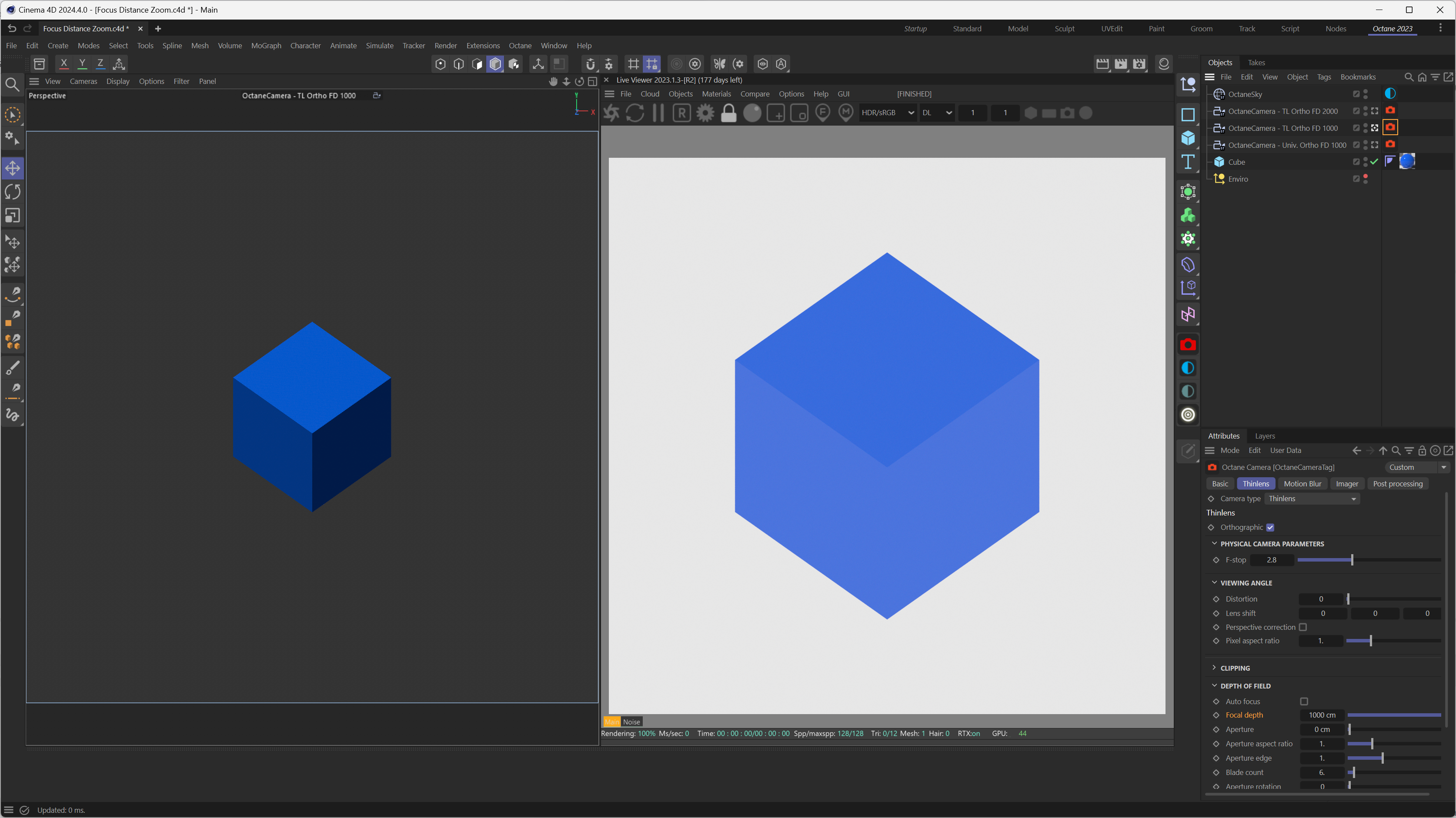

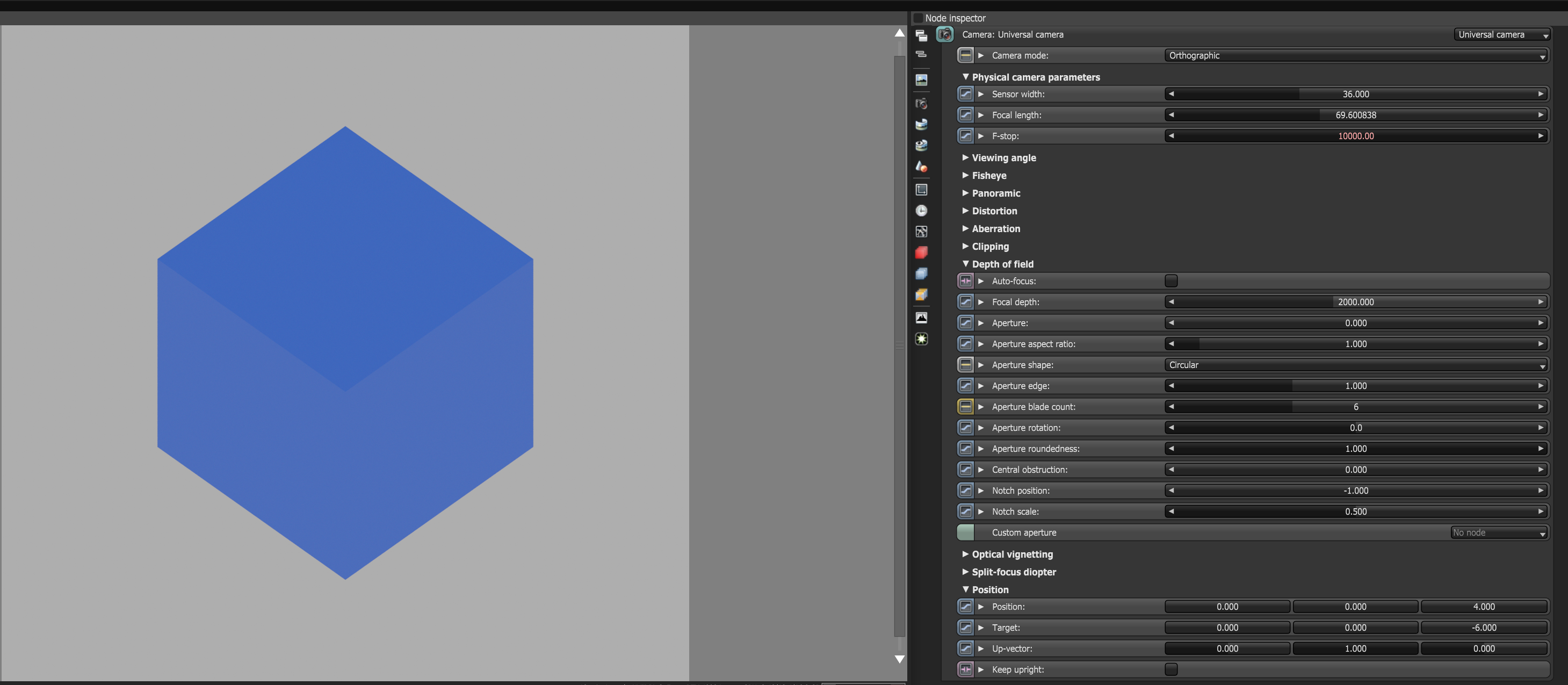

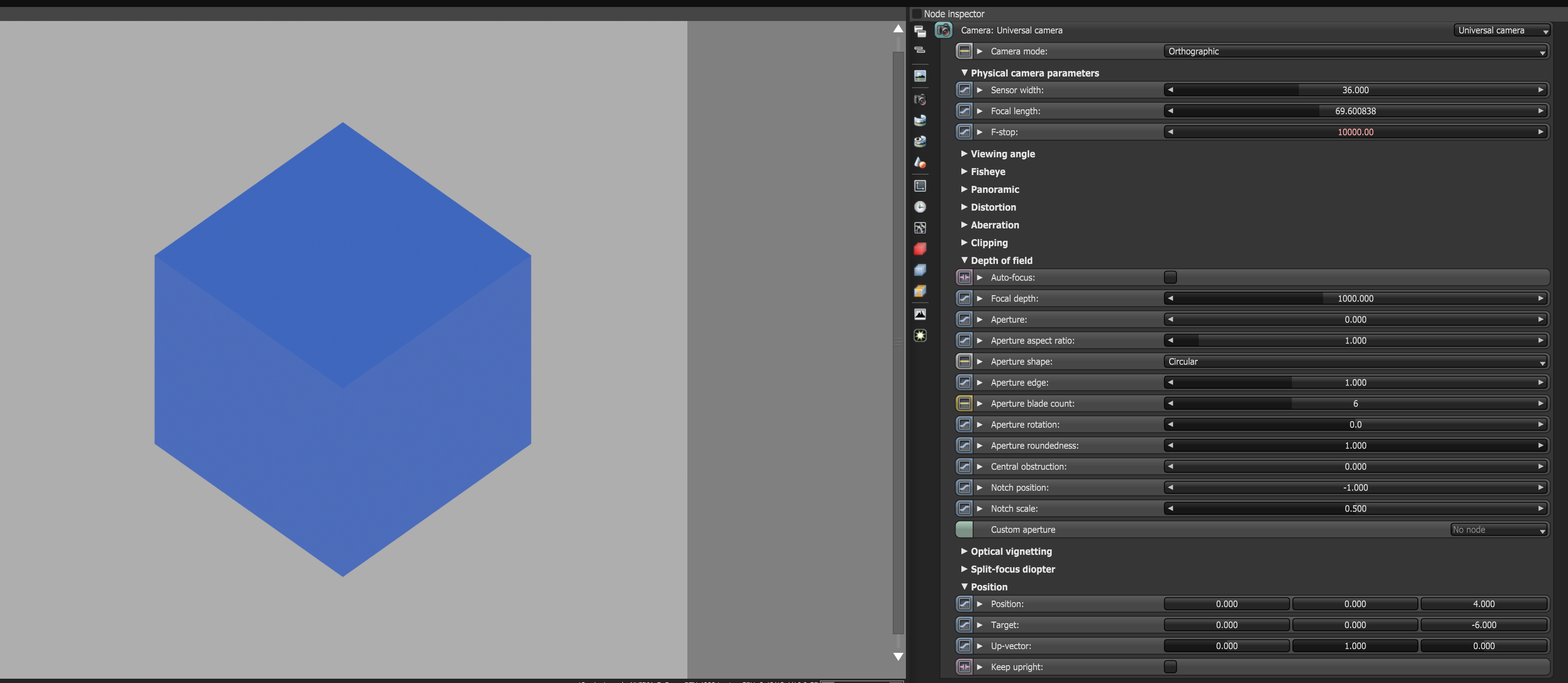

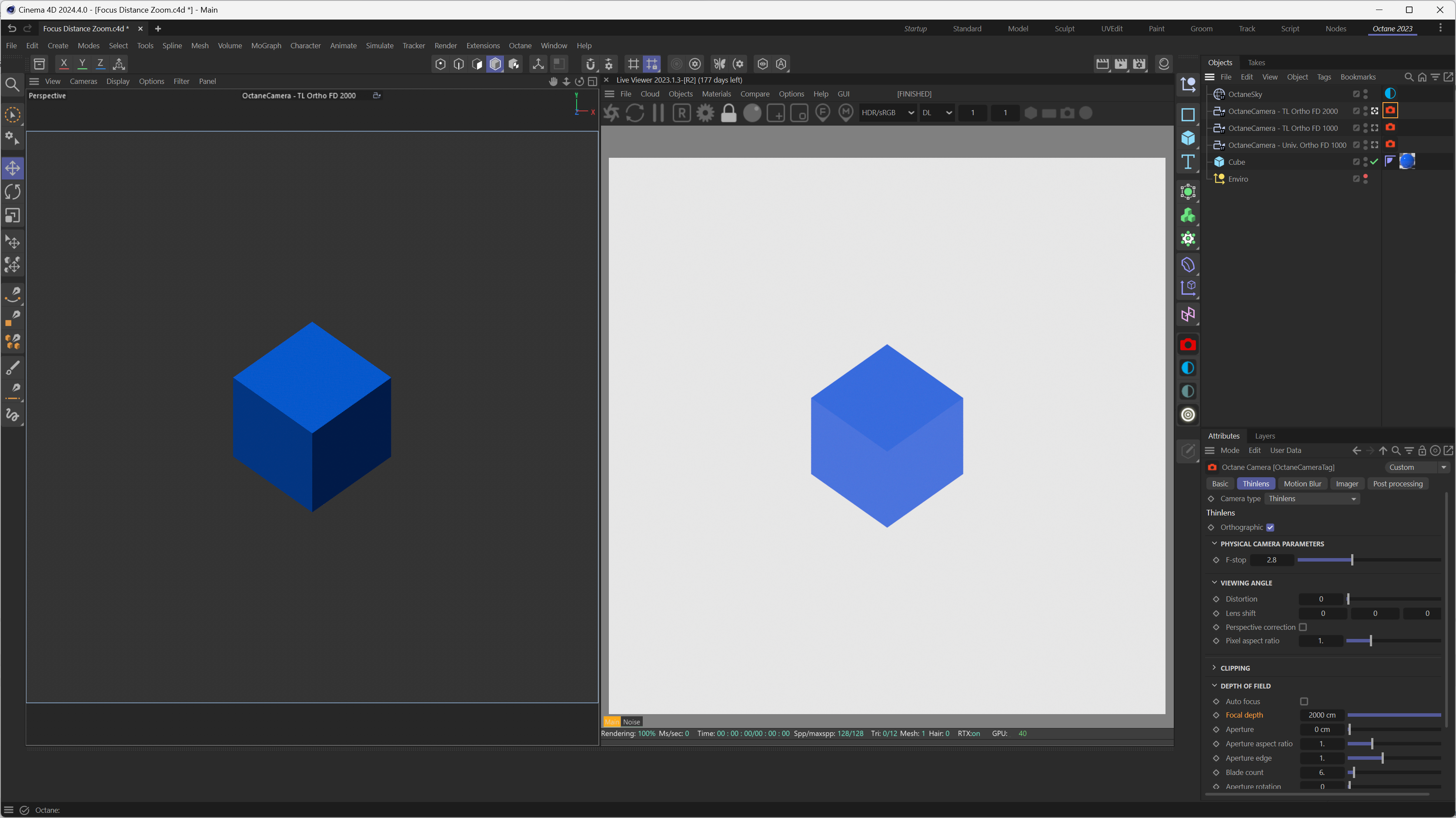

Focus Distance/Focal Depth appears to be incorrectly linked to the zoom factor in both the Thinlens and Universal cameras in Orthographic modes. This happens in the Live Viewer only (not in C4D's viewport). In Standalone, the Focal Depth does not affect the zoom factor (and it shouldn't). Having these linked makes it very difficult to manually focus while in Orthographic mode in C4D.
Please either unlink these settings or put in a checkbox (set on by default) to ignore focal depth if it needs to be that way for backwards compatibility or something.
Attached are screenshots and source files. I'm using C4D 2024.4 and Octane 2023.1.3 on Windows 11.
