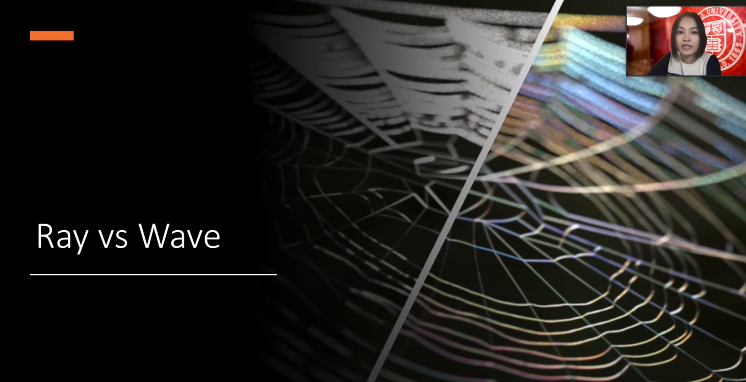

Would LOVE to someday soon see a "Wave Optics" kernel in Octane! Can't think of anything more scientifically accurate than the literal simulation of light waves (Interference, diffraction, and polarization)!

We don't need this new kernel but yes the path tracing kernel is supported by birefringence (polarization... included but future), diffraction (future but available on Cinema 4D)... materials. :)

Polarization is only 1/3 component of the physical properties of lightwave interaction. Interference and diffraction also should have a tremendous effect on how light wraps around an object.
And I would argue scientific accuracy has been a major part of OTOY's DNA (I've watched every "state of otoy" video under the sun!)
L1: Direct lighting
L2: Spectral Brigade R&D
L3: Spectral Pathtracing
L4: Photon Tracing
L4: PMC (Metropolis Light Transport)
L5: ???? Wave Optics perhaps?
I love a diversity of options that literally no one else offers!!

Does anyone have an in-render way to get similar wave effects that come from heat in the air? Similar to the OP reference.
