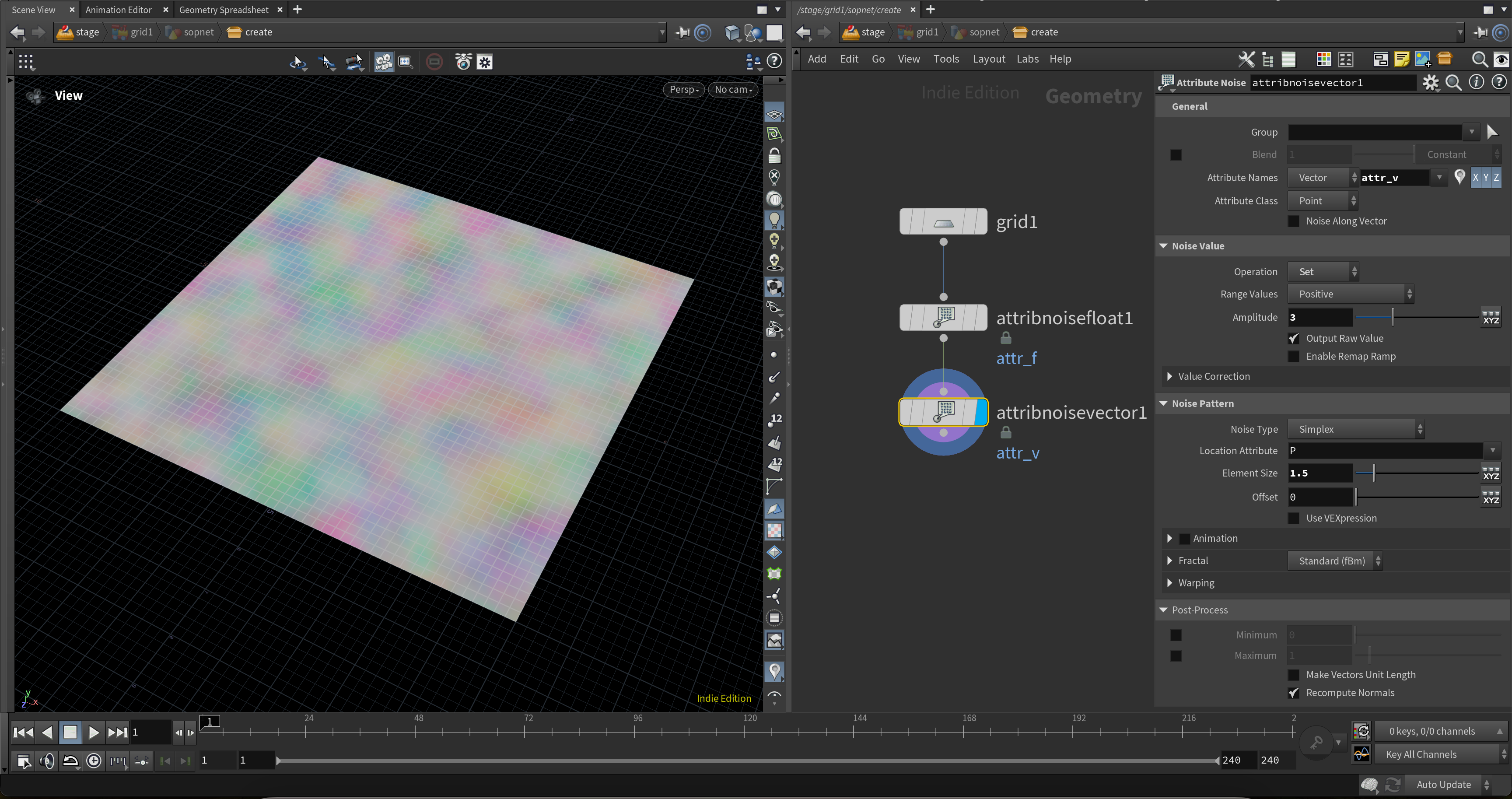

Let me show you a simple example of how I work with Octane.
In "sop create" I create a simple "grid". I create float and vector attributes for it.

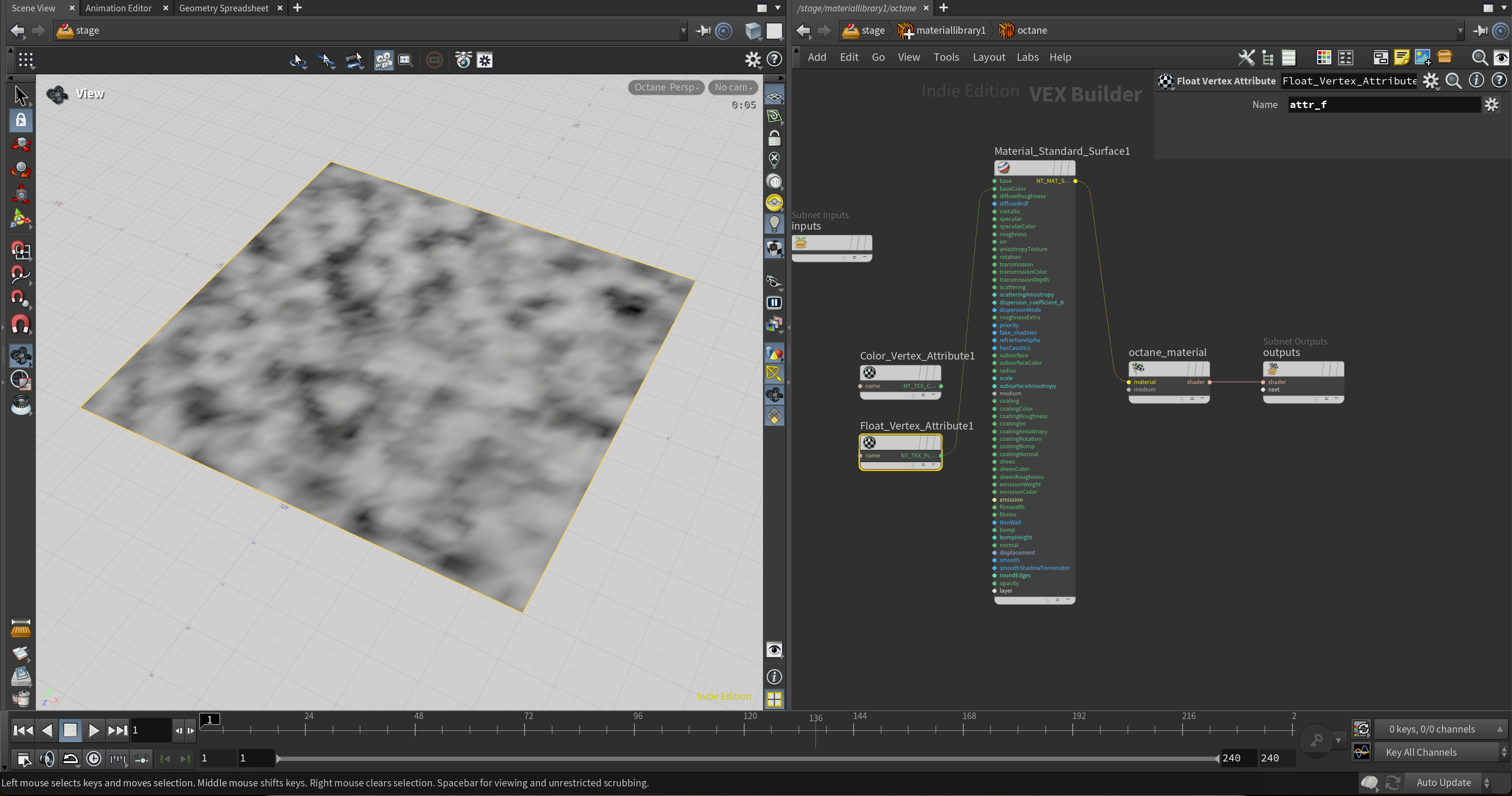

When I connect "float_vertex_attribute" to "baseColor", I can see in the viewer that the attributes are displayed in the material.
When I connect "color_vertex_attribute" to "baseColor", nothing happens.
Where am I making a mistake?

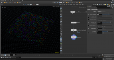

This is interesting. Same scene, but I added a "scatter" node after the grid.
Float attribute, which was displayed on the surface of the grid when rendering,
is no longer displayed on the points. What is the trick?
MacOS 15.7.1, M1 Max, Houdini 21, Octane 2025.4

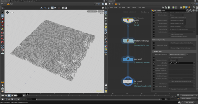

michaelskripin
Posts: 24
Joined: Mon Jul 20, 2020 4:58 pm
BK wrote:
Regarding the scatter issue, could you try using Texture instance color node and assign the *alpha4k_map.ppm* from the plugin's *tex* folder?
cheers
Hi BK,
I attached the "Texture instance color" with "alpha4k_map.ppm" to the "Base color" of the "Standard surface" node.
I'm not sure what the result should be, but nothing seems to be happening.
Update.
Texture instance color works as expected.
I must have made a mistake somewhere. My bad.
Random color works as expected too.
Attributes didn't work. I rechecked several times.
