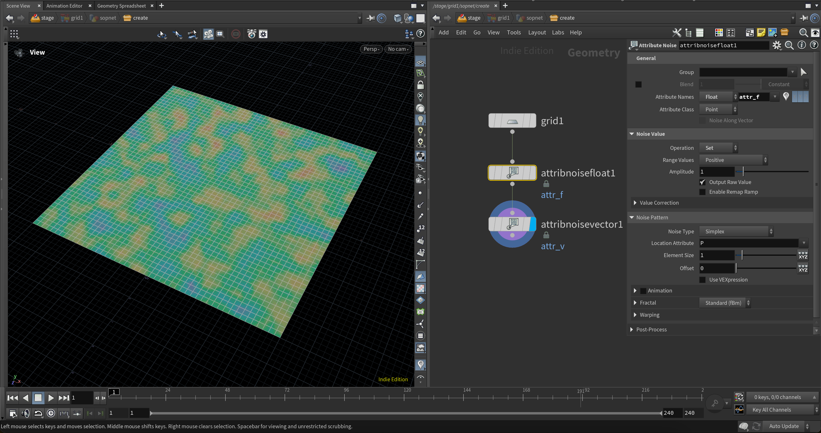

Let me show you a simple example of how I work with Octane.
In "sop create" I create a simple "grid". I create float and vector attributes for it.
When I connect "float_vertex_attribute" to "baseColor", I can see in the viewer that the attributes are displayed in the material.
When I connect "color_vertex_attribute" to "baseColor", nothing happens.
Where am I making a mistake?

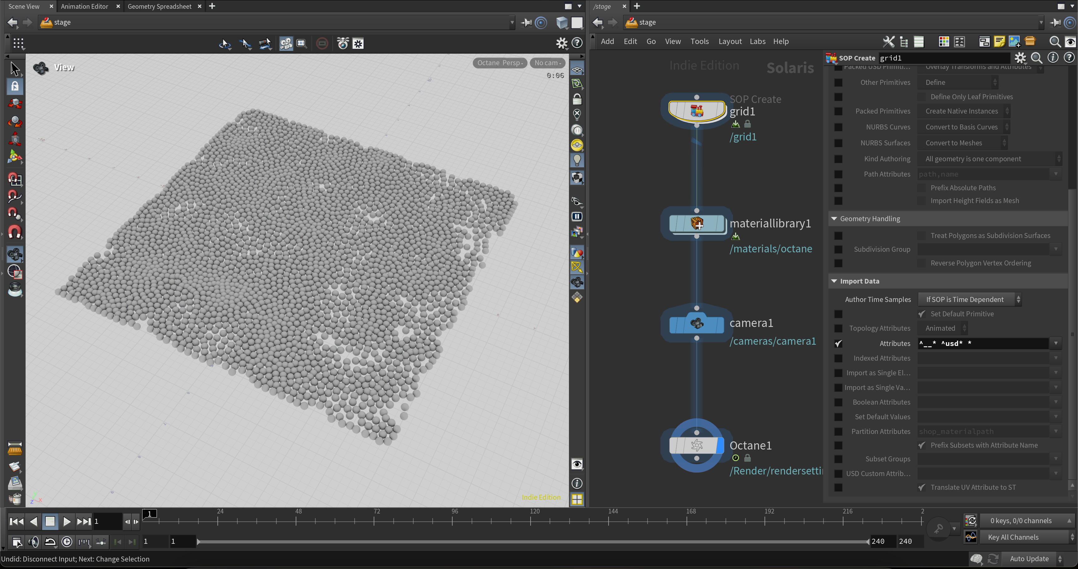

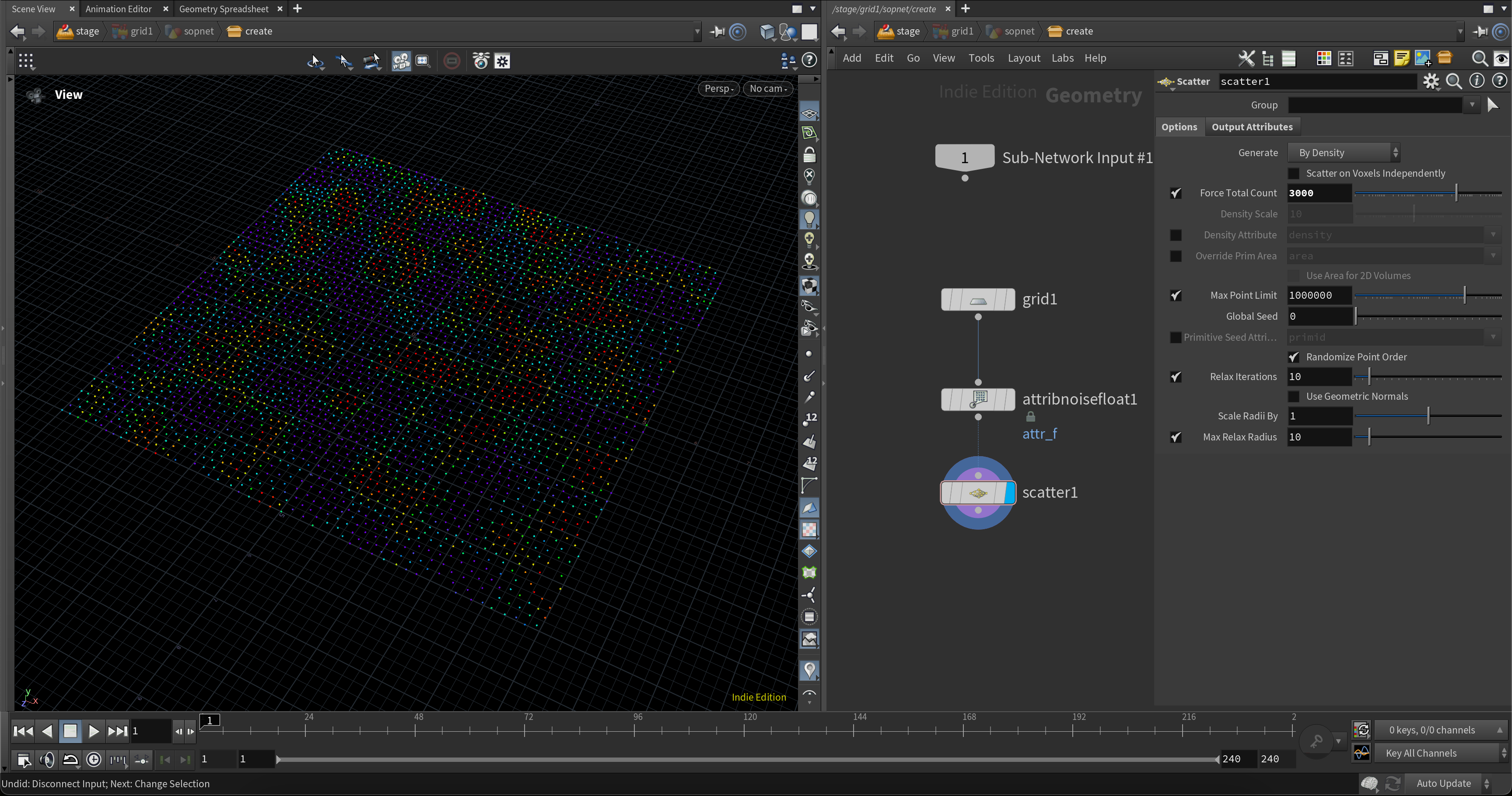

This is interesting. Same scene, but I added a "scatter" node after the grid.
Float attribute, which was displayed on the surface of the grid when rendering,
is no longer displayed on the points. What is the trick?
MacOS 26.5.1, M1 Max, Houdini 22, Octane 2026.5

Hi Michael,
Thank you for reporting this issue.
We have fixed this for the next release.
Regarding the scatter issue, could you try using Texture instance color node and assign the *alpha4k_map.ppm* from the plugin's *tex* folder?
cheers
Kind Regards
bk3d
