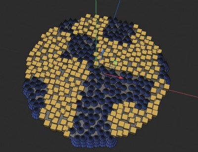

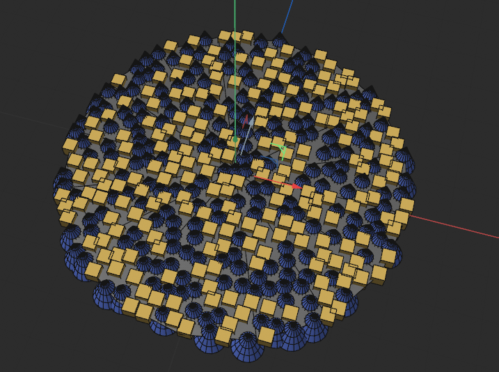

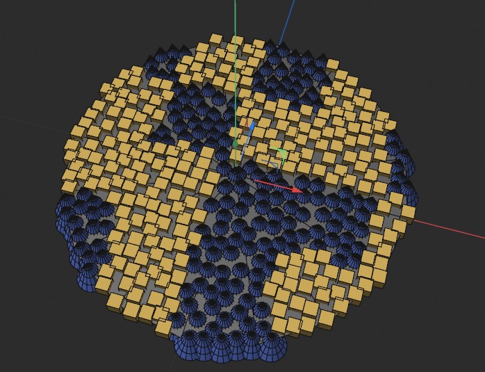

Yes, but distribution of individual objects by noise doesn't work in Poisson compared to Surface mode like this :
Surface mode :
Poisson mode :
Display type set to Object it doesn't update in realtime. Refresh viewport command is needed :
obj_mode.zip
(191.55 KiB) Downloaded 114 times
Architectural Visualizations http://www.archviz-4d.studio
