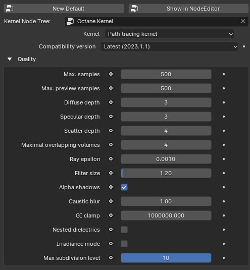

Render Settings
Render Settings

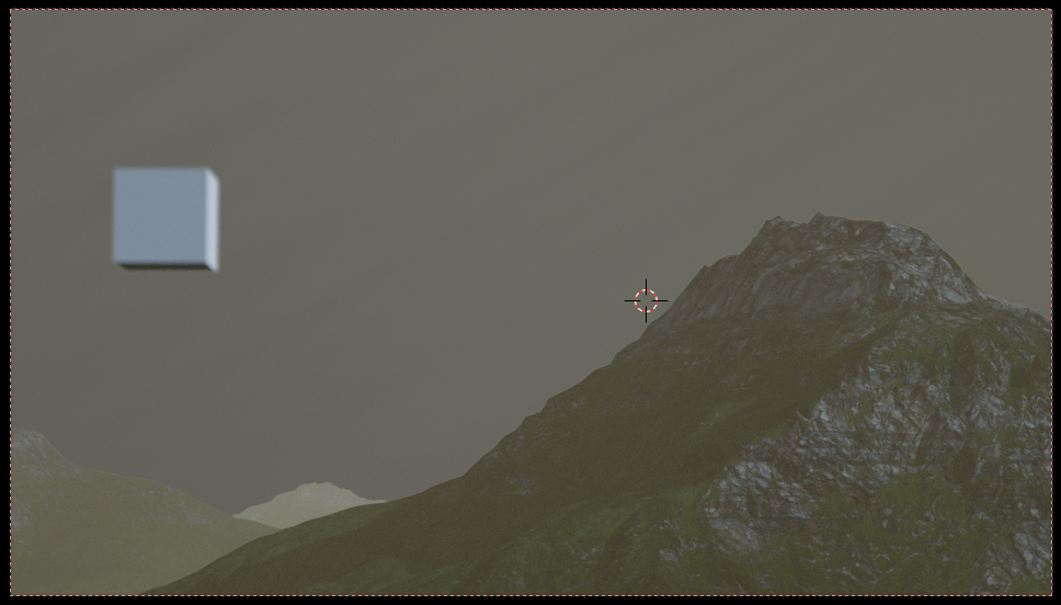

Density: .00018
Density: .00018
Density: .00017
Density: .00017

That's a tricky one. I tried a few things but couldn't find a solution. The cutoff happens in the fog box as well. Interestingly enough at the same value. Maybe some mathematical limitation that is reached?
