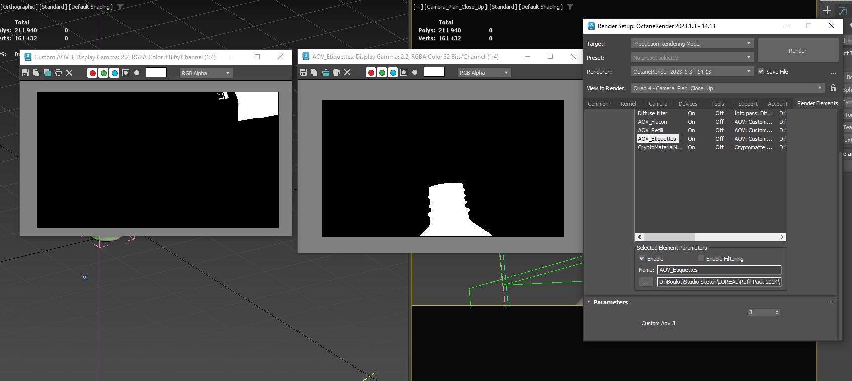

I have a scene with three custom AOV for three different materials, it works perfectly fine in the Octane Viewport but when I try to render a sequence with Max frame buffer, every AOV match the "custom AOV 1".
I've set each custom AOV with proper number in the render elements, please see the attached file : on the left Octane Viewport ported to the max frame buffer, on the right straight rendered from the Max frame buffer.

Hi remKa,remKa wrote:Hello,
Thank you in advance
Thank you for reporting this issue.
I could reproduce the problem, that's right, the custom AOV number is not read correctly, and only AOV 1 will be saved..
Sorry about that, that will be fixed in the next release
