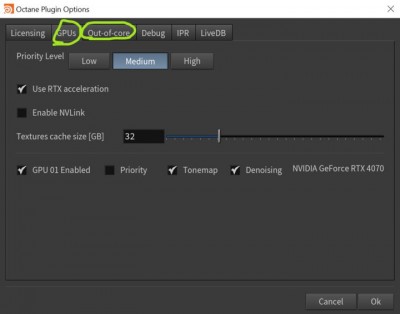

Everything is usually on default there except for "Priority Level", I always set it to "High" because I don't like when only 80% of the GPU is used by Octane. 1000% t's not overheating issue lol, Octane is pretty stable with the denoisers off, Intel denoiser is more stable btw if I compare them atm.ricky_otoy wrote:Can you also compare your 2 machines, the settings you had and if they were the same.
AND DON'T FORGET THAT I TURN OFF "DENOISE ON COMPLETION" OPTION FOR THE DENOISERS TOO. They are a little more stable with that option on btw. But they are still unstable compared to 2023 which works great.

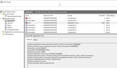

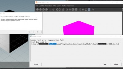

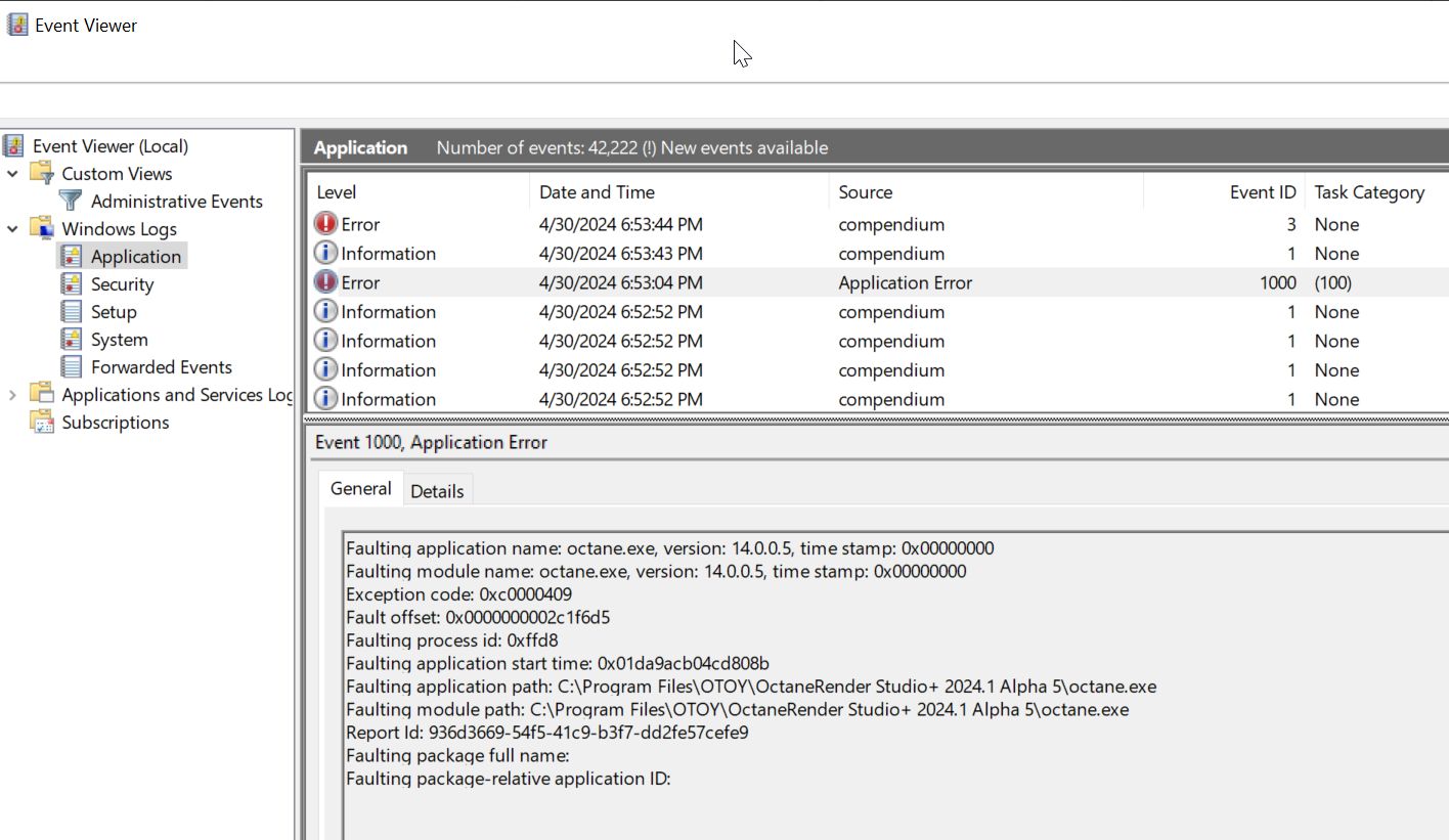

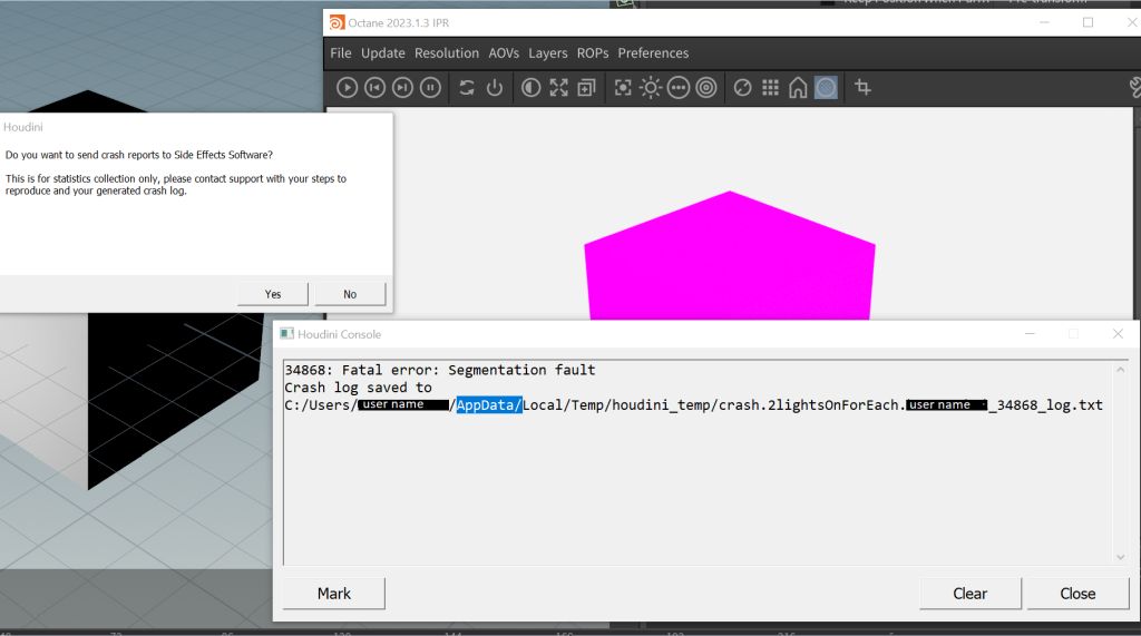

When you get a crash have a look at
Code: Select all
C:/Users/<user.name>/AppData/Local/Temp/houdini_temp/
