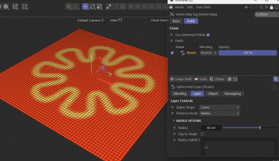

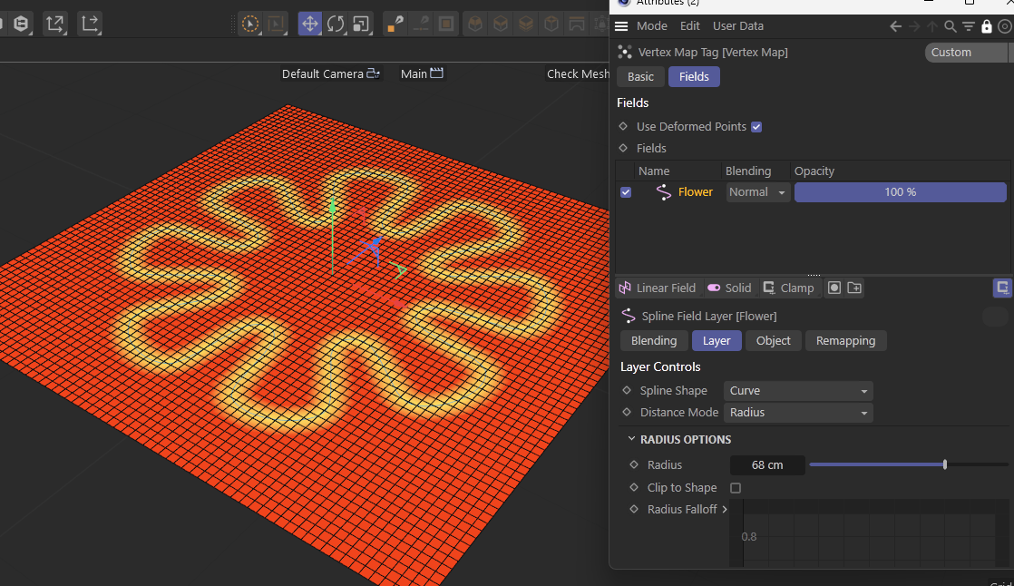

Janmansilver wrote:I would like to drive eg opacity of a spline rendered as hair via a vertex map, is this possible?
You can try to set vertex map to fields and use spline as field with radius :
After that use this vertex as opacity in Octane nodes

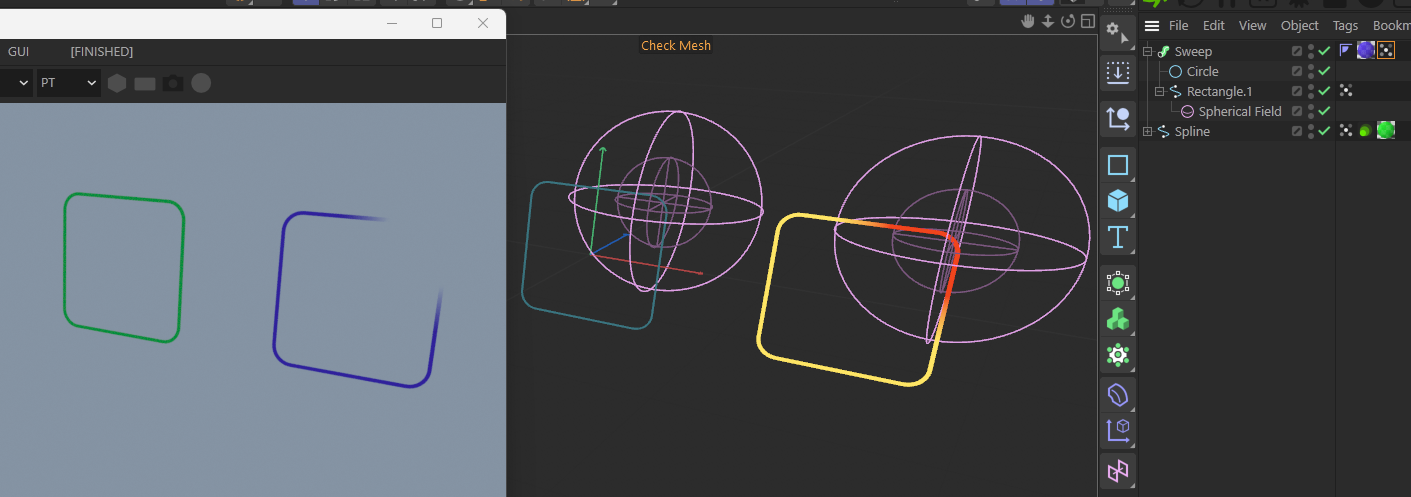

SSmolak
Posts: 1157
Joined: Sat Feb 07, 2015 5:41 pm
Location: Poland
Possible but it looks like famous word "limitation" should be used for weights on splines. Use Sweep instead with small radius :
oct_spline_weight.zip
(105.8 KiB) Downloaded 114 times
