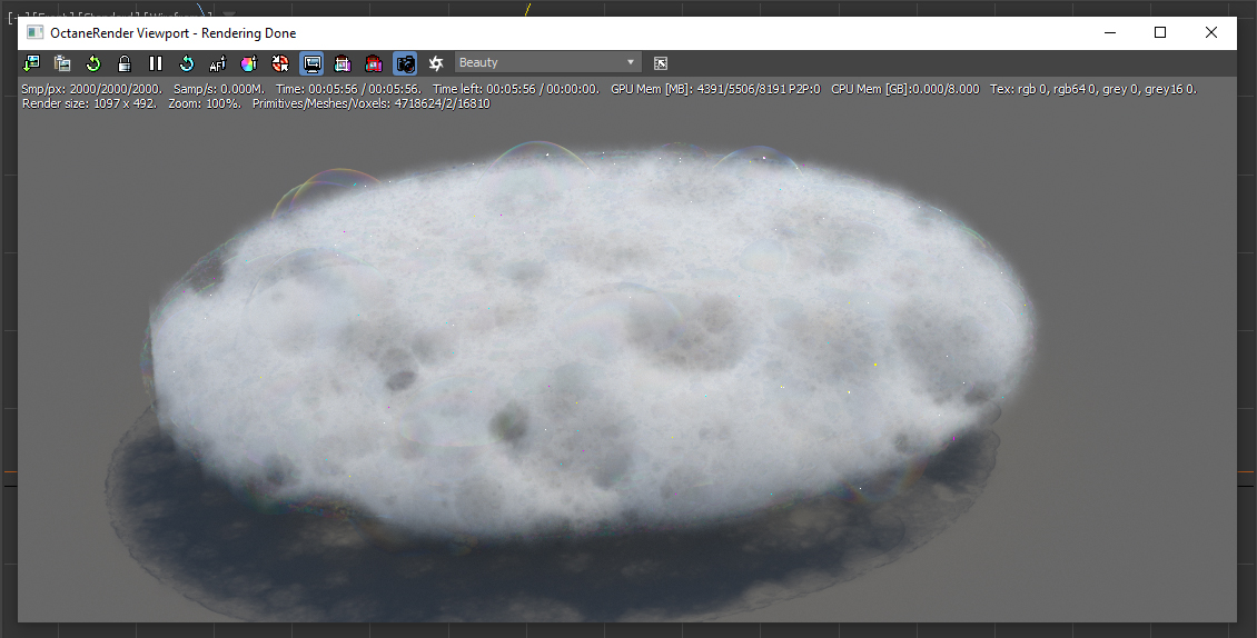

anybody succeed to recreate this in max ?
HHbomb
Posts: 1383
anybody succeed to recreate the foam material in max ? I don't even know how to create the volume at the beginning ! :lol: :lol: :lol:
https://www.youtube.com/watch?v=sdms7YdYh4Q ( Silverwing rocks )
thanks

Hello,
Yes someone did it here : https://www.facebook.com/groups/stackth ... 033540548/
But there is still something missing that prevent the texture to follow the volume when it moves.
Octane devs should look into it :)

HHbomb wrote:Hi,
thanks
Hi HHbomb,
viewtopic.php?f=27&t=81392&p=422758&hil ... me#p422758
Regards
Paride

remKa wrote:Hello,
Hi remka,
That should be resolved by using world space instead of object space. Have you tried it?
Regards
Paride

Hi, Thanks Paride !
I was searching in Octane Geometry properties > Mesh to volume SDF...
Now I have a volume ( need to have Quick update mode to render )
How can I connect noise to density ?
paride4331
Posts: 3861
I'm attempting to determine if freezing the textures resolves the issue, but I'm uncertain.
I did it quickly, it will need to be properly adjusted, but the material is there.
Regards
Paride

Hi Paride !
You are sooo kind to take time to help !
I was trying to use "volume medium" and not "std volume medium".... :roll:
and nothing was corresponding ( obviously )
why I didn't see "Std volume medium" is something I'll discuss with my ophthalmologist.
Thank you very much !
Next is the sliding texture :D
