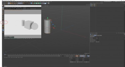

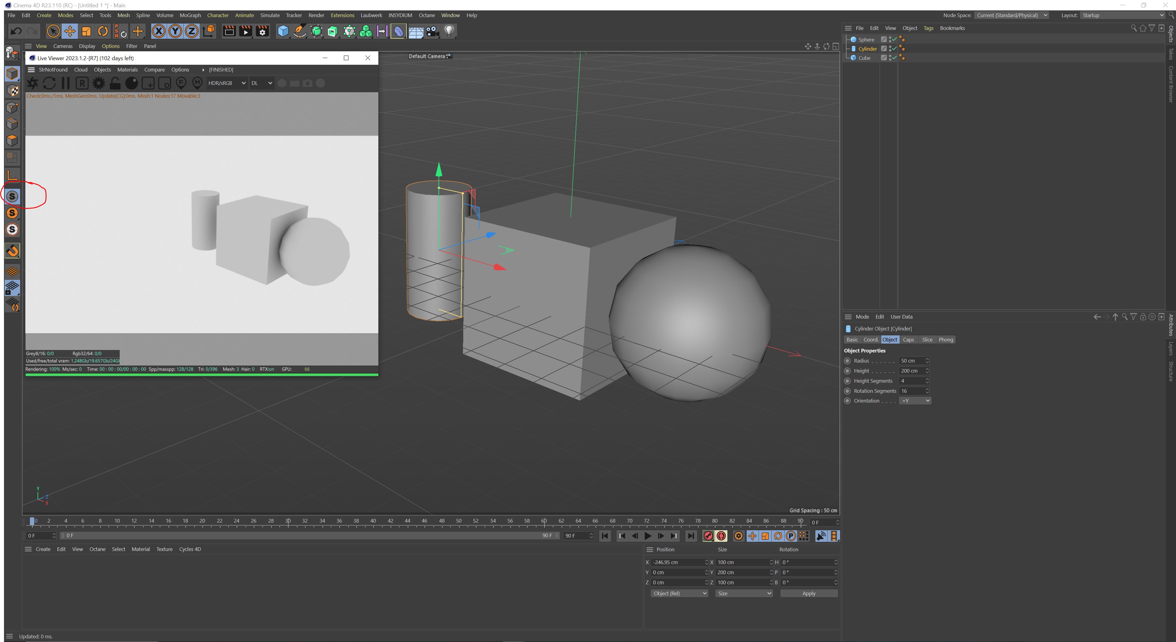

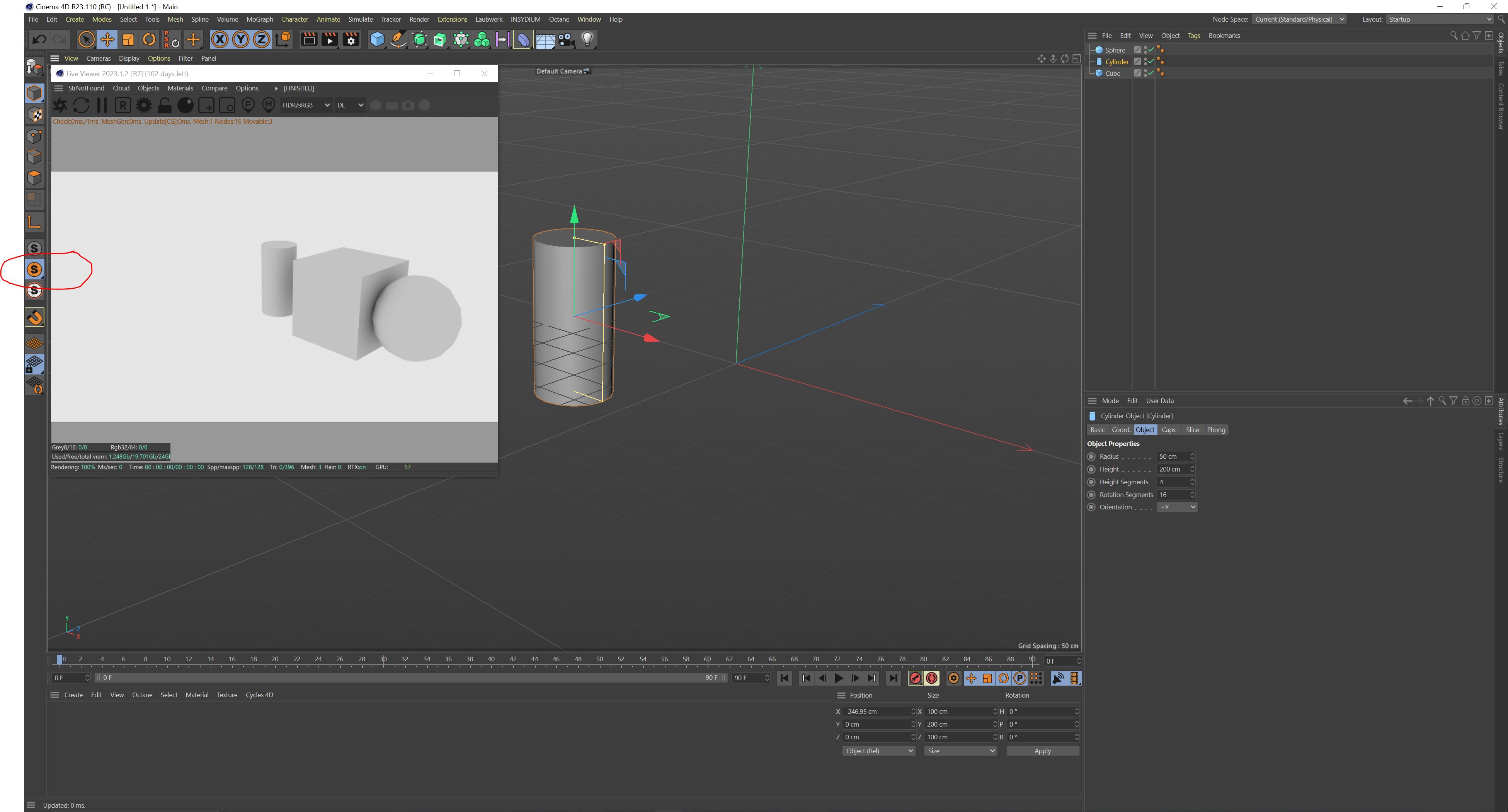

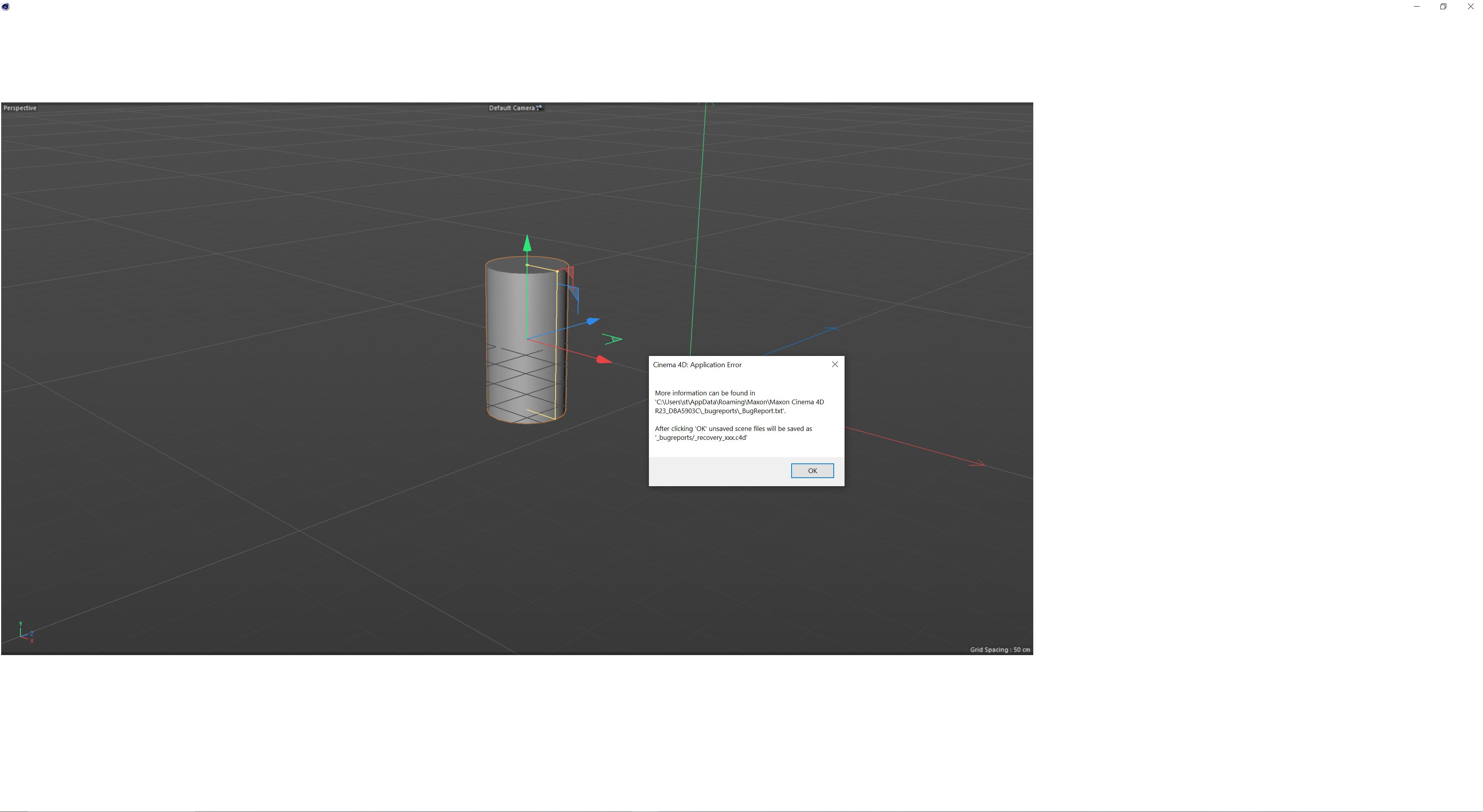

Hi Aoktar, the R7 doesn't solve the Solo problem, on R6 nothing is visible on Solo mode, on R7 all are visibile on solo mode, In addition, there is a serious stability problem when selecting a C4D interface layout, both for standard setup and personalized ones, C4D crashes immediately.It doesn't crash only on standart e startup layout.

the problem of crash was due to a not correct video driver installation, a clean installation solved the problem.[/quote]

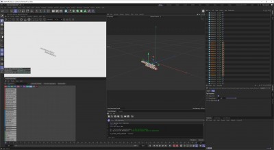

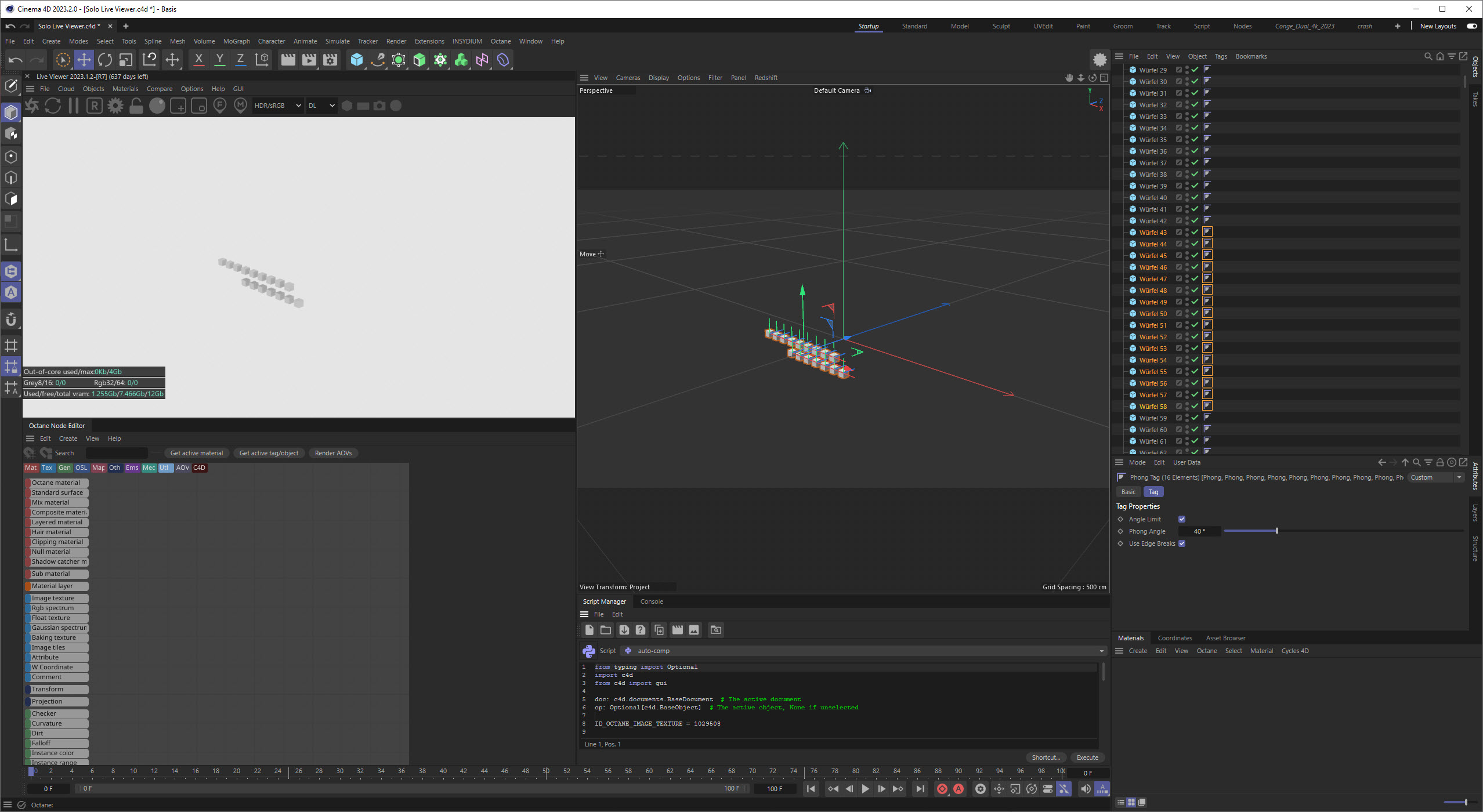

Please have a look into the attached file: I cloned a cube in a grid 10x10x10. When I select one of them and solo it nothing is rendered in the live viewer.

Can I see a full screen capture of your C4D?
