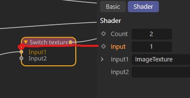

Can you add input selection to Switch node input pins ?

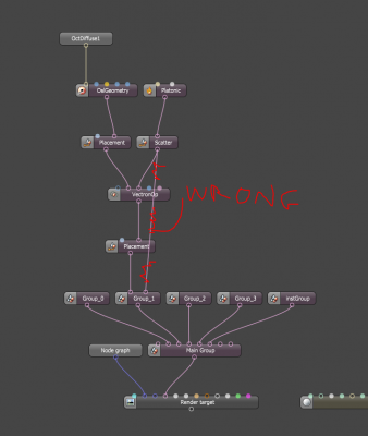

Vectron operators between mesh to SDF and vectron is being overridden by original mesh to SDF.
[youtube]https://youtu.be/JiTKmSBXDrA[/youtube]
@Ahmet can you please have a look ? This feature would be awesome and unique. :)

scaprendering wrote:Vectron operators between mesh to SDF and vectron is being overridden by original mesh to SDF.
SDFBoole.zip
Voxel size of mesh_sdf is affecting the vectron. It's happening in SA also, so ask in SA forums.

Undo in node editor doesn't work if texture is dragged directly to image texture node. It works fine if texture is dragged to "edit controls" panel.
It switch to previous material in material manager instead.

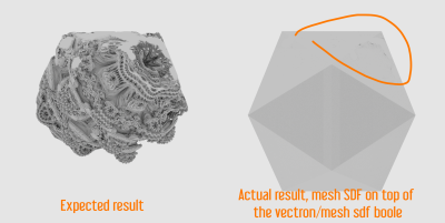

scaprendering
Posts: 9
Joined: Fri Dec 21, 2018 2:03 pm
In standalone it works great, but in C4D the issue is that the SDF is being displayed twice, before the boole and after the boole.
Once the SDF has been booled, it should no connect back to group_1:
Expected Behavior: After applying the boolean operation (intersection or subtraction), only the resultant mesh (the modified SDF) should be visible in the render.
Actual Behavior: The original mesh SDF remains visible in the final render alongside the boolean result, leading to an incorrect visual outcome where both the original and modified meshes overlap.
This issue seems to be a bug as the expectation with boolean operations is to only display the modified mesh resulting from the operation, not the original unmodified mesh. It can be fixed by opening Octane node graph and manually disconnect the volume SDF fo group_01 but when Octane updates the scene it reconnects back.
