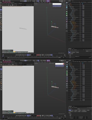

freeter_e
Posts: 40
Joined: Fri Apr 05, 2019 9:12 pm
feedback:
Cinema 4D 2024.2.0
Octane 2023.1.2-[R6]
viewport solo, in some scenarios, not work fine
Octane 2023.1-[R7]
test, it's ok
