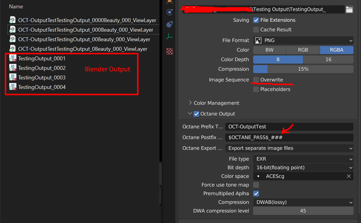

I can't make Octane work reliably for saving images now. AOVs are ignoring some settings and Octane is pretty much ignoring settings in the Octane Output.
It creates bizzar file names.

Be sure to specify the needed strings, by the way (normally those are there by default).

This is still a bug.
I'm using the string as suggested, but the frame #s are not saving, and each frame is overwriting the previous frame when rendering more than 1 frame.

I did a little test with 4 Frames, I turned off the checkbox that says overwrite.
And now I do get 4 outputs, but the frame # is still missing, instead it keeps adding a zero for each new frame, and if I had a simple 150 frame animation that would get ridiculous (not to mention, useless).
