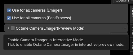

- the Imager checkbox has unnecessary doubled descriptions. (Enable Camera Imager... / Tick to enable).
These will be fixed in the coming version.

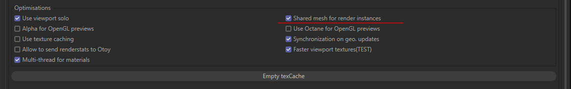

About using shared surface in C4D/Octane, I may miss something. But is there an option as to the "shared surface" in C4D and Octane? If so, please let me know. Thanks!

In C4D naming and description looks different than in Blender but names are kind of similar:
I couldn't find this in Standalone. I thought it was there but can't find this anymore.

I think the C4D option is a different one.
