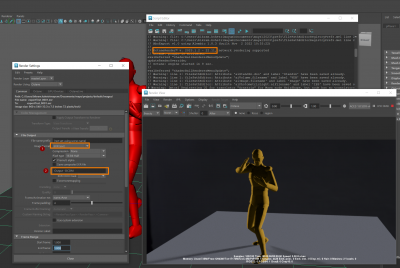

Due to the native Image Maya buffer, we have to set the image format as EXR then the Octane View would work from Common tab>OCIO color space as the image below:
If the image format is PNG, the view works from Imager>view
Note, that you may need to Refresh the IPR if the image formats are changed!
