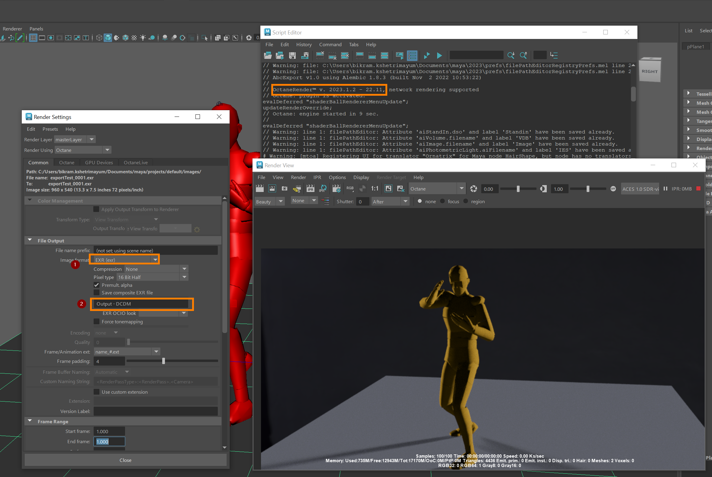

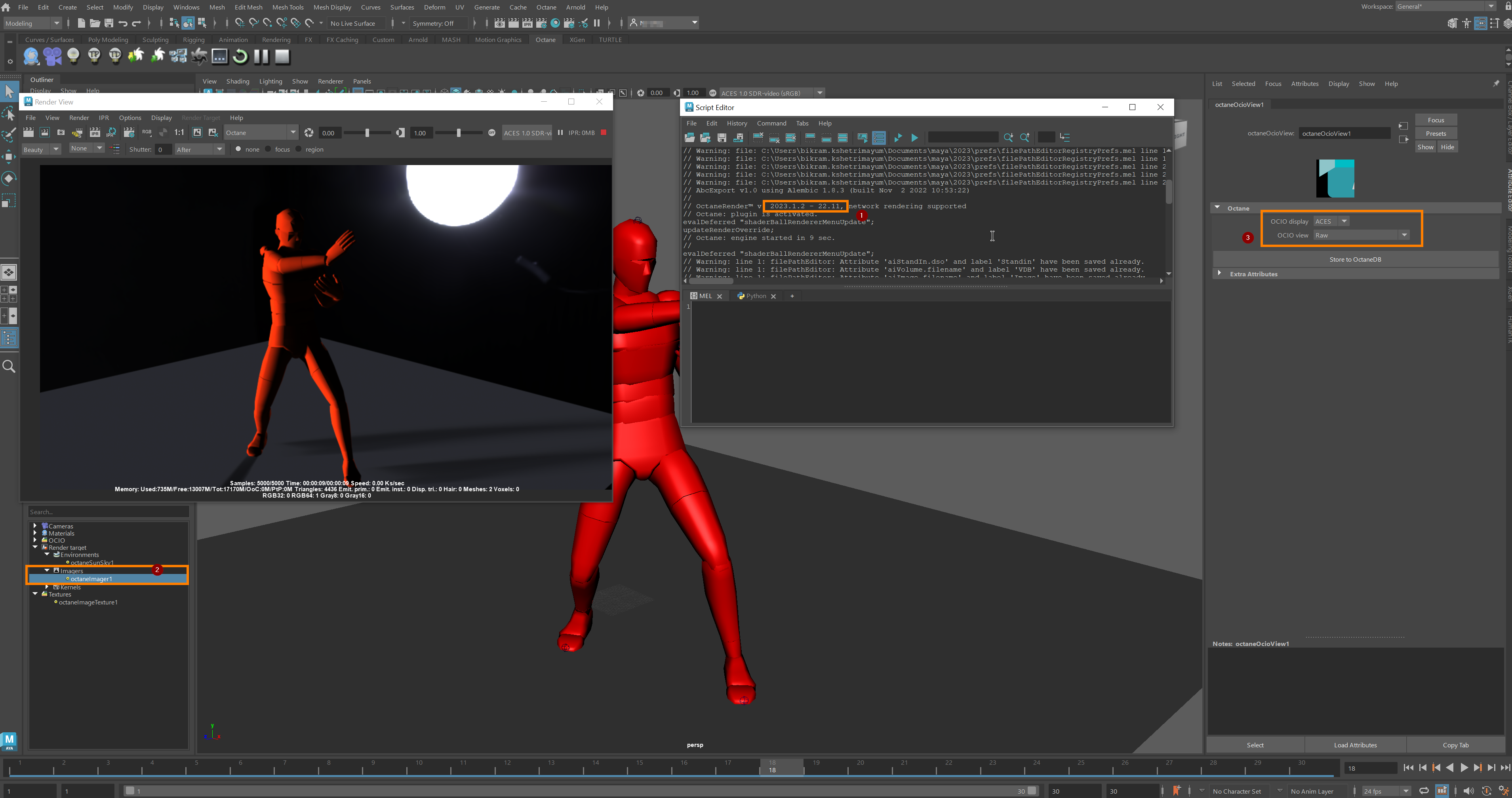

Hi nospitters,
It looks like ACES is working correctly when we test.
Due to the native Image Maya buffer, we have to set the image format as EXR then the Octane View would work from Common tab>OCIO color space as the image below:
If the image format is PNG, the view works from Imager>view
Note, that you may need to Refresh the IPR if the image formats are changed!
cheers
Kind Regards
bk3d
