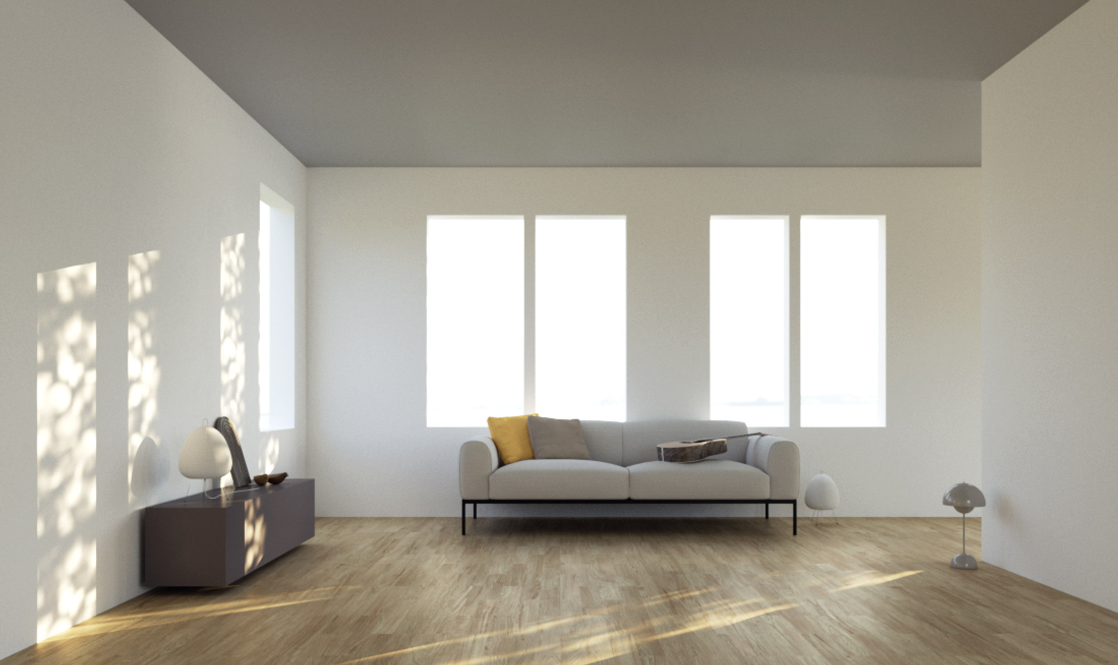

I have tried to learn new things lately. Next thing I would want to learn is using gobos.
I just saw one pic made with Octane that has a really nice gobo-shadows on the wall.
1. How to achieve those crisp and detailed shadows?
2. Should I use an area light with a gobo for the sun or should I use Environment:Daylight and block the sun with a Gobo-object?
3. Anything I do end up in really blurry shadows
Thanks for tips,
Lewis

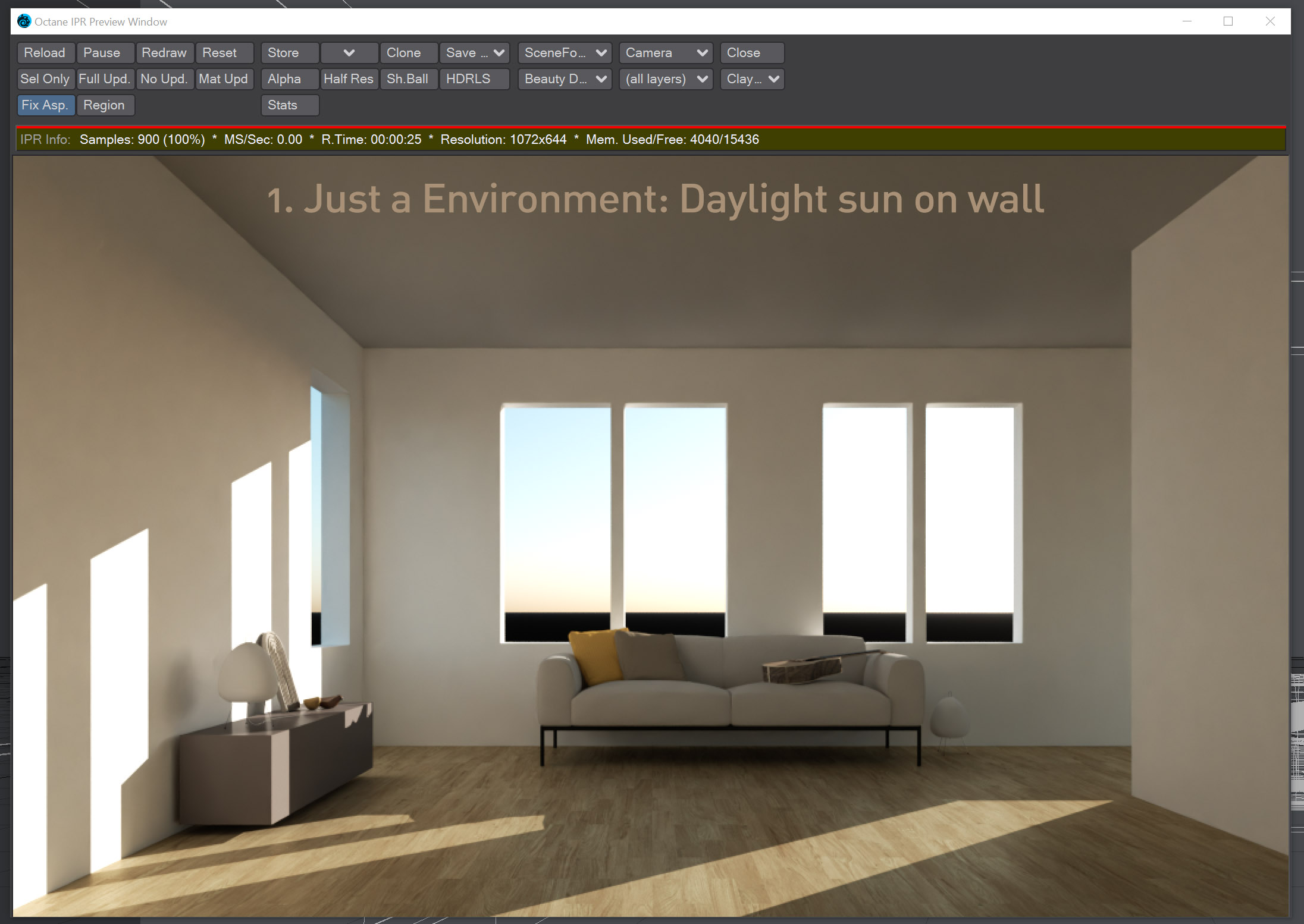

After testing I was able to produce a type of gobo I was after.
Not very good quality yet but at least I learned something.
In a quick scene test attached I used a HDRI as a diffuse light and I added a "spotlight" with a gobo to get detailed sun/shadows on the wall.
I would love to do this with just a Environment:Daylight but I don´t think it´s possible...

I know that smaller light creates sharper shadows. But my question was more about the following:
I attached two pics.
Can I add gobo texture somehow to just the Daylight sun without needing to add any "sun blocking" object to the scene?
So the sun light would be "blocked" even when I move the sun.
