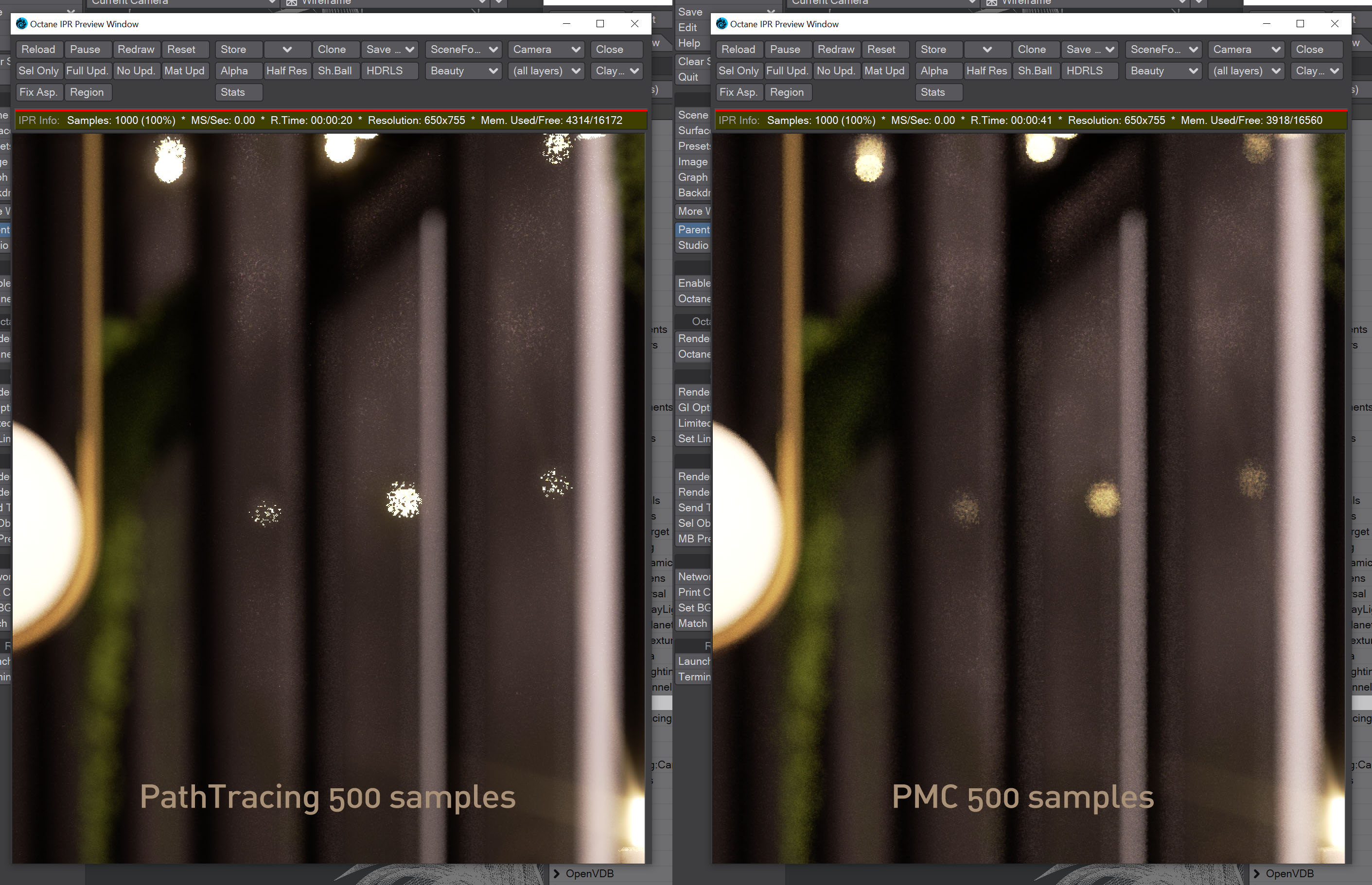

I have made an interior that has lots of lights and some reflective surfaces. Problem is that whatever I do I don´t seem to get nice clean reflections. Light reflections are all pixelated and bad looking. (See attachments.)
I used the wine glass spot as an example.

Postby Builtdown » Wed Jan 17, 2024 9:59 pm
Builtdown Wed Jan 17, 2024 9:59 pm
I still think I did everything right and no bokeh map.
But good that you mentioned changing kernel. Because that was what really worked!
PMC kernel did exactly what I was looking after. I have never used PMC with interior pics but now it seemed to be the answer.
I attached some examples with bad PathTracing result and PMC result with approx. same time rendering.

Postby elsksa » Thu Jan 18, 2024 6:20 pm
elsksa Thu Jan 18, 2024 6:20 pm
That's great looking, indeed. Glad it helped.
The practicality of Kernel choices in Octane. PMC also helps with volumetric scenes and Photon Tracing principally with caustics.
Comes handy when needed.

Postby Builtdown » Tue Jan 23, 2024 9:30 am
Builtdown Tue Jan 23, 2024 9:30 am
Thanks for the tip.
I wasn´t using Denoiser. Now with it it definetly made it look better.
PMC still more realistic but takes much more time compared to PT+Denoiser.
