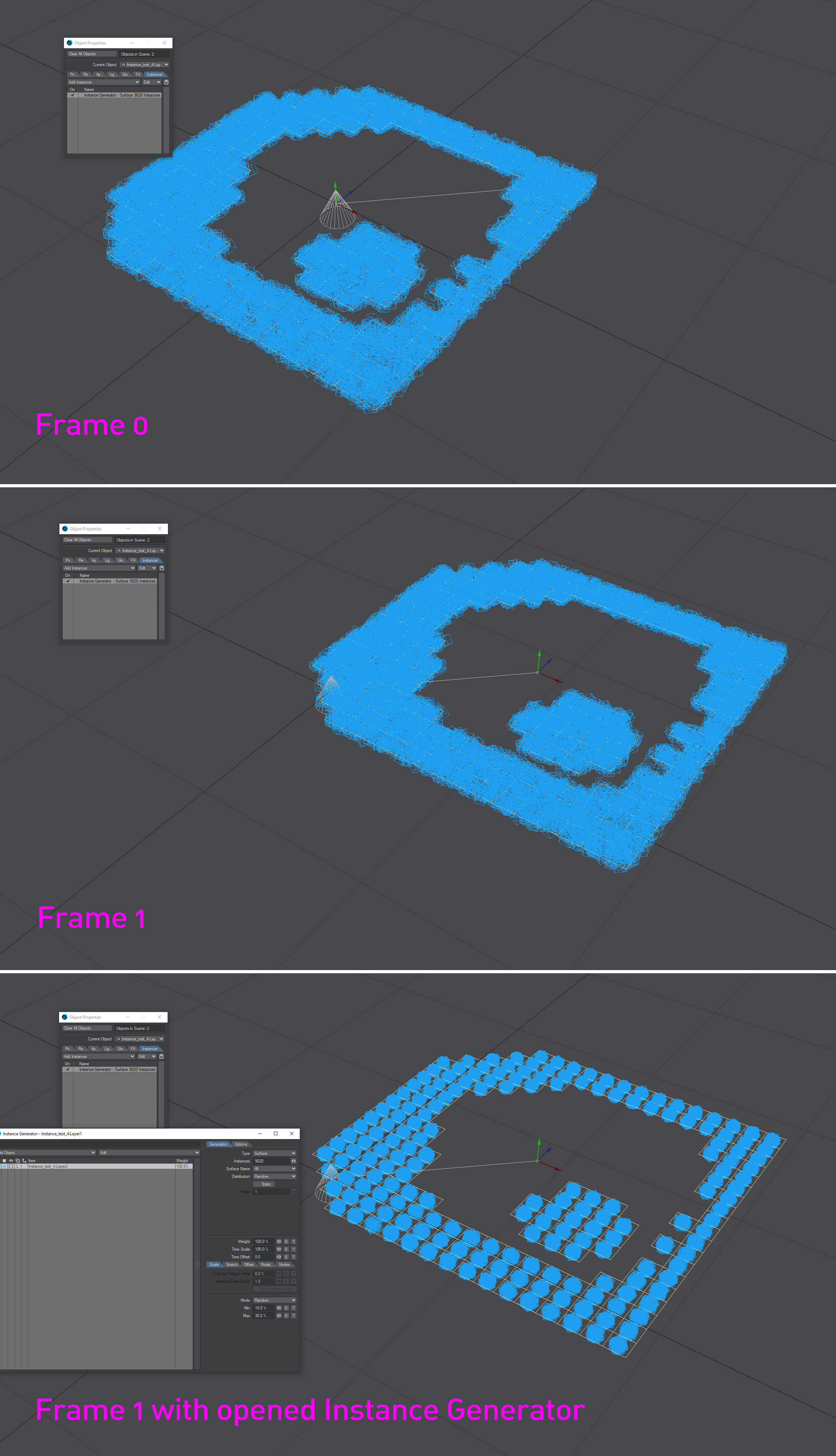

My work requires lots of use of instancer. Now with v2023 it seems to be broken or then I don´t know something about it.
This is how I used it before (v11):
I had an object (like a yard of a house) and an object like a bush. For yard I put on Instance Generator. In that I add the bush-object. Set it to Local, put in on Surface and then I was able to set Scale, Rotation, etc.
Now with v2023 when I do the same, the Instance Generator doesn´t work. The bushes are set in really weirdly manner, especially if I close and REOPEN Instance Generator. And move the object in between.
Does this happen to others also?
If you can test this, please try to also move the objects while testing Instancer. It also affects the instancer.
This is horrible because I will lose my customers if I cannot do the jobs because of this!!

I attached model and a scene:
Frame 0 works well when you go to Instance Editor to change something.
Frame 1 with moved object you go to Instance Editor and change something. Then comes the trouble (at least for me)

Yes, indeed, I got the same result as you - but if I click on the DISTRIBUTION menu and select the RANDOM method - everything returns to normal. LW2023.
