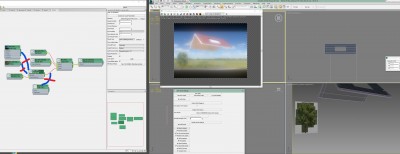

Hi Rik,
-The AOV system is more powerful and flexible than the post processing, so it's probably preferable. It is also in active development, so new layers will be added progressively in new versions.
-The image layer has no transformation options. The scaling I added is specific to 3dsMax, to try to match the background image that can be added to a 3dsMax viewport.
This resize is quite limited, and is done 'by hand' in the CPU, so has a limited quality.. It would be preferable to set your screen resolution for your project, and prepare an image with the matching size, and select None in the resize option.
For other effects, you should be able to add layers to adjust the image layer, but they should be all inside a 'layer group' together with the image layer..
-In Version 2024, there is just what you need : an Octane Texture layer, so you can use a RGB image texture, with all the usual transformations and effects.
I'll try to release the current version 2024 in the coming week.
[EDIT: version 2024.1-Alpha 1 released here: viewtopic.php?f=80&t=82802]

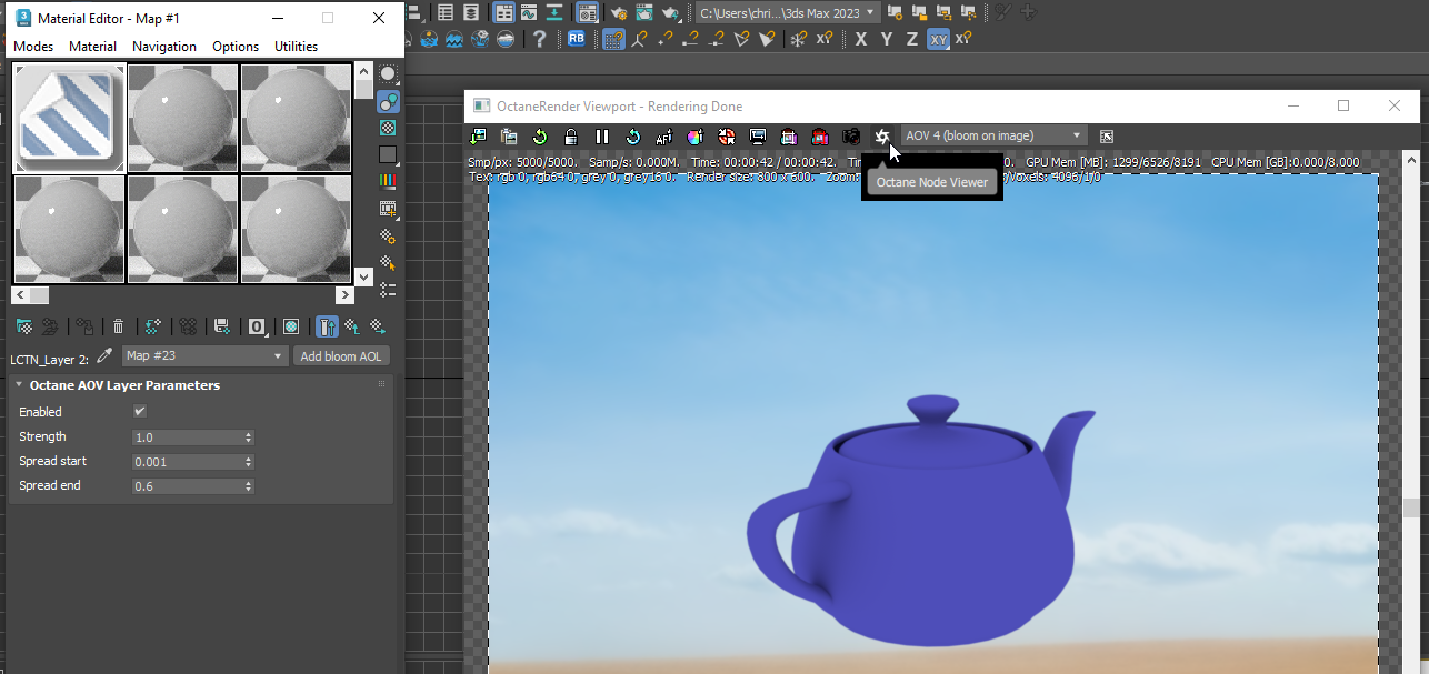

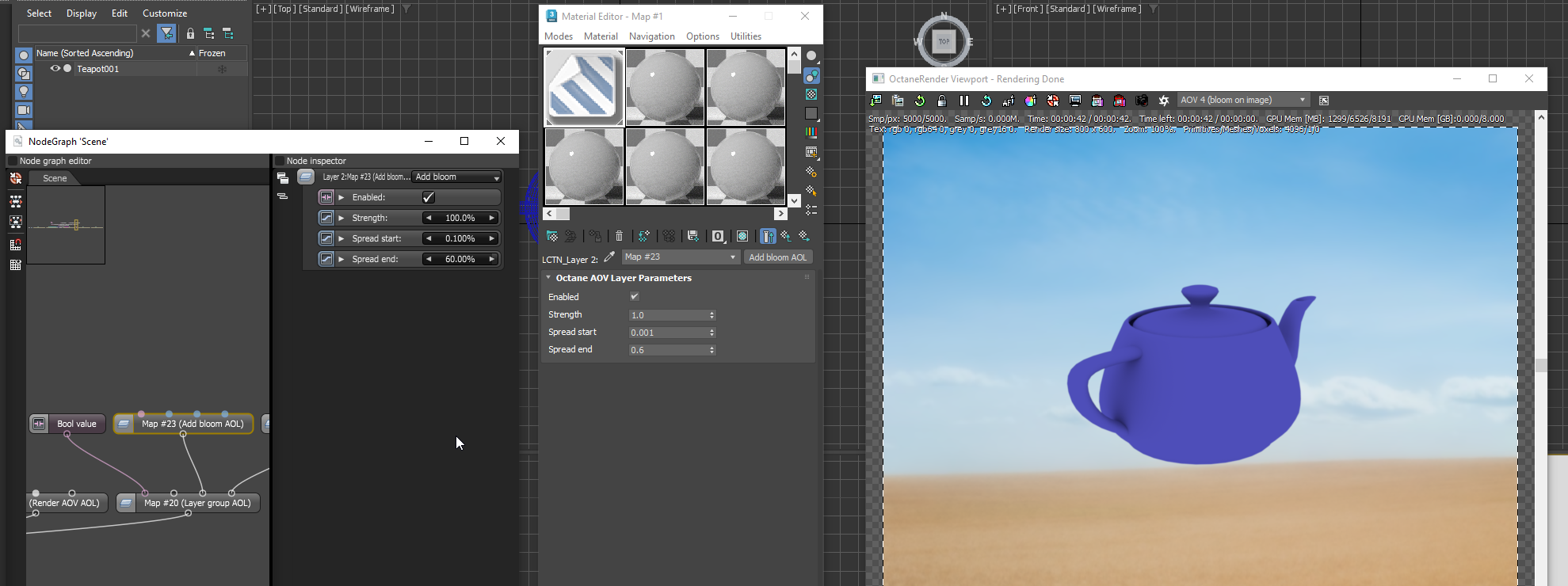

The AOV bloom parameters seems to work, but the values of Spread start need to be very low, and are not easy to edit with 3dsMax default values settings (digit / precision settings..)
I'll try to add an internal multiplier to make it easier to edit..
You can try with the Octane Node Graph window, to move sliders and get an idea of the good values.. :

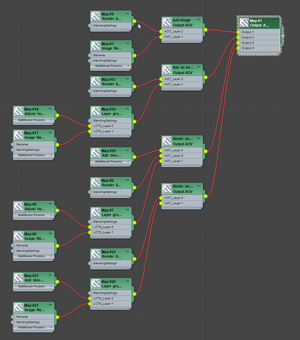

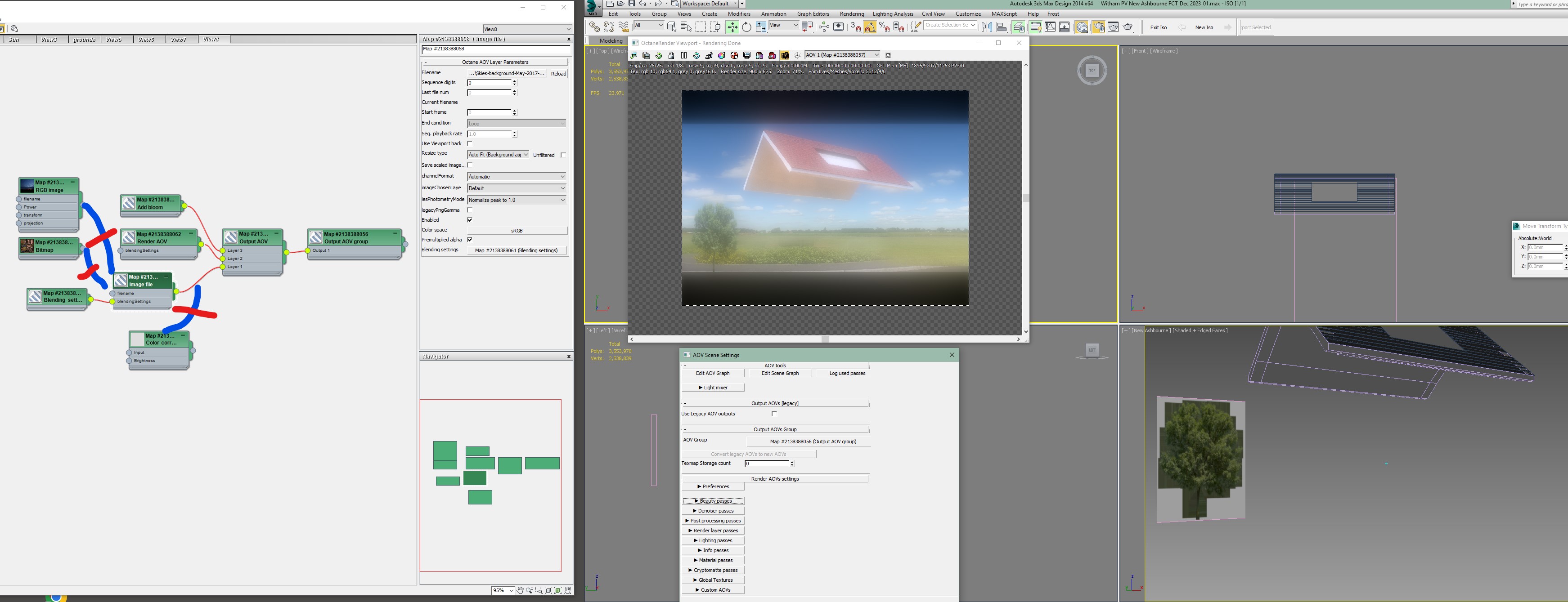

For effects on AOV image, here are some screenshots and samples (sorry, for max 2021+):
AOV_Image_effects.zip
(251.39 KiB) Downloaded 163 times
aov_img_fx02_mx21.max is for current version 2023
O24_aov_img_fx2402_mx20.max is for alpha version 2024, and uses the new AOV blend texture.

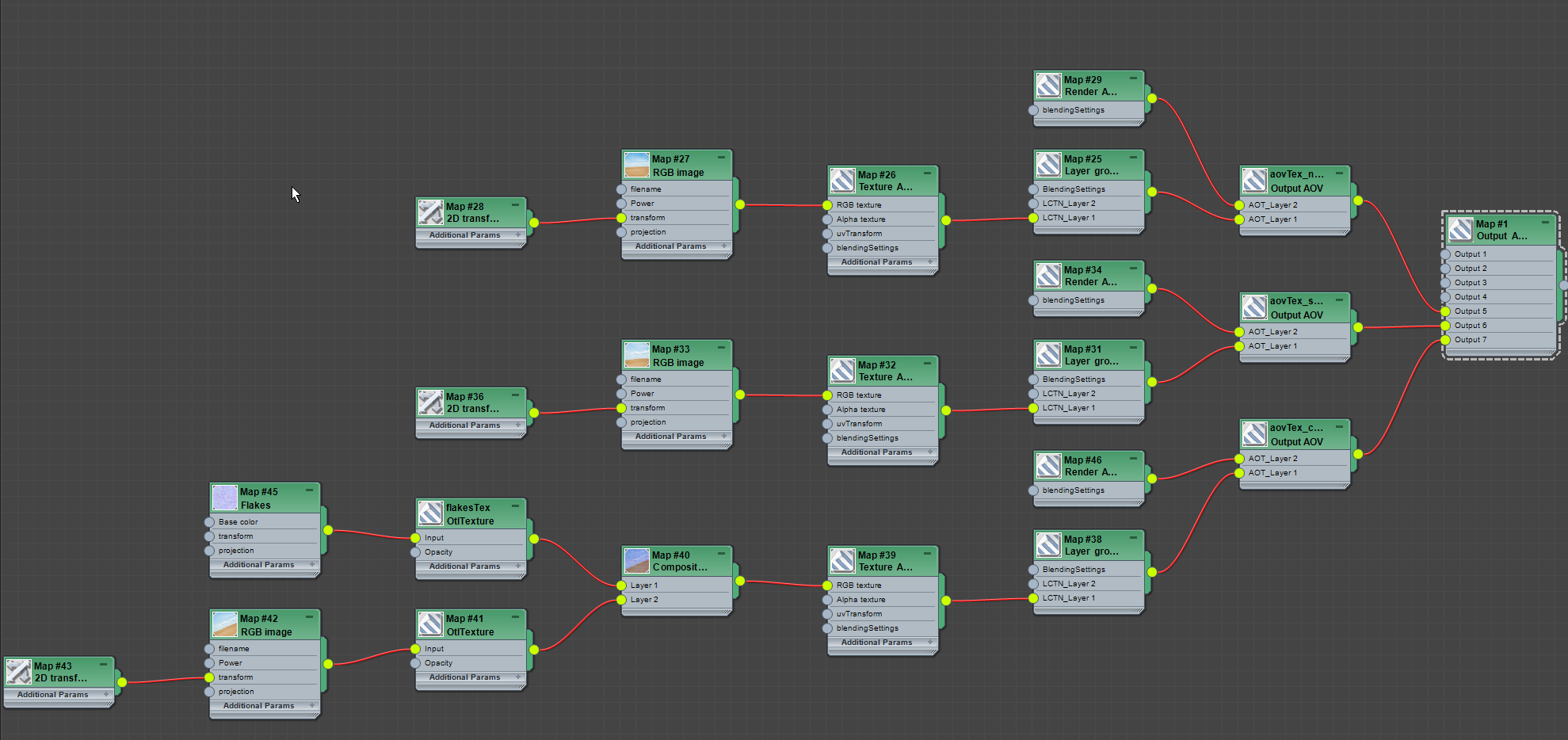

Here is the graph for version 2024 / Aov textures:
I hope that helps
