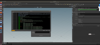

While I was able to submit to the farm again, this build exhibits the issue of working in a GUI and not in batch mode (on the farm) which I believe we saw in a previous Linux build/s
Screenshot showing this strange situation.
Reverting back down to 2023.1.0 as no time to Beta test while delivering.
Houdini 19.5.773

As far as I can tell from your screenshot, the problem here is OctaneRender plugin isn't loaded when running hython.
There should be some octane logs when you run hython, here is an example of running hython on linux:

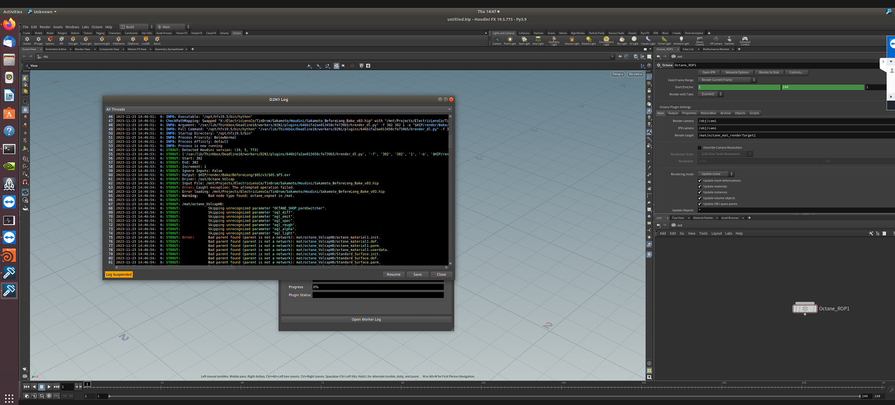

And here is a screenshot of the worker logs with octane properly initialized:
Here you can see that octane is initialized before "Detected Houdini Version:" message. In your screenshot there is no errors before this line, which means octane didn't fail to initialize but rather wasn't found in the path so no loading was triggered.
Could you please make sure octane plugin is initialized successfully when you run hython? It may be related to paths in the environment.
To be clear: running this command on your linux worker machines (not only the machine that's submitting work) should output octane plugin initialization logs:

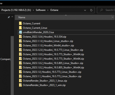

Yes, that's the case. Hython isn't picking up the plugin reliably even after a System reboot however swapping back to the older plugin has them working perfectly.
The way we have Octane setup is to use a 'current version' folder on the network which allows me to swap in/out versions as they release; so the system is always LIVE and either works or doesn't.
Not sure why your Hython likes this and mine reacts badly but it's part of the mystery I can't afford to diagnose right now. I'll sit back for a while, get this massive job delivered and see where things stand in a while.
