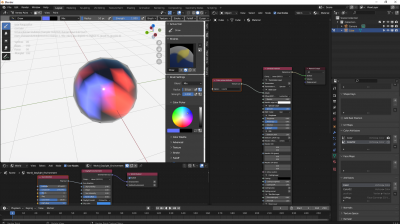

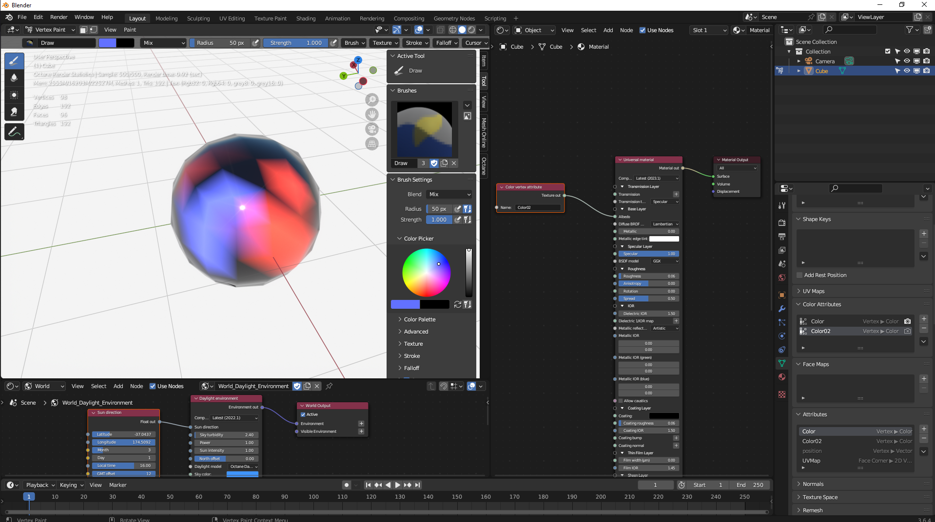

Hey Alexey, I noticed you're using the incorrect node.
The Grayscale Vertex Attribute node shown in your screenshot is linked to Vertex Groups, which explains why it's not showing in rendered view. While the Color Vertex Attribute node is used for Color Attributes.

Thanks for the tip. You're right if I use Color Vertex Attribute it works as expected.opstyix wrote:Hey Alexey, I noticed you're using the incorrect node.
When and how do we use Grayscale Vertex Attribute in Blender then?
