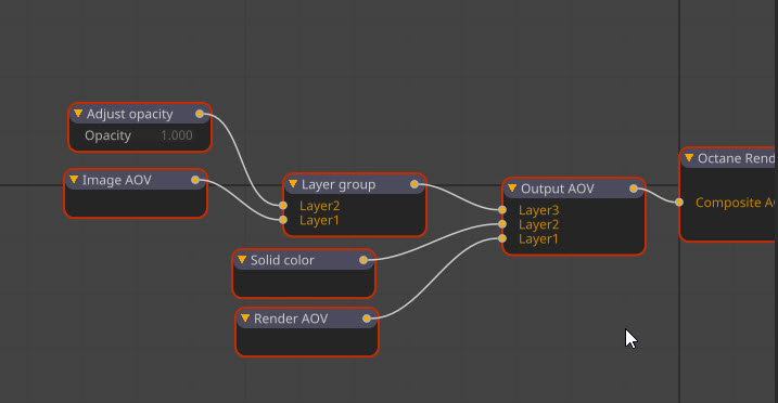

Re-work on output AOVs to use some new nodes. Dropped some old nodes by marking as deprecated.
Will the "Composite AOV Output Layer" node be removed in the future? is that node currently available for compatibility reasons?
Posts: 16068
Location: Türkiye
Yes, deprecated in Core side. Nodes with legacy text they will be removed.

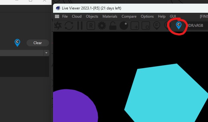

There is no way to exit from selecting cryptomate mode other than click on other selecting modes like material or dof :

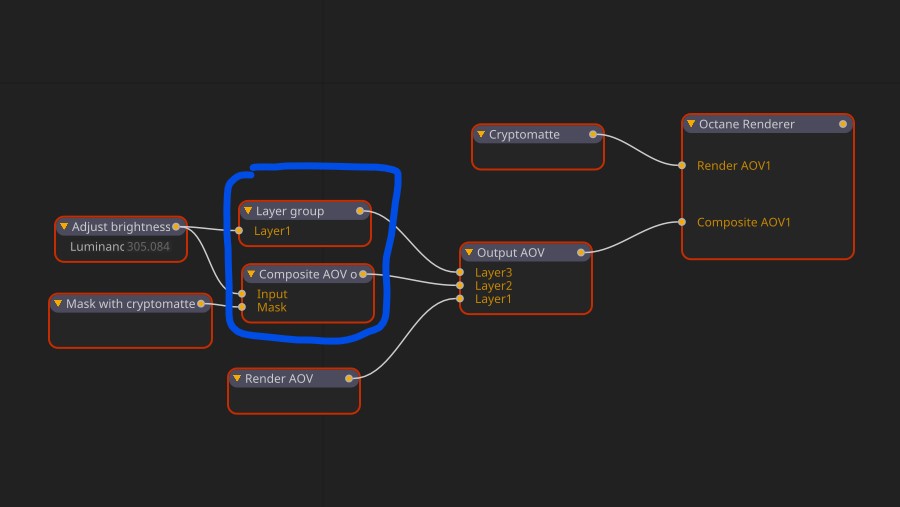

AOV nodes for mixing effects by masks doesn't work :

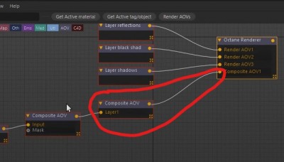

There is no way to connect comp aov like this ( it works in previous Octane versions ) :

SSmolak wrote:There is no way to exit from selecting cryptomate mode other than click on other selecting modes like material or dof :

1-If you see the notes composite AOV and some others (with legacy text) reprecated. Don't create/use deprecated nodes anymore.
2-If you click again to button then you'll be out from Cryptomatte mode.
